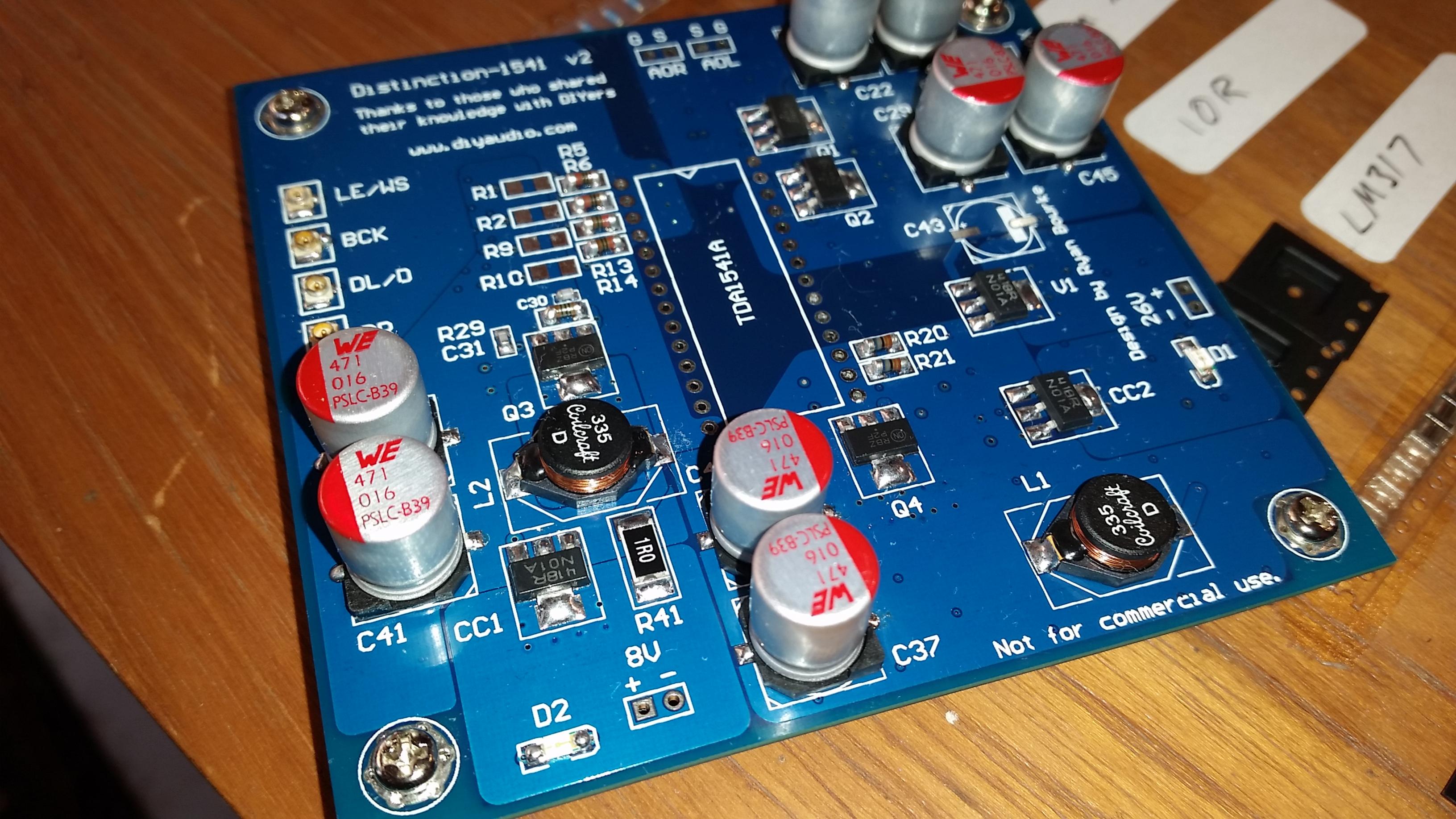

Despite my idea of the vertical ground separation around the pin 5 you copy from one of my post elswhere for trying to fix the Distinction v1, I still see at least one error in the pcb !...
look your shematic carrefully...
Hi Eldam,
Yes, in this design i've opted to separate the digital and analog ground planes. Where exactly have you spotted the error? Before I sent the gerbers off for fabrication there was actually a few violations that I fixed up before I sent them.
Ryan

You got me!
But there was a few things I changed before I sent the gerbers. For some reason the via stitching on the digital side went right through the striplines, I must have assigned them to the wrong net. You can see this on the pictures I posted on the previous page.

PCBs arrived last week, still waiting for a few parts to arrive. Wurth elektronik, and Coilcraft were kind enough to send me a few samples. PCB quality looks good from PCBway, although I might see if I can find another supplier that can provide 0.1mm between layer 1-2, 3-4 for increased effective capacitance. PCBway provided roughly ~0.17mm.

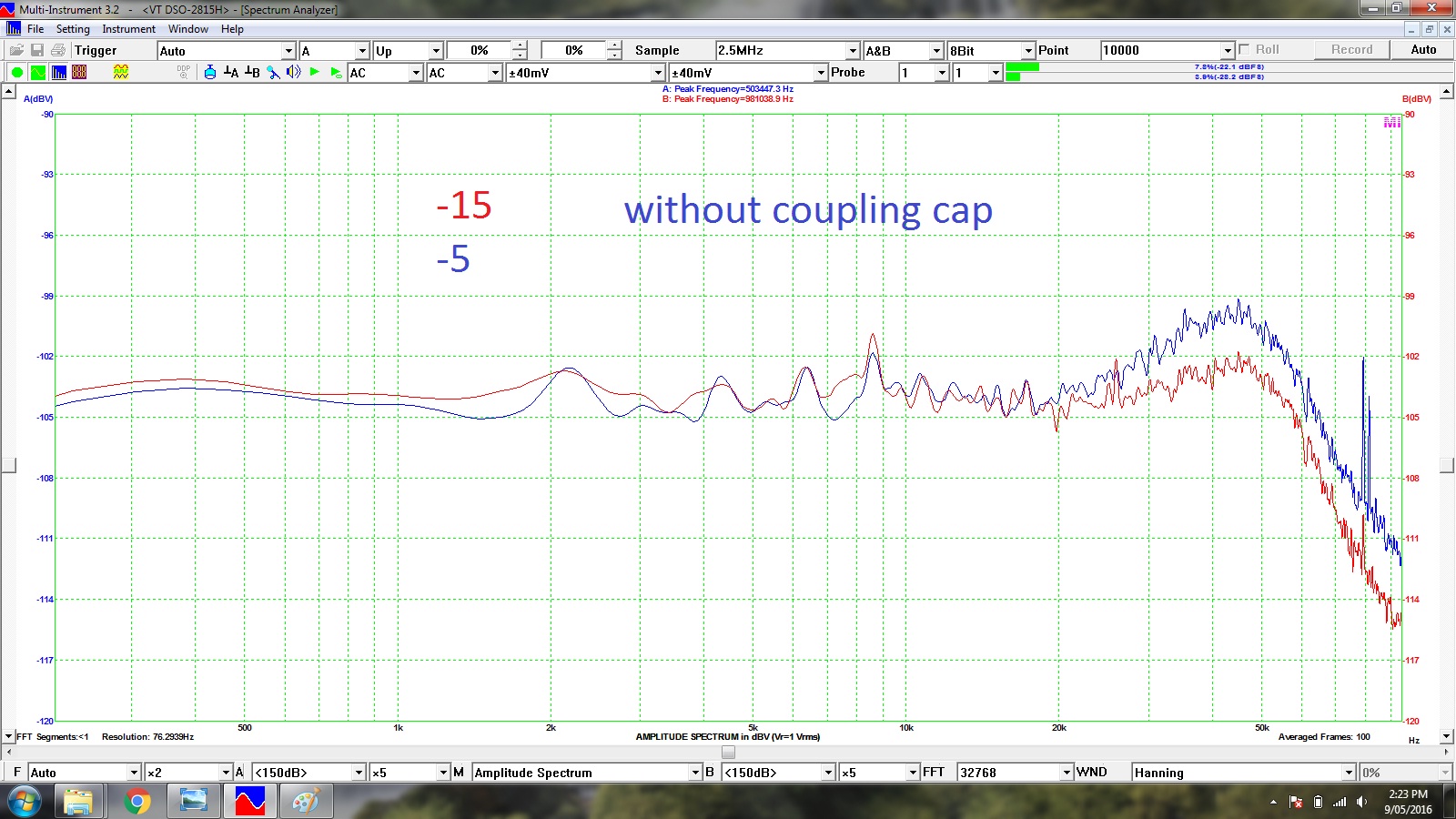

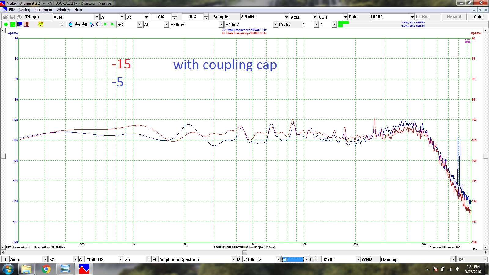

Attached are some noise measurements of -5V and -15V with and without a coupling cap between -5V and -15V.
Now that I have my FFT rig up and running again (VT DSO-2815H), I observed there was a hump at about 50k on the -5V supply. Once I coupled the two supplies together the hump was gone. Ill include this in the final design.
Ryan

Hi Luke,
Sorry I should have mentioned, yes this is under load from the 1541 while playing music.
Yes you're right, it may not have mattered because it is out of the audio band. But this noise may be a result of current demand from the 1541's internal circuitry. In my mind this voltage is forming because it wants to loop directly back to the -15/-5 supply, so providing a more direct path and a shorter loop is the way to go. In my unprofessional opinion of course.

I dont know why you ran two supplies of one rail, but if I did my math right, you got 35nV on the -5 v supply. I think that's pretty good if its real world as I recall Thorsten saying its a noisy ol chip and injects crap on the lines. Any idea what the output impedance of these regs is?
