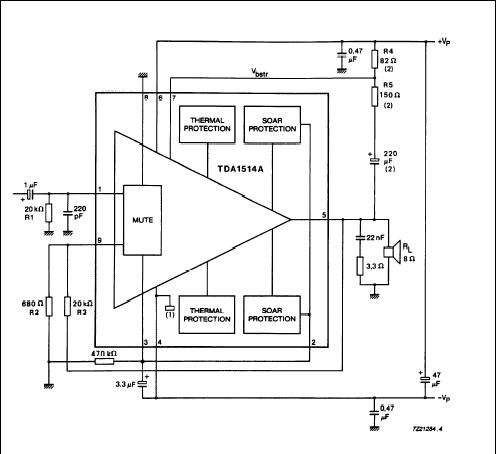

Hi all,
I'm building a active 2+1 system with 3xTDA1514A in next week. I will apply the Philips's original circuit which shown in TDA1514 datasheet. But i have a question and i cannot find an answer in that datasheet. I can see the mute/stby input is pin 3 and its referenced to pin4 (-Vcc). But in this figure pin 3 connected to pin 2 and pin 2 looks like the SOAR circuit's output (or something else). I want to add a stand-by and a mute switch to my circuit. What i'm gonna do? How can i add that switches?
Thanks a lot for any helps.

When connecting the power, pin 3 is at -Vp, then is charging through R 470K.
The circuit has 3 modes, depending of the U3, probably refering to -Vp:
U3 < 1V ==> stand-by
U3 = 2-4.5V ==> mute
U3 > 5V ==> run.
