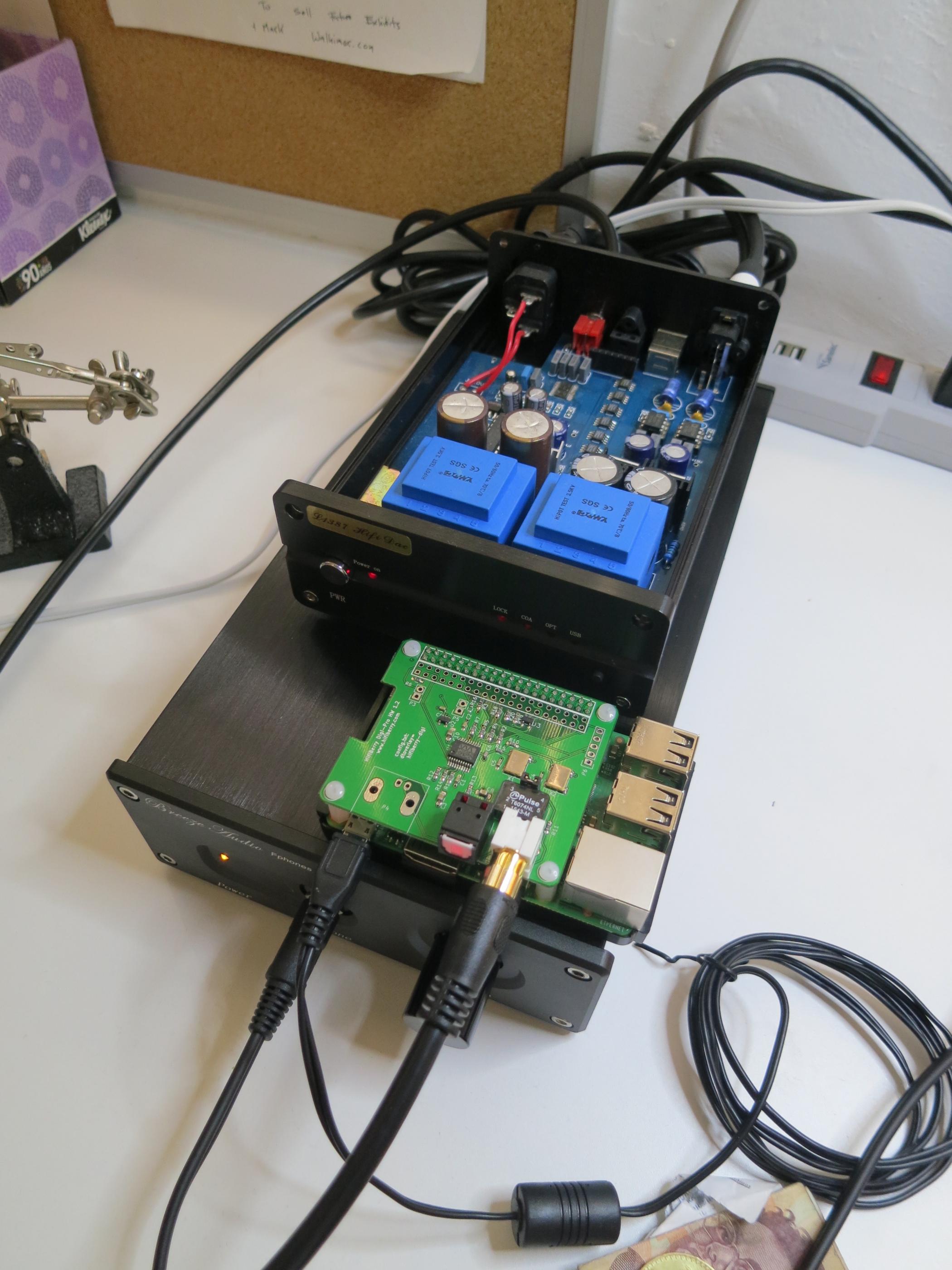

Thank you for your work on the TDA1387, really enjoying the DAC. Have you compared it to the 9018 or 9028 ? or TDA1541 ?
Have been doing some comparisons:
In order of Sound Quality
1. DT770 250 ohm > JLH 1969 Headphone Amp > TDA1387 x8 DAC > MacBook Pro. Sounds natural and easy, not the largest sound stage, not that largest range, great left / right separation, very musical.
2. DT770 250 ohm > JLH 1969 Headphone Amp > iFi Nano > MacBook Pro. More "digital" sounding, sharper
3. DT770 250 ohm > JLH 1969 Headphone Amp > HiFiBerry DAC+ Pro > Raspberry Pi. Sounds small, not rich, compressed and confused, all the information is there, but not musical.​
Also tried all of the above using the Sony MDR-7506, small soundstage, brittle sounding, too close

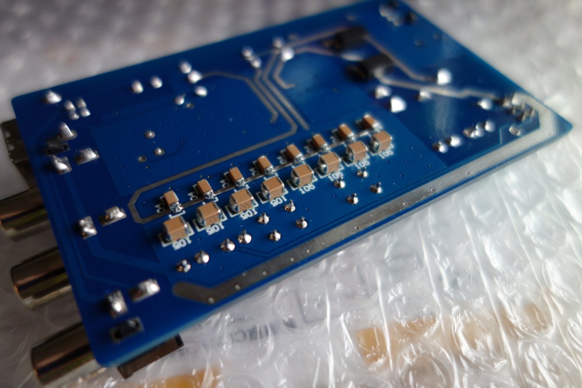

I just got one of the Taobao TDA1387 x8 DACs, and have been playing with it.
As stock, I was concerned about the big pops on switch on/off, and was hoping there was a neat way to fix that (without doing a full relay circuit).
I removed the stock opamps, replaced with AD845 and removed the 2N2 caps over the opamp output.
This made the pops much worse, and there's often quite noticeable opamp oscillation (in the 15kHz+ region, from a scope at switch on/off. The oscillation ends up in the 1-2MHz region, as the +15/-15V rails collapse.
Any ideas on what to tweak to help reduce the turn on/off pops?

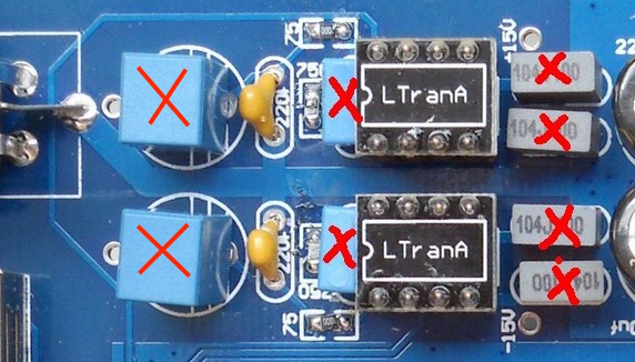

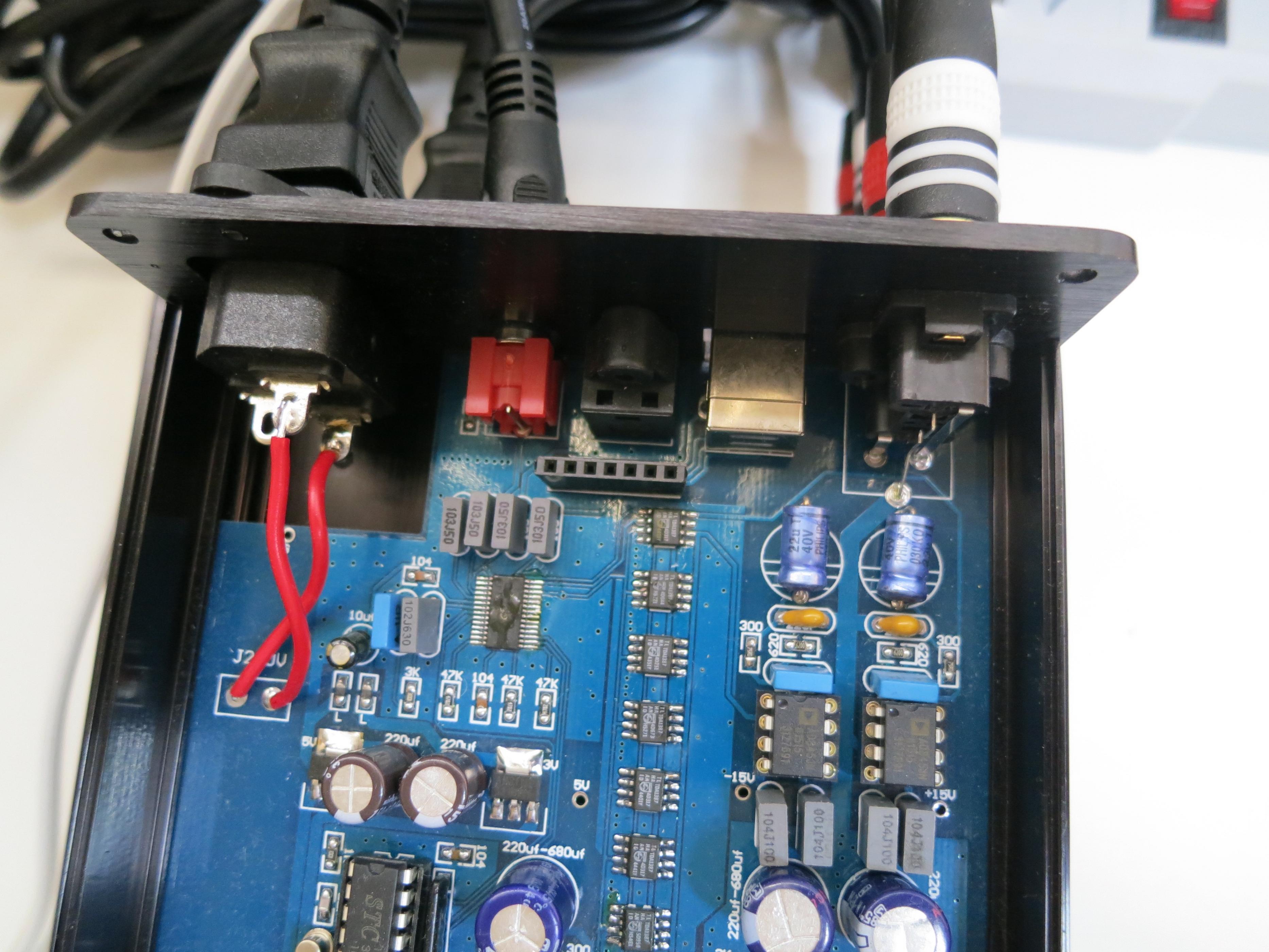

Removing 2n2 Opamp Feedback Capacitors
Dear Abraxalito,
Thank you for the guidance!
Enjoying the TDA1387. So far have replaced the NE5534 Op-amps with the AD845 op-amps.
Is removing the 2n2 Opamp Feedback Capacitors as simple as just cutting them out ? Do I need to do anything else besides removing them ?
Thank you !
Too Many Teeth Missing
Yes its that simple - just cut them out, or if you have no cutters, wiggle them back and forth like a loose tooth until they fall out.

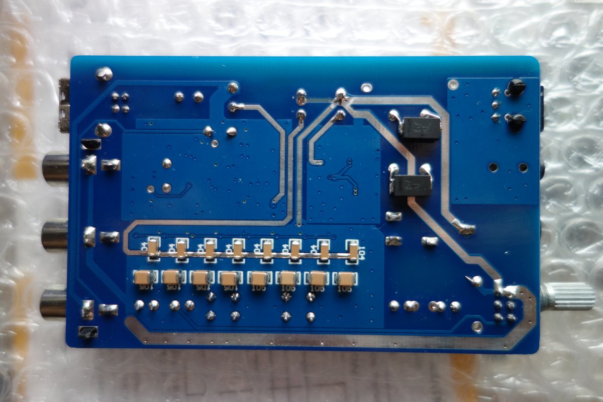

Dear abraxalito,
I am a fool.
I removed too many, see the photo, I also removed the two closest to the RCA plugs. What are those pieces ?
Thank you !
