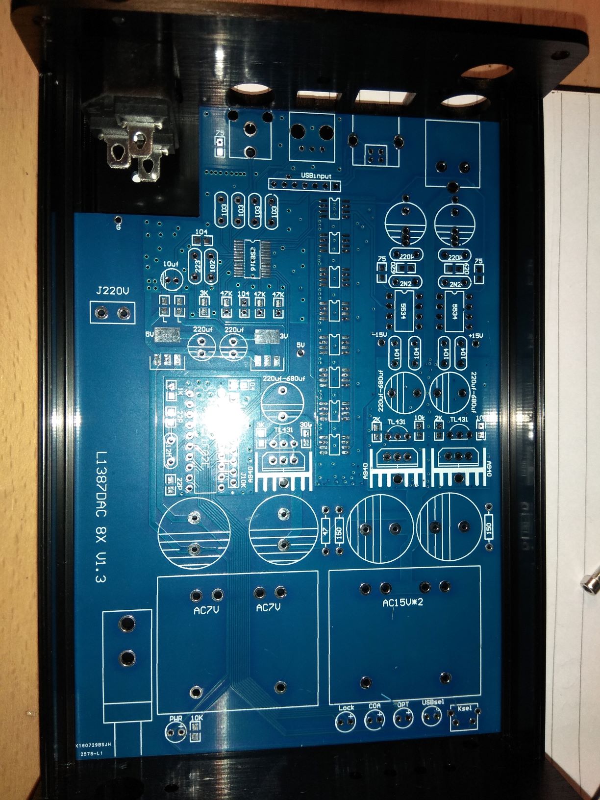

I realise I'm a bit late on this one, but my TDA1387 kit finally arrived from China via taoboa.
I notice the PCB revision is now 1.3. I can't see any obvious differences from the v1.1 board at the start of this thread, but I've attached a picture for anyone interested.
Planning to do the following initially:
1. Leave out 2n2 capacitors
2. Install additional pin 7 capacitors on the bottom of the board
3. Swap opamps for ad845
Anything else I should consider now that the board is completely empty?
Thanks,
geoff.

I'd give serious consideration to only populating one or two of the DAC chips - I can't see that there's really any advantage in paralleling 8 1387s on the same power supply and it only makes the I/V opamp work that much harder to swing the full 8mA, rather than 1 or 2mA. If you go this route the I/V resistor needs increasing to maintain the same output voltage swing (2V) - for 1 DAC chip it should be 5k6, for 2 2k7.
Thanks abraxalito, I never would've considered installing less dac chips, but makes sense how you explain it. Does it matter which ones get populated?
Am I right in thinking the I/V resistor is the 75 ohm ones next to the opamps?
Thanks,
geoff.
From memory I think the I/V resistor is the one marked 620 (620ohms). At least that's the right value roughly. If you have an ohm-meter or continuity tester you could check that its wired between opamp pins 2 and 6 (oh and its also across the 2n2 which you're not going to fit).
No, I can't think of a reason there's any sensitivity to which DAC sites get chips.

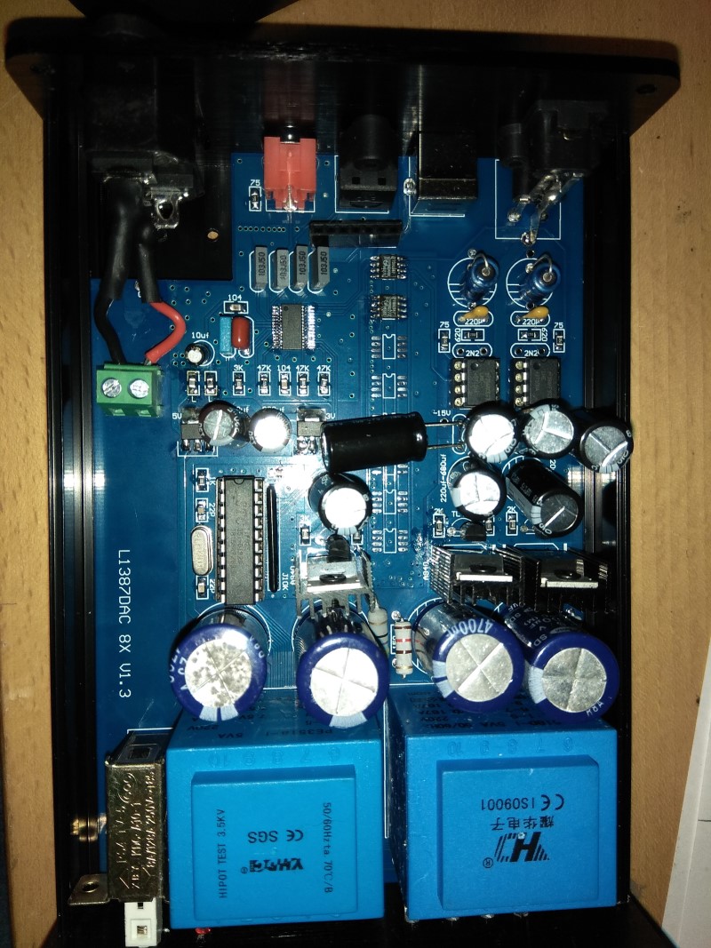

Ok, I've built the board up with 2 x tda1387 and a 2k7 output resistor as suggested by abraxalito.
The DAC appears to be working, I can select the different input, and locks onto spdif signal, but I get no sound output.
I've checked for soldering issues, nothing I can spot, also checked that opamps are getting +/- 15v, that all looks fine.
Quite possible I've misplaced a component or two, as they all just came in a big back with no schematic or labelling.
One question, what are the square output caps on other boards I've seen?
I didn't get those in my kit, so used the 22uf/40v 'Philips' caps. Are these roughly the right value?
Any suggestions much appreciated!

Fortuitously I happen to have another DIYer's DAC here for debugging/upgrading so I have fresh experience of what to look for.
You've checked the opamps so do check the DAC chips have the correct voltage (5V) on their supply pin (pin5, wrt GND which is pin4 - or use the shield of the output sockets).
Assuming that's correct the next step is to check the DC levels on the opamp outputs (pin 6) - relative to GND (the shield of the output sockets). Given the DAC chips are outputting current only from a positive supply the opamp's output should be negative wrt GND by about 3V.

Thanks abraxalito, the 5v line seems to be the issue. I get 5v at the 5v regulator, but not at the test point or dac chips pin 5 / pin 4)
I'm now wondering about the 2 SMD chips labelled 'L' above the 5v regulator?

When you say 5V reg do you mean the SOT-223 device next to the mains input terminals? If so that's not where the 5V for the DAC comes from, its a reg for the logic part.
The DAC chip power comes from the TL431 nearest to the microcontroller. Its assisted by the heatsunk transistor (2SA940) right behind it. That shunt config is fed through the 47R resistor buried between two sets of reservoir caps.
