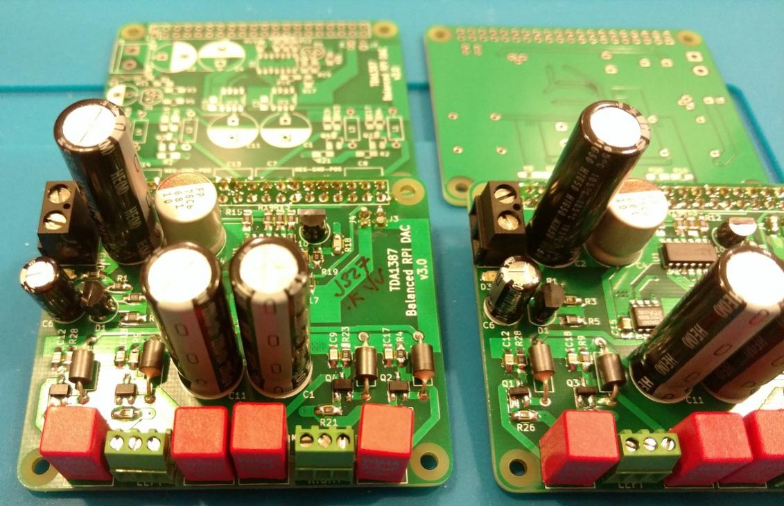

My balanced RPI HAT DAC boards were delivered last night. After the kiddos went to bed, I spent about 2.5 hours stuffing two of them. Not to toot my own horn, but I think this is my best SMD soldering job to date. I'm using the "poor man's reflow" technique, aka, a frying pan on the cooking range. I decided this process is like painting: the final result is dominated by the quality of the setup and preparation. Although, I haven't had a chance to test yet, if significant re-work is required, that will ruin my beautiful SMD job. But at least for now, I can bask in their aesthetic glory!

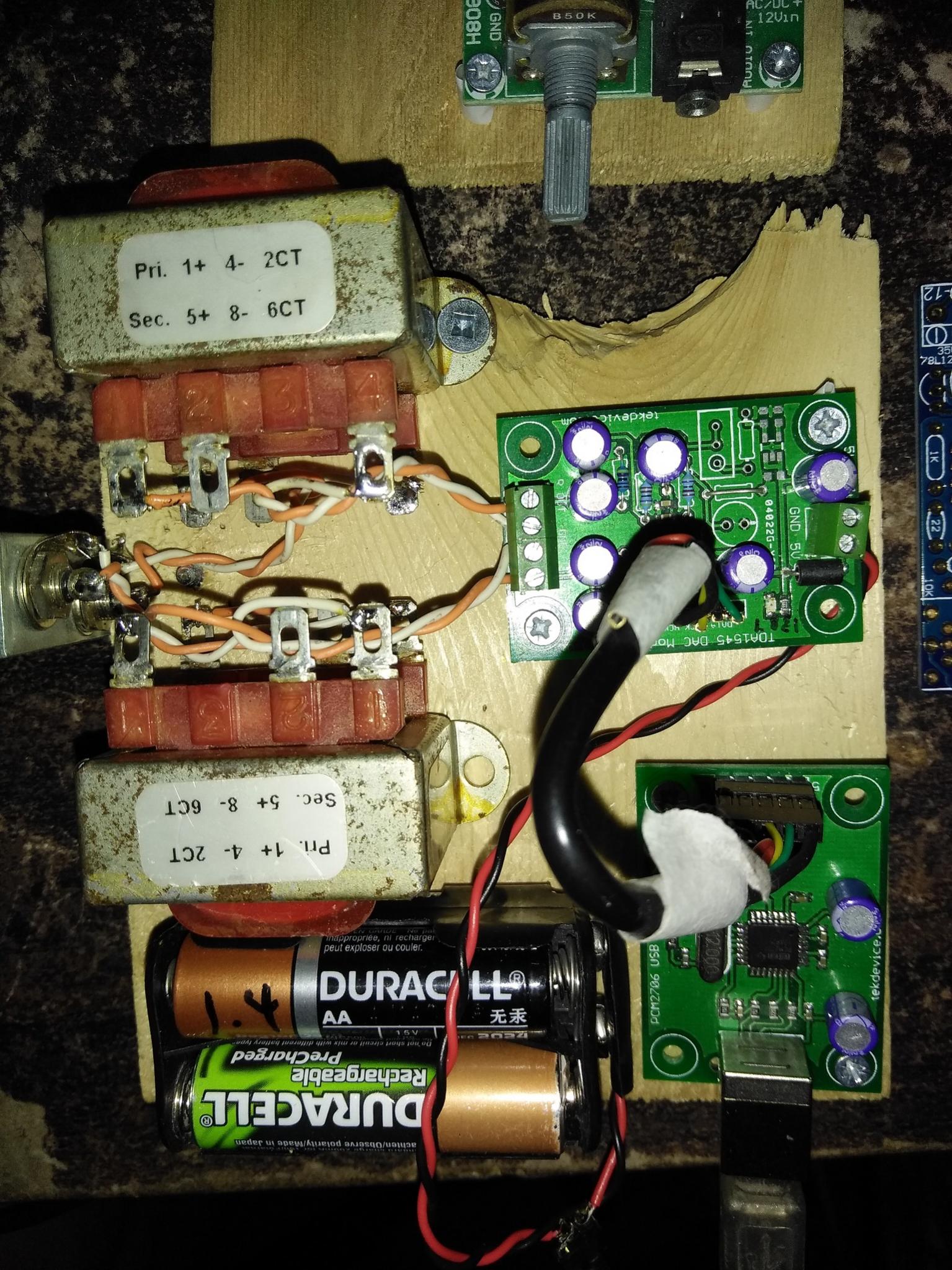

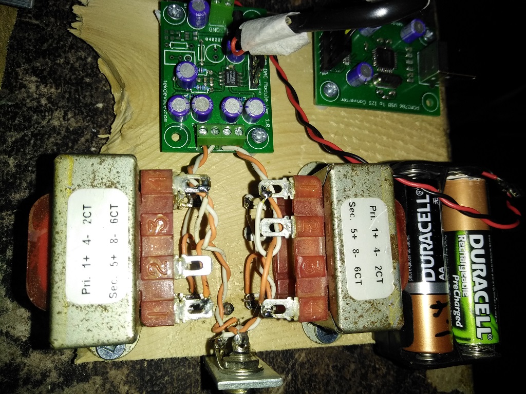

2706 USB Rx so not NOS
Skyhook I2S cable
TekDev (w batt pwr ~5.5V):
Res I/V 4.69k; back to back coupling cap 22u, 20V; shunt res 160ohm; output (shunt res after output caps so Rout ~ 160ohm)
11.6k, 22u 20V, .1u all in parallel to gnd from Vref.
old, tarnished, cheap Edcor WSM 10k 10k trans out (distortion is high but still sounds ok)
Wattage 0.5W; Input Maximum Voltage 10Vrms; Turns Ratio/Primary (input) Impedance/Secondary (output) Impedance: depends on model; Frequency Response 20~20K Hz., <1dBu; THD+Noise <0.05% @ 1K Hz; Insertion Los 0.5 dB
View attachment WSM10K-10K.pdf
Even though there's some issues and lowish output (guessing ~ 1Vrms), sounds nice!
I'm not noticing a bass roll off from the filt of L of the trans and the Riv when I short the trans out of circuit. I guess the shunt res 160ohm is the R in the R L filter so less bass roll off (and I'll get out my LC meter and measure the trans L).
It's not NOS so the trans is helping to filter the higher images/aliases and providing isolation.
Mods: res i/v too high - use 3.5k; single silmic2 10u, 35V coupling cap; play with Vcc caps; play with shunt res; play with Vref cap (I've got an old Panny HFQ 15,000uf, 6.3V around here somewhere!) and res; add parallel cap to Riv for hf filt; add 20k res on trans output so trans sees ~15-10k output, add rc filt on trans output, ...; batt power to USB - cut USB cable Vcc traces ...
Fun!
Jeff

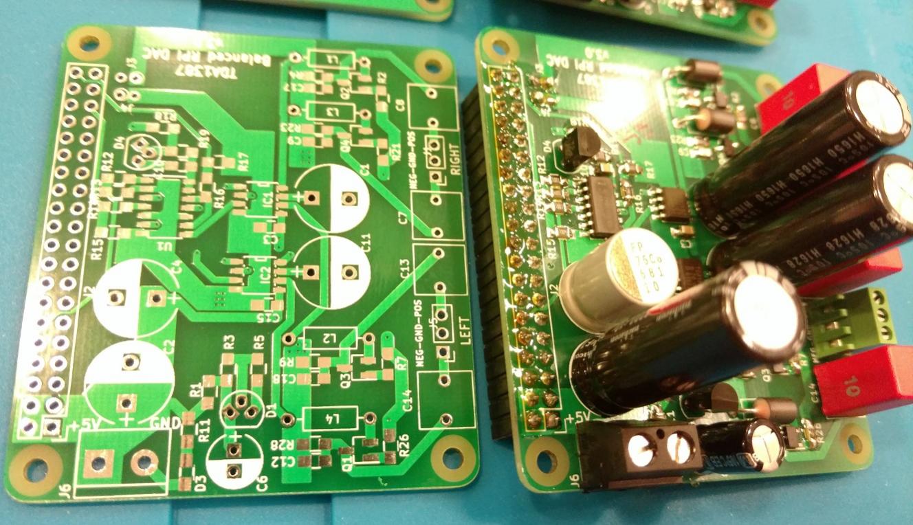

Those look amazingly professional Matt - way to go!
And do I see there J327s used as I/V on one board against BC807s on another? So you're in a position to compare MOSFET vs Bipolar for I/V transistors
How big are those pin7 'lytics? They look enormous!

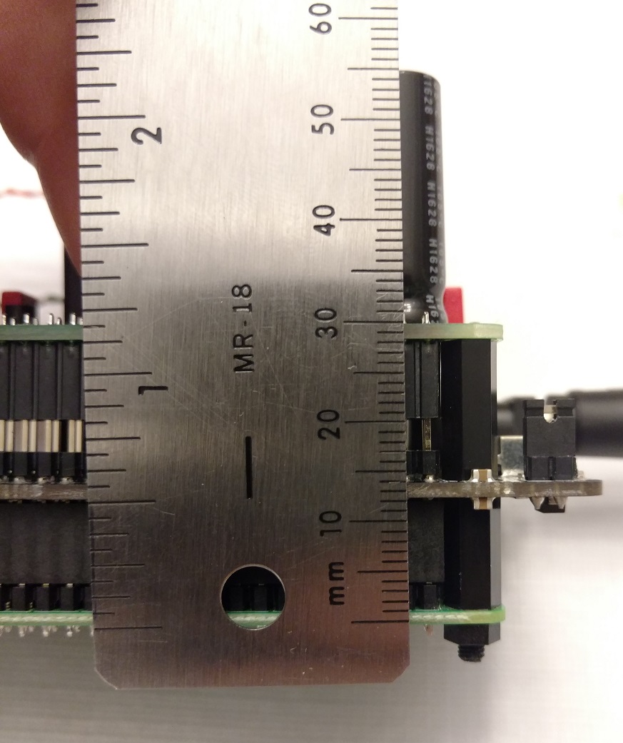

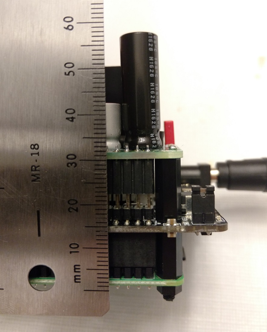

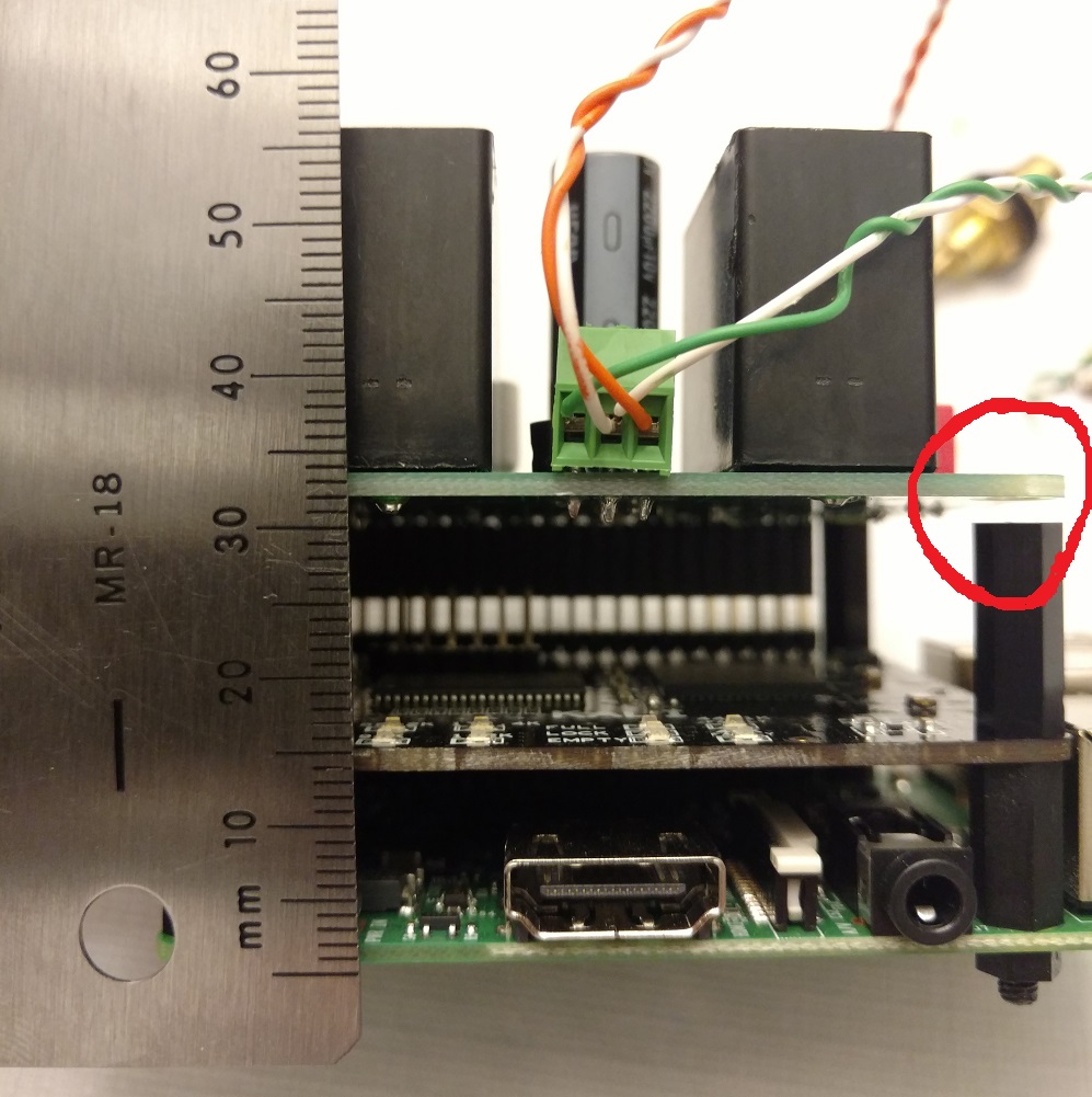

Wondering how tall the stack is with a pi, kali and DAC?
See attached pics. Looks like board to board height is right at 30mm. For total height, the picture is a bit misleading (lens curvature effect); those electrolytics are 31.5mm tall, so bottom board to top of the tallest cap is 61.5mm. Note that is without any bottom standoffs, which you'll want to add. I'd look for an enclosure that gives you at least 70mm of height.
Also note, the top PCB isn't screwed down, so the board to board height looks a little taller when measured from the front (I circled the gap in red).
Thanks! Unfortunately, that's all they are good for right now: looks. I powered them up last night, no sound at all. What's disconcerting is that the power-on LED doesn't even light up - I can't even get it to light up with my DMM (thinking maybe I soldered it own backwards). But I am getting power. I'm a little worried I left boards on the skillet too long. Anyway, I didn't have any time for debugging, hopefully it's something trivial!
Yes sir, that is the plan!
They are 10v/2200uF. Nichicon UHE1A222MPD. 10mm diameter, 31.5mm height.

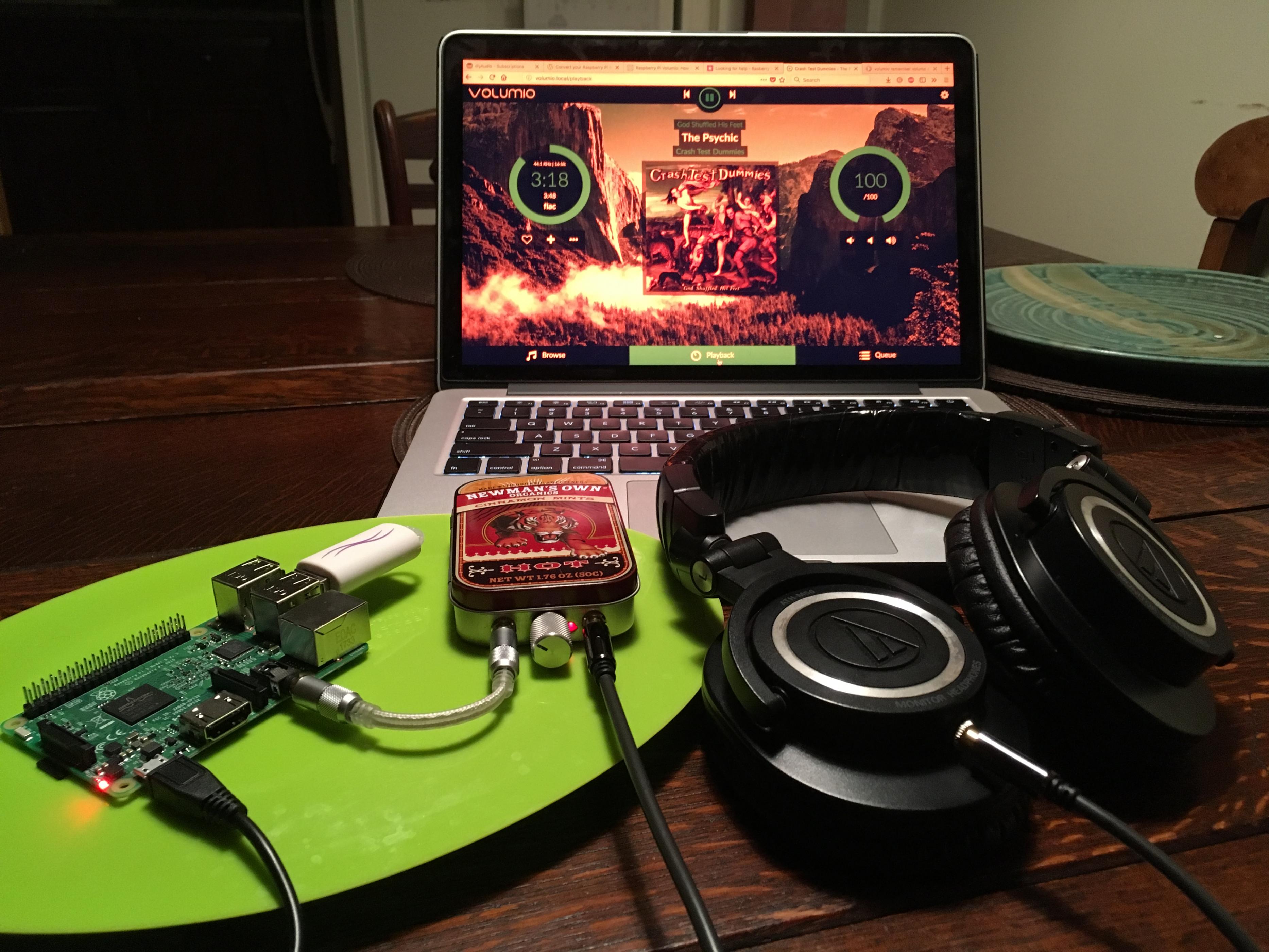

Well, after a little head-scratching, I'm set up for success. So far I like Volumio.
At first I was surprised that the onboard Pi DAC didn't sound quite as attrocious as I expected for a $30 computer. Then I discovered that with bass heavy tracks, it clips badly in the left channel with the digital volume set above 85%. Lol. Time for a Kali and a 1387 front end!
Snow day here in the mountains, so I get a free day to stay home and play with Volumio through the stock Pi.
Volumio has three options for volume control: Software, Hardware, and None. I believe the stock setting was Hardware. Today I changed it to None, since I have a pot in front of my Tripath amp, and curiously, the volume instantly dropped by 75% or more. Even stranger is the fact that now when I toggle through the three modes, they are all quiet now. I have tried rebooting the Pi in each mode, but they all remain super quiet with volume set to max. At least the clipping is gone now, but it seems like there is some type of glitch here. Or maybe the glitch was present from first boot and the gain was too high, and I solved it by resetting the volume prefs. But honestly it now seems waaay too quiet to be right.
Hopefully this is a hardware issue, not a Volumio problem, so that it won't have any effect whatsoever when I am using I2S. Can anybody confirm whether the output voltage of their Pi's built-in audio jack is insanely low? Also, what Volumio volume control option do you use in your setup?

I've never used the RPi's on-board sound, but I have a little experience with sound devices in Linux in general. I have experienced sound devices that behave similar to what you describe. That is, if the volume is turned up too much, there is obvious noise/distortion. I never really dug into this, but I made the assumption that the audio driver (or hardware) must have some kind of "boost" or "extra gain" functionality, which resulted in the "overdriven" sound.
I do everything from the commandline, so I don't know what controls Volumio exposes. But you can definitely learn more about the on-board sound chip's capabilities if you login via ssh to a command prompt. You'll have to familiarize yourself with ALSA, which was designed for everything except user-friendliness. But you can start with "aplay -L" and/or "aplay -l" (lower case el) to see a list of audio devices that Linux knows about.
What will be really interesting is if you use the text-based GUI program "alsamixer", which will show you all the tunables that the on-board sound chip exposes. I have a hunch that you should be able to go in there and tweak the onboard sound for maximum output, while staying below the obvious clipping you're hearing.
The only catch here is that Volumio may revert the changes you make from the commandline. I'm almost certain your manual changes will be lost after a reboot; not sure what will happen if you mess with things at runtime.
If you're comfortable with the commandline, I'd recommend using the DietPi distribution. It's by design a super lightweight/bare minimum SBC Linux distro. It's not targeted explicitly at RPI audio applications, but the audio-centric distros (such as Volumio) start with a stripped-down base OS (or at least they should).
