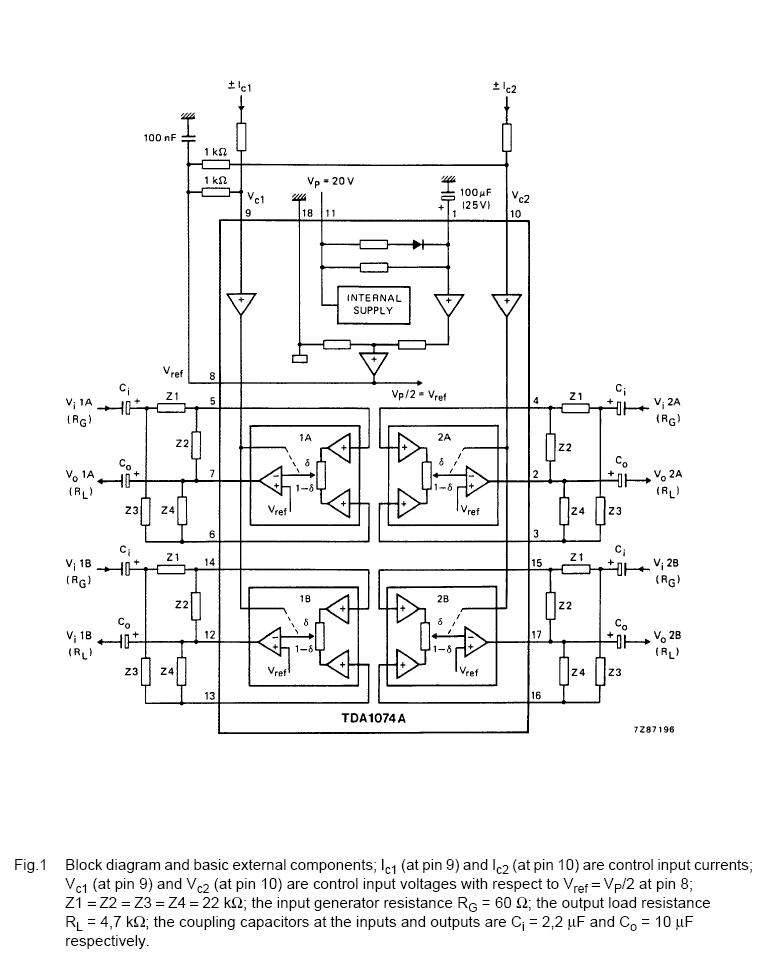

I wanna build a 4+1 with 6 x LM 1876. My gainclones are ready to install but I cannot find a quad tandem pot in Turkey. So I planned to use TDA1074A instead of quad pot.
Does anyone use TDA1074A in a volume control circuit? Or anyone has any information about TDA1074A applications?
