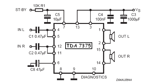

hi,
i finished making amp based on tda 7375 ic.can anyone help regarding pin no 7 in ic which is ST-by and about its connections etc?????

STAND-BY DRIVING (pin 7)
Some precautions have to be taken in the defini-
tion of stand-by driving networks: pin 7 cannot be
directly driven by a voltage source whose current
capability is higher than 5mA. In practical cases
a series resistance has always to be inserted,
having it the double purpose of limiting the cur-
rent at pin 7 and to smooth down the stand-by
ON/OFF transitions - in combination with a ca-
pacitor - for output pop prevention.
In any case, a capacitor of at least 100nF from
pin 7 to S-GND, with no resistance in between, is
necessary to ensure correct turn-on.
Check datasheet. So As you can see, the capacitor goes to ground and to st-by. it means that you have to add st-by pin to positive voltage rail.
Using 10K resistor of course
