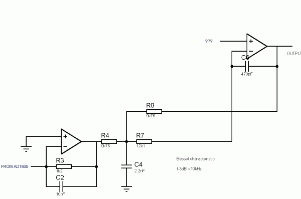

Funny thing is that I got the passive IV stage never working quite right. I did not get rid of the hum. I also noticed a lack of dynamics with passive conversion, also with the AD1865.
In the schematic below R3= 3k65, c2 = 3n3 and ???= ground. The non-inverting input of the first opamp is not connected to ground but to Vref of the TDA1543. First opamp= OPA604 and second opamp is the discrete buffer. Much to my surprise the OPA604 sounded better than the discrete buffer for IV. I tried almost all conceivable opamps in this position! All caps are 1% polypropylene Philips or BC Components and the resistors are Dale metalfim, yes the well-known brown coloured ones! I am extremely grateful to Audiofanatic letting me to try these resistors! The filter was calculated in a few seconds with Filterpro from Burr-Brown. The third order filter is of the multiple feedback variety and the first pole is in the IV converter. This way I could realise a third order filter with two opamps and an IV converter.

Hi Mad_K, Yes, the DAC is operating in a virtual ground.
Mad_K said:Interesting Elso, but is the value of the Vref to GND (3K3) resistor on the 1543 independent of the R3 (in your schematic) value?
I was planning to do as per 1543 datasheet, but with 3K3 to GND from Vref; is this correct? (+5VDD)
Well, I tried it and I must say that I LIKE IT ALOT
I used the opa2604 and 1K2/3n3 and 3K3 from Vref. I have about 2,1V on the output.

R and C in IV feedback
Curreently I am using 3k65 and a 3n3 cap as the R & C value.

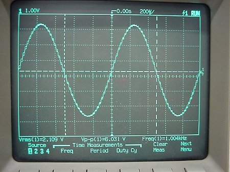

Only that -3 dB point at 10 kHz always hurts my eyes Elso.
Jean-Paul,
This hurts my eyes, and ears (1kHz, 0dB):
Despite the ugly looks I have heard DAC's with waveforms like that without remarking much negative ( sonically of course ). I did remark that my efforts of making it better resulted in a less good sounding but better measuring DAC ....
Maybe human ears have a built in integrator ?
jean-paul said:Despite the ugly looks I have heard DAC's with waveforms like that without remarking much negative ( sonically of course ). I did remark that my efforts of making it better resulted in a less good sounding but better measuring DAC ....
