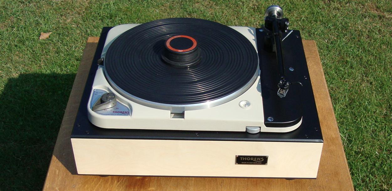

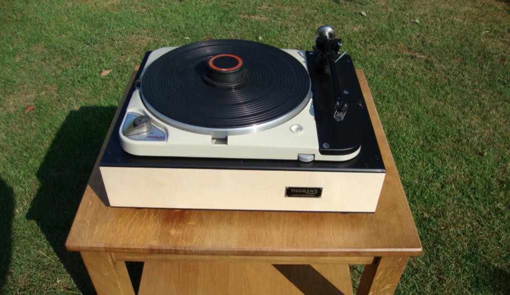

Here is a photo of a Thorens 124 plinth I made for a friend of mine about five years ago. It is made from Panzerholz, which has a very hign damping capacity compared to solid wood and regular plywood.
John
You have done a great job there john.
John
Looks like a very serious piece of kit!
Yes, it was built with another arm board at the rear to supplement the Thorens attachments. It's pretty solid. This plinth and another made for the Garrard 301 were the progenitors of a series of plinths I made for the SP-10 for Albert Porter.

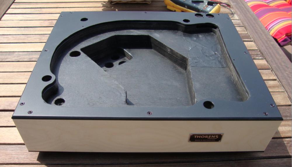

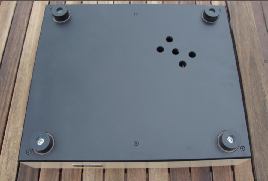

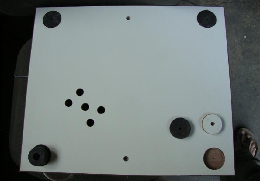

Hi
I a now listening to the TD-124 To tweak a bit. The paint job has to wait till the motor had a revision.
with the TT running and the coupling turned on we can lay the needle on the TT. The noise generated by vibration of the motor is now amplified. I can hear the noise is less when I lift the TT and hold it in my hands. So the solid rubber feet do not absorb enough.

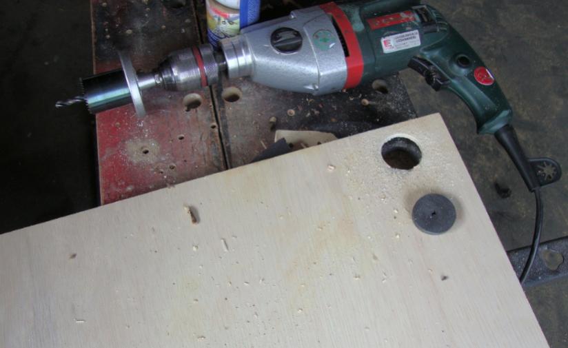

Ok I have a good idea to solve this.
I have soft rubber 7mm where seats of supersport bikes made off I call it moosgummi.
Wiht the rubber between two triplex plates i can use the holesaw to drill a nice round pice of 40mm. In the bottem plate of 6mm i drill the same hole.
after that I can screw the assebly to gether again.the rubberfeet loose on a screw so it has suspension. Works really great to absorb the minimum vibration left in the plinth.

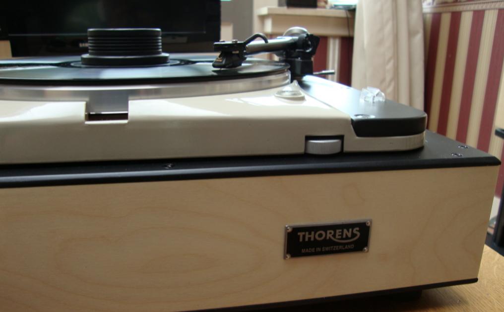

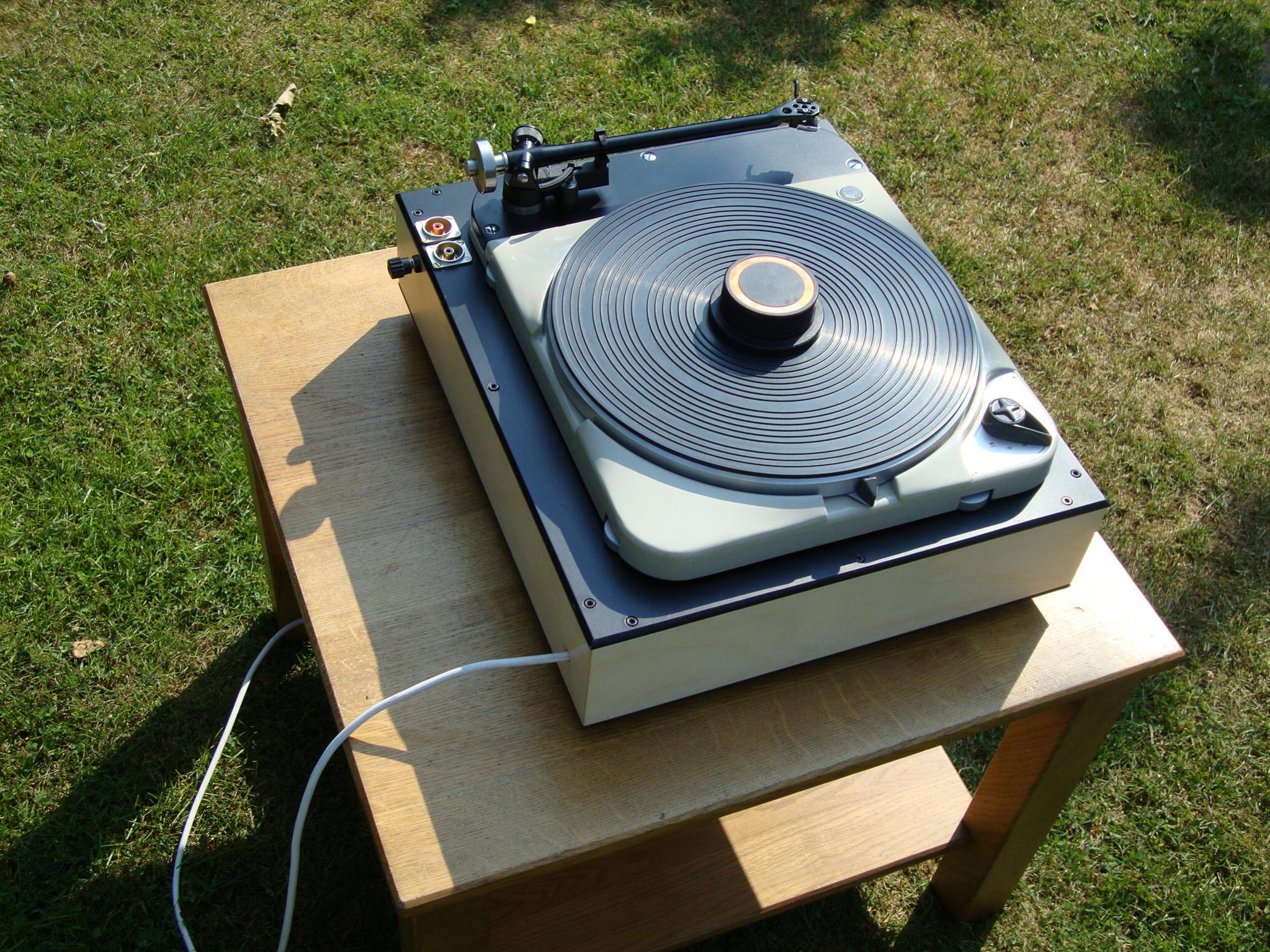

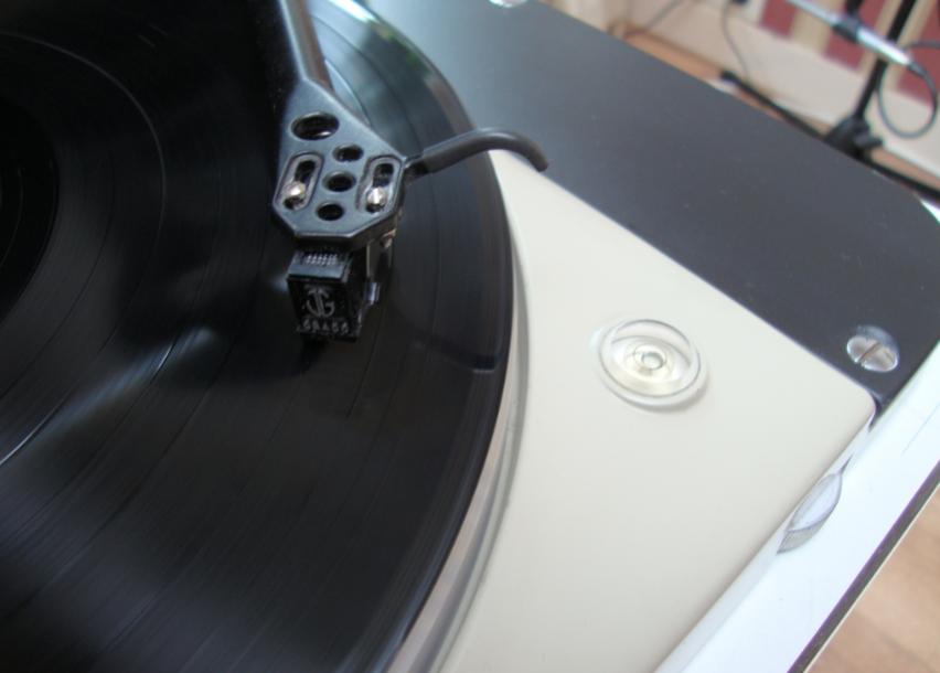

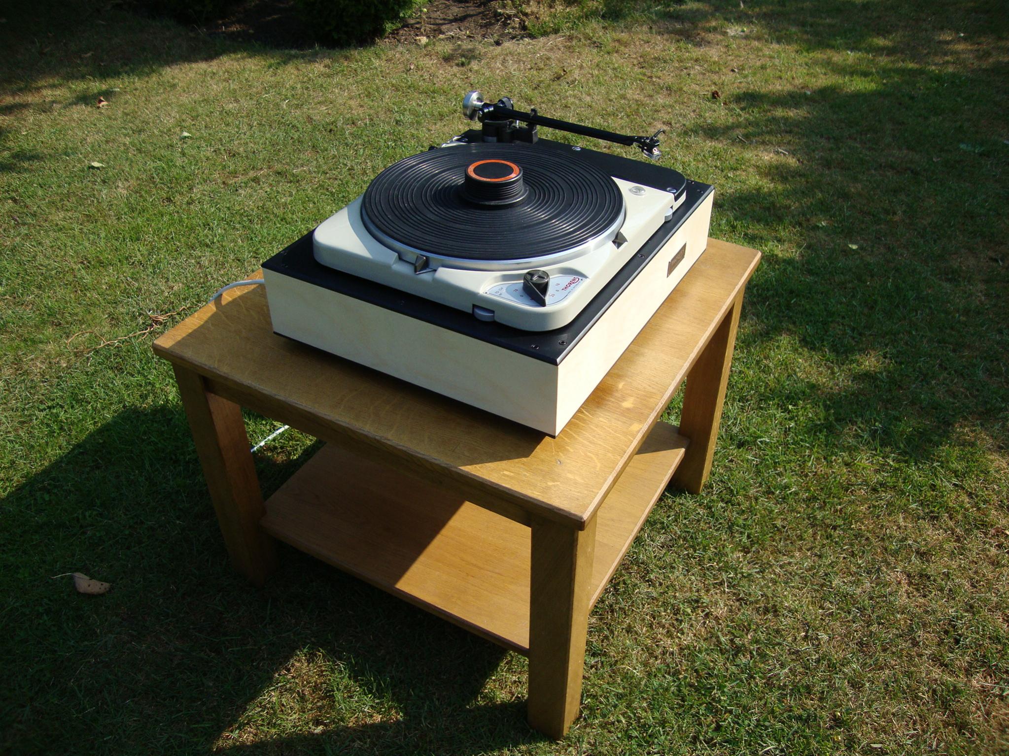

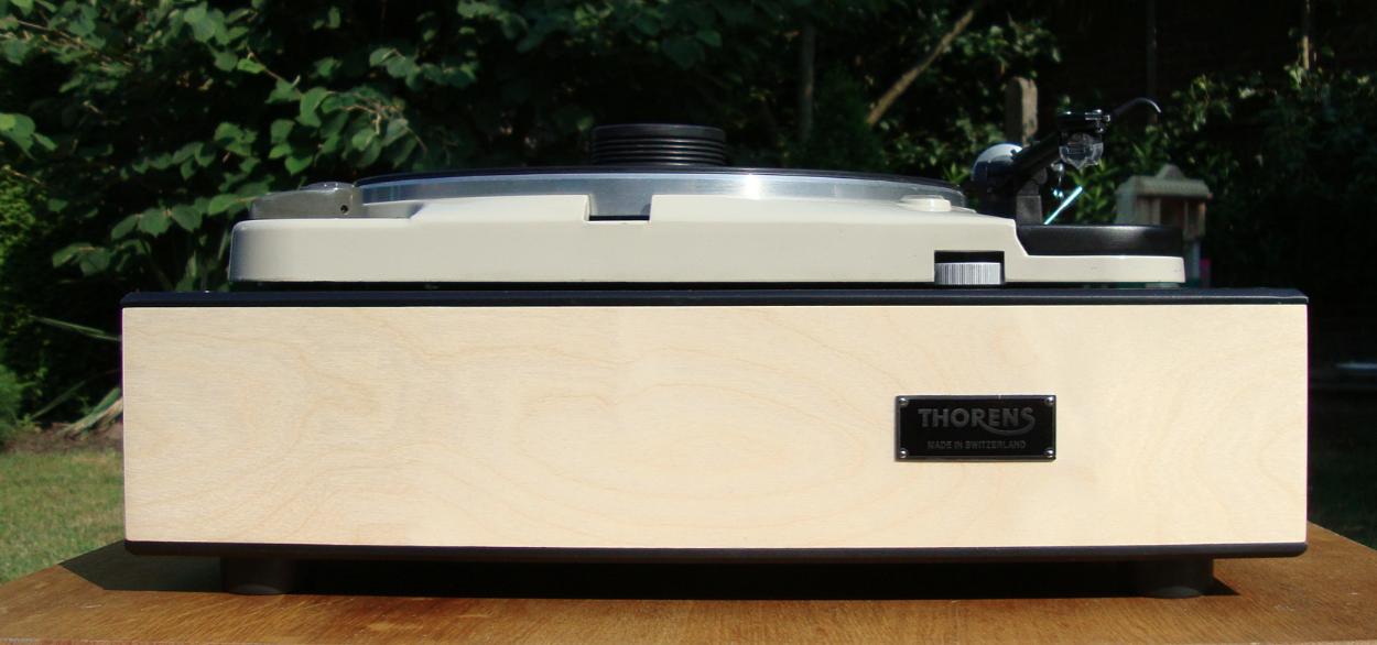

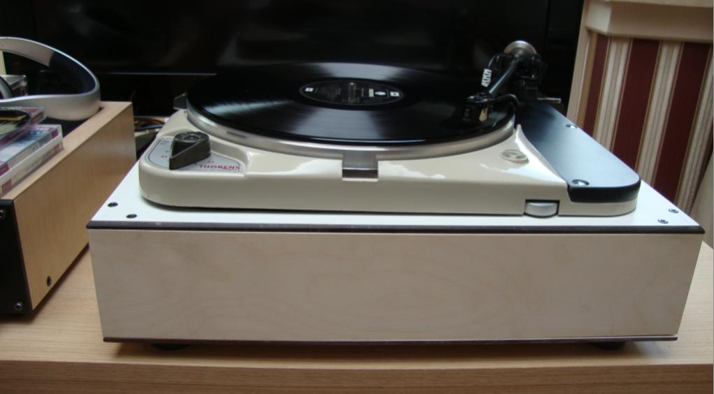

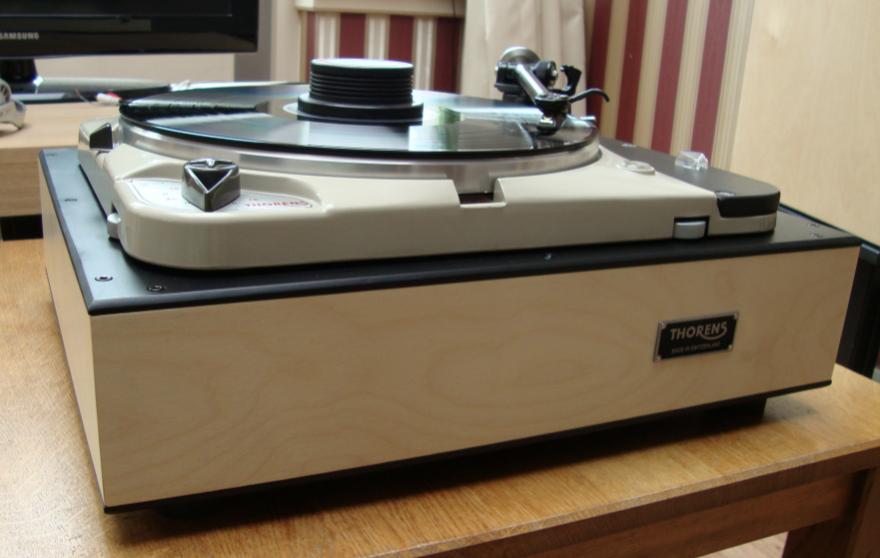

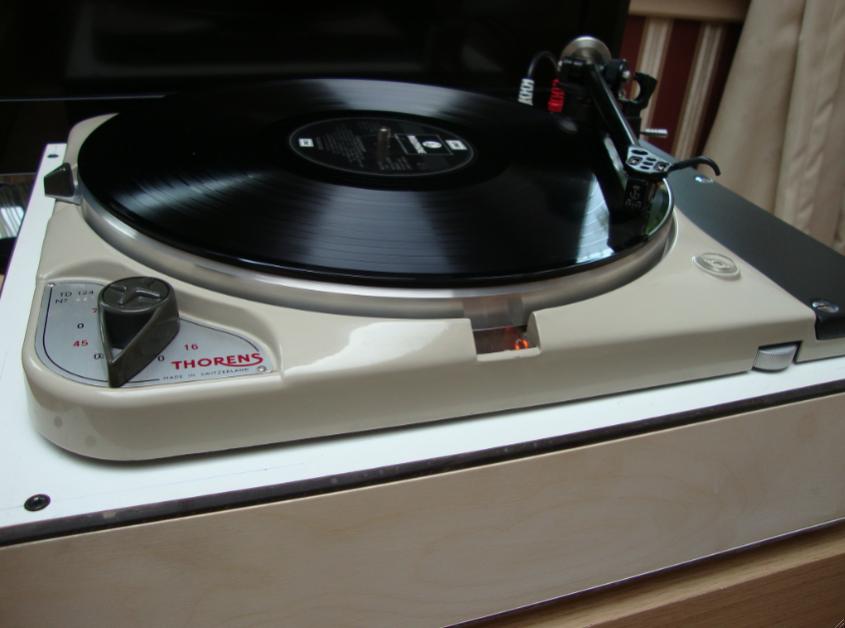

The unveiling.
What do think of the result.
The new dustcover. Made by GLORIOUS.
Badge Thorens inox.
Neutrik terminals.

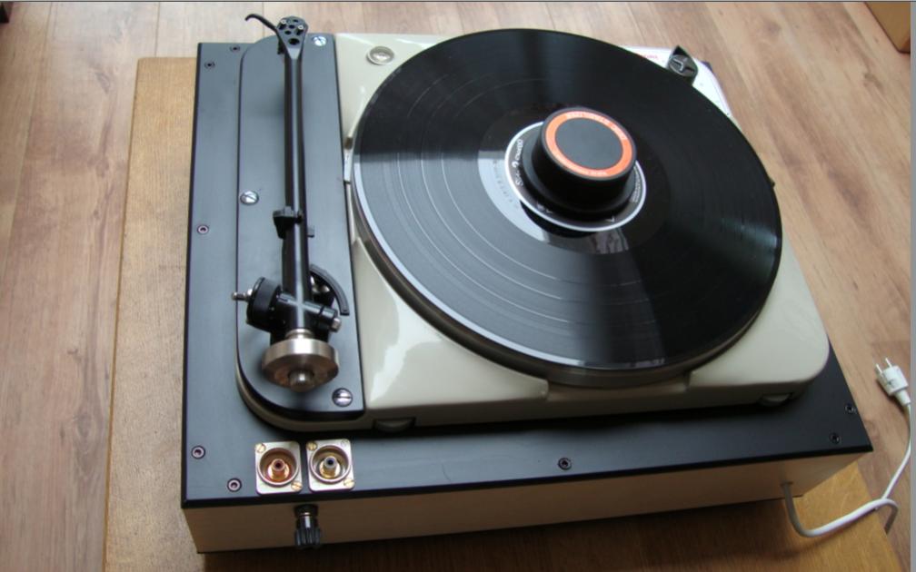

The classic Thorens TD124 MK1 Swiss made up to 1966.

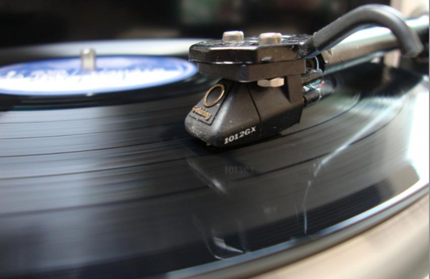

Goldring 1012GX fineline good bass and dynamics in the RB301 tonearm and Thorens TD124 MK1 turntable.
Van den Hul silver tone arm wiring. MCS-150M
Close up.
Badge Thorens inox.
Neutrik terminals.
Close up.

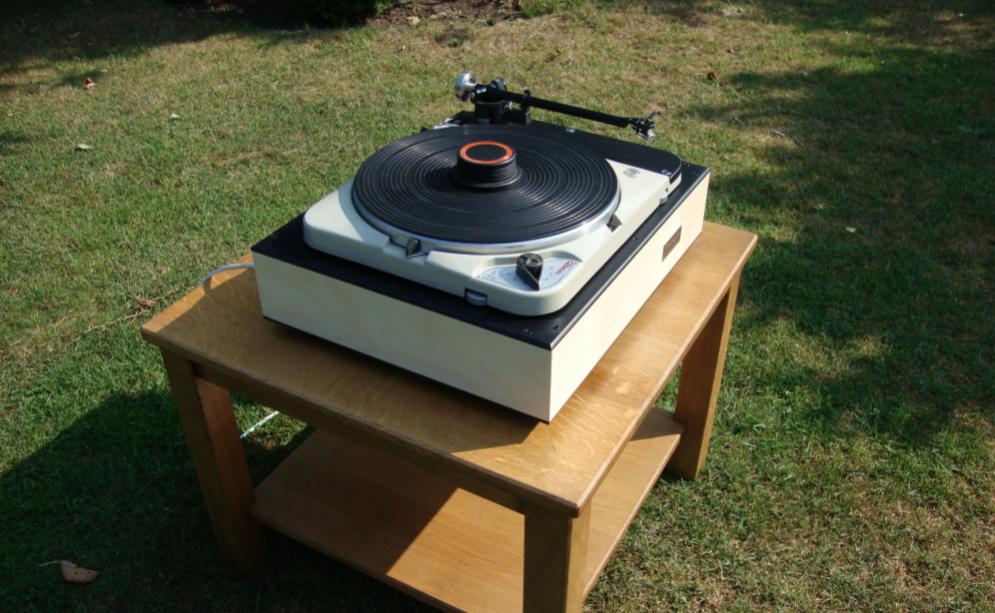

Just bin enjoying music that I got for free of my neighbors there where a lot of nice collector albums in the gift.
Works great the Goldring 1012 on the RB301.
I hope I can shoot better pictures of the turntable outside in daylight.

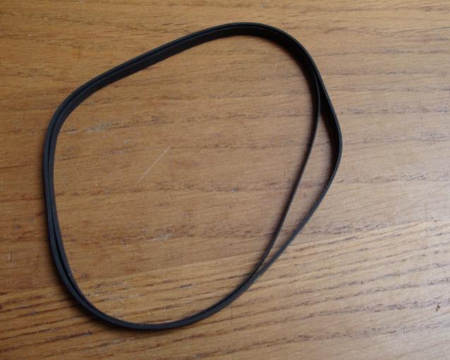

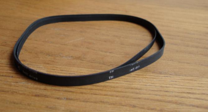

Thorens orignal belt

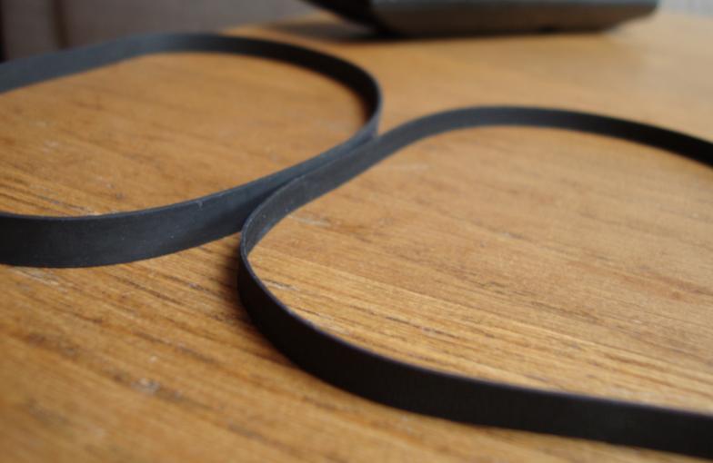

Hi
I did buy a new belt because the old one seemed a bit tight to me.
On the pictures we can see the differences.
The trapped pulley did sing when running with the small aftermarket one now with the higher original one it is much quitter.
The after market one will eventually damage the bearings of the motor where I payed more then 100Euro for. Because it is shorter it pulls the axes to one side and will wear the new bearings that way. So spend a other 25 on the belt.
