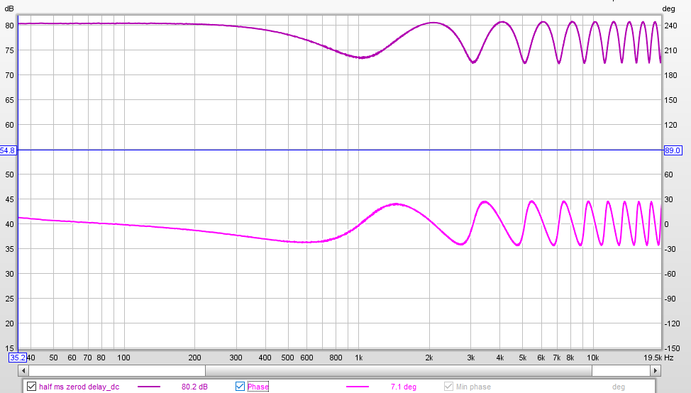

Half ms delay at -6dB (with some arbitrary EQ on the delay):
FIR correction could help me out here, recursively cancelling that extremely close reflection from the walls. Unfortunately, side wall and front wall reflections don't reach the listening position at the same time due to the geometry of the corner line arrays. They are pointing into the room at 45 degrees, but the listening position is 60 degrees out from the front corners (equilateral triangle). The plus side is that they are automatically toed in, which improves the stereo sweet spot as noted by Geddes etc. The downside is that the front wall reflection doesn't arrive at the same time as the side wall reflection, making it harder to correct with FIR. I will post a diagram in a minute.
The 0.5ms delay was less noticeable although it still added center weight, perceptually darkening the center since the comb filtering started higher up. Not as much "chorus" effect but still a blurred / smeared treble.
This latter effect of the 0.5ms delay actually made me think about my corner line arrays and why the treble sounds "off". It could be the reflection under 1ms from the corners. Absorbtion right at the corners may solve this.

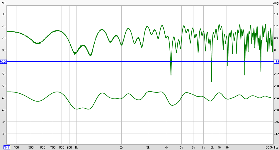

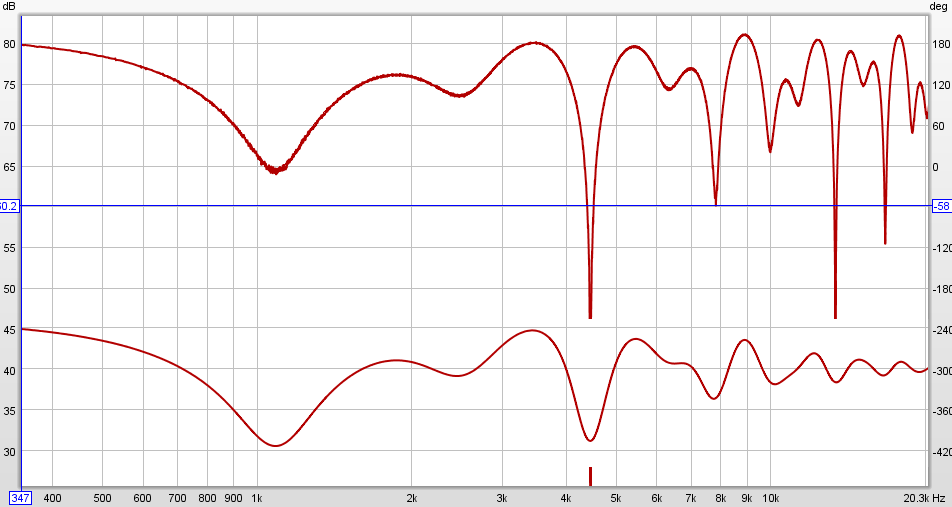

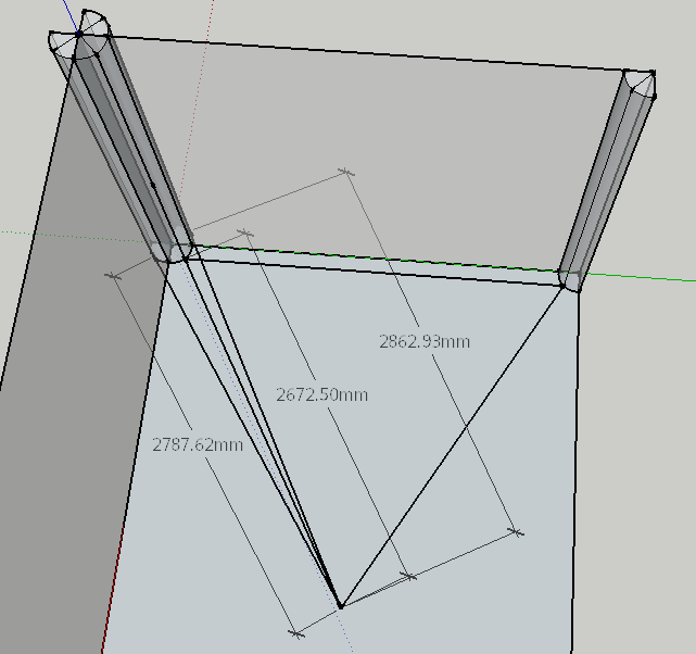

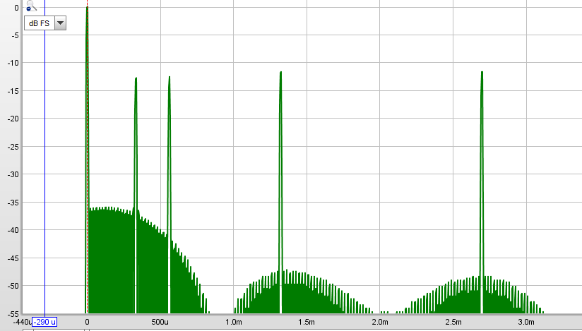

comb filtering model for (my) corner line arrays
Did a comb filtering model for my corner line arrays with sketchup, reaper, and REW. Looks pretty nasty really... delayed copies are set to the same volume as the direct sound, which isn't exactly right, but isn't far off either.
Inherent problem to corner line arrays I guess.
First reflections from the side and front walls are 0.3385 ms and 0.5596 ms respectively.
Modeled up to the 3rd reflection. I'm sure there is an easier way to do this... still using a combination of Sketchup, spreadsheet calculator, reaper, voxengo deconvolver and REW.
The sidewall reflection bouncing around off the front wall (2nd reflection) and back to the side wall (3rd reflection) smooths out the frequency response a bit but man thats a messy impulse response.
Let me know if there is some tool that will simulate this more easily!

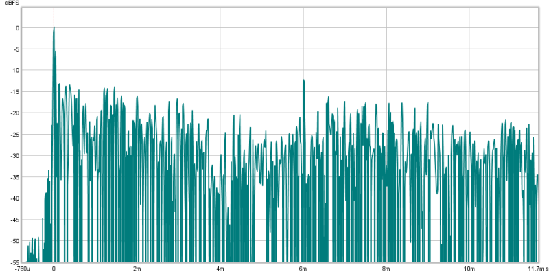

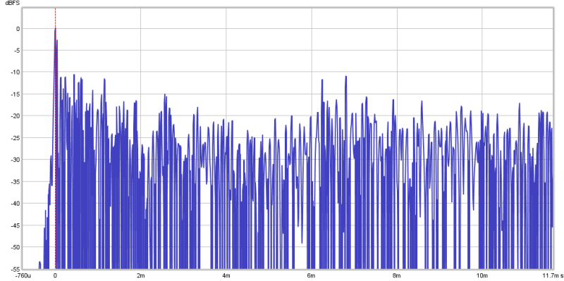

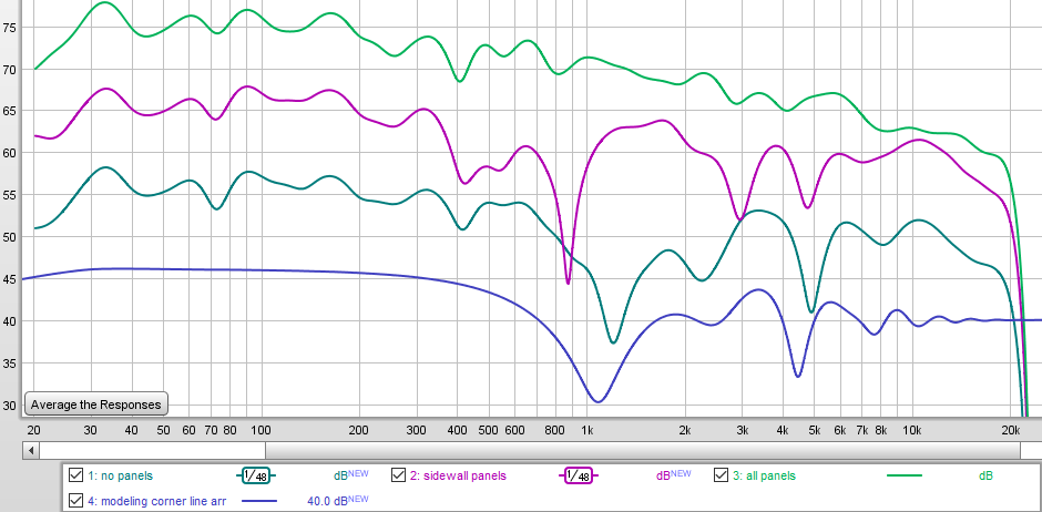

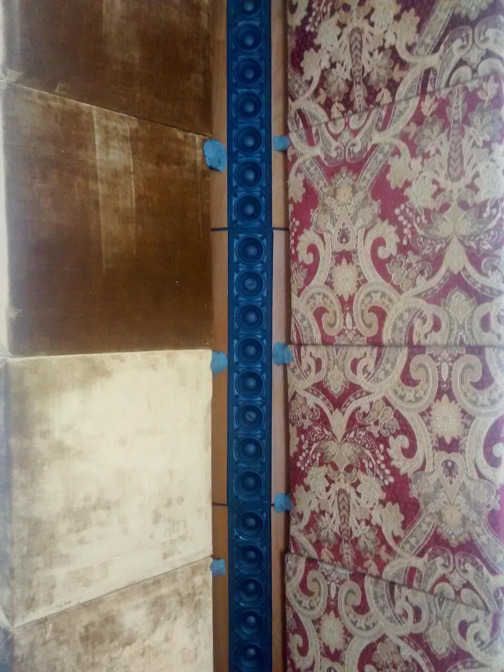

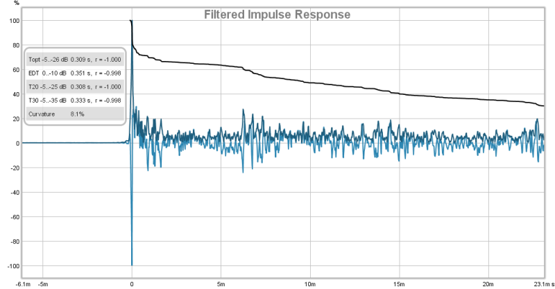

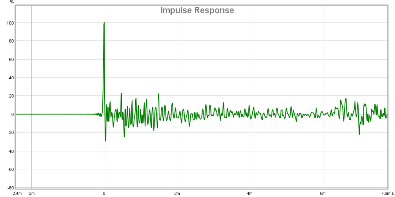

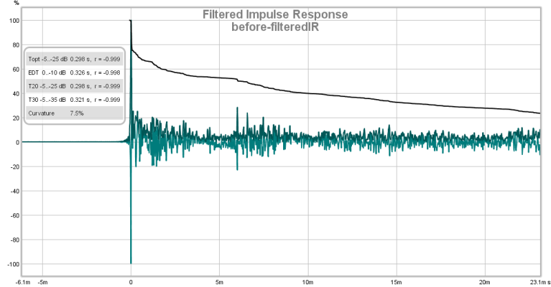

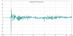

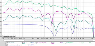

Corner absorbtion results
I put up some minimal acoustic treatments today. I don't actually have enough panels to do both channels, so I may go back to my partial-height array (which I think sounds better anyway).

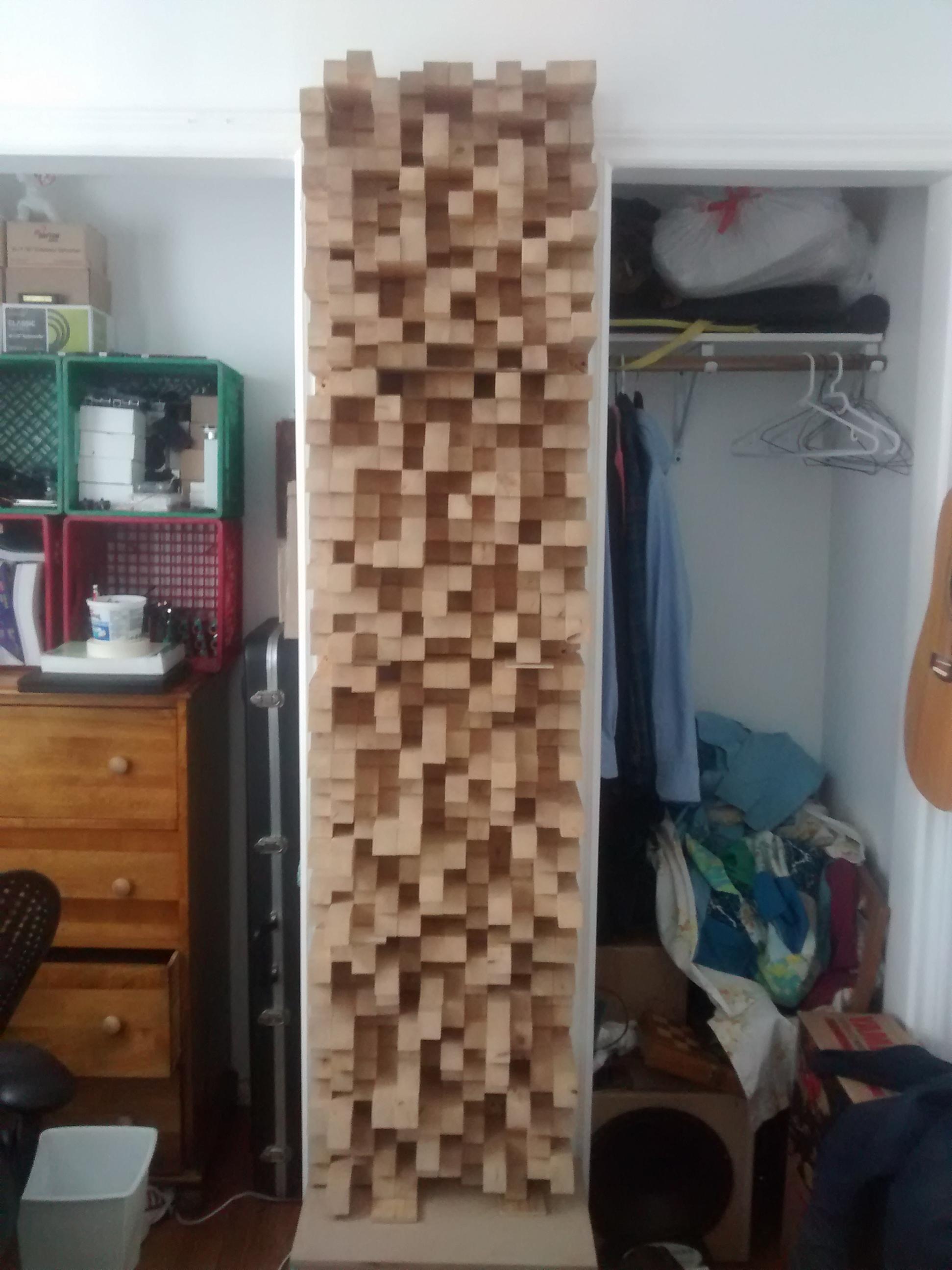

First I put up a diffusor behind my listening position, floor to ceiling basically. Not sure how much difference that made, so I might use the diffusors elsewhere instead.
Next I measured without the 2" absorber panels and then with them.
The comb filtering was very much as predicted in my model without the panels when windowed with FDW to 5 cycles. Adding panels on the sidewall (right in the corner by the line) helped a bit but made it worse in other ways. Adding panels on both the sidewall and backwall smoothed out the frequency response a TON. I can only report that this is essential treatment for corner line arrays.
From top to bottom:
- side wall and front wall treated
- only side wall treated
- no treatment
- simulation of first reflections from side and front wall
All measurements with the same manual, low-Q EQ. No FIR correction. FDW of 5 cycles. I included the comb filter simulation for comparison.
The "both walls treated" measurement was averaged over a few very close (inch or two) positions since I was getting placement-dependent high frequency nulls. I wasn't getting these nulls without the panels as you can see.. probably because of the corner reflections smoothing out the high frequencies. The HF nulls (which I've averaged out) are not audible.

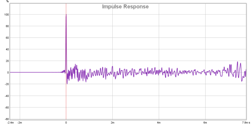

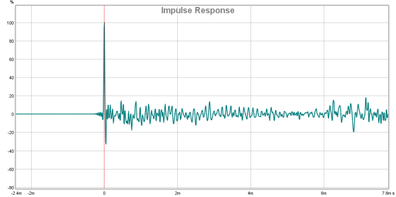

Strangely, the IR measurements look much worse after the panels than before. Quite a mess really.

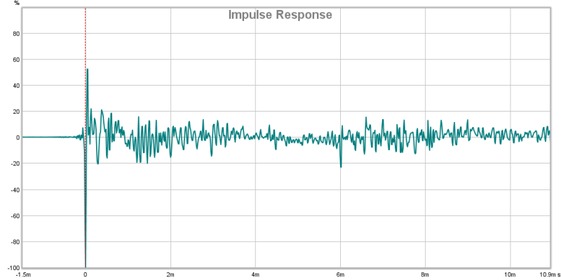

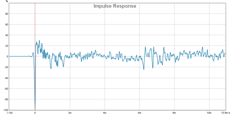

Any specific reason you plot the IR in dB FS instead of % FS?
The peaks seem to be higher in level, after adding the panels but you've got to keep in mind this type of plot mainly shows what's happening at higher frequencies. It still seems quite restless though, but I'd like to see the % FS IR plots. Just switch it in upper left corner of the graph.
No I guess I didn't see that option. It certainly makes a lot more sense in %!
I cherry picked this new "after" measurement for one that had a nicer impulse. Seems to vary quite a bit with minor changes in mic placement and EQ settings.
Yes it will vary quite a bit when moving. But this one is easier to judge. Usually I leave the Filtered IR in dB FS, and look at a ~50 ms window there, just to have two quick indications of what's happening. Is the green one pré and the blue one after?
The EQ will probably add a few early peaks. But I'm a bit puzzled by the 0.8 - 1.7 ms peaks. I expect some restlessness after the big peak (pointing down here) but after 0.5 ms to 1 ms it should level out. without any mayor reflections present. At 6 ms you have another reflection which could come from behind the mic?
Yeah. I dunno. Subjectively, I don't know if I prefer the corner treatments. It's getting more boring (read: dry). Still getting lots of wiggles in the frequency response depending on where I move the mic, even with the FDW.
More impulse responses. Don't know what's causing the weird behaviour around 0.5ms now. Maybe its still corner reflections off of the acoustic panels (they have wood frames). I'm not sure how to read the IRs since they vary so much based on location.
Getting annoyed so I will stop for today.
