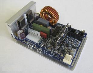

to EVA:
this is class D module (not public),developed in 2003
300w rms,400 Khz triangle wave, includes:
clip led,alc,pb adj,mute,regulate +/-15 on board,all protections.
continuos power without externalparts.
20Hz-40Khz bw -1 dB
very hi-Resolution. sound vey similar at class A-B
at 400khz, all is very complicate...
The two feedback loops on ICEpower are redundant. The same result may be achieved with a single post-filter loop and an output filter and layout having low parasitics. That's UcD, although it may be considered as having two loops because the signal taken from the output follows two different paths. In general, I think that a "single" feedback loop (like that) can do it all, but it may include several poles.
The 60A peak current capabilty may easily be real, although that's not very reliable for one pair of MOSFET with such a small heatsink, unless there is time/temperature dependent current limiting. But then the modules should also be rated at 2 ohm, and they aren't. Also, output coils don't look like capable of handling more than 10A rms or so for some time.
For example, my current project can do around 5kw on 2 ohm for 1 second (with time-dependent true-RMS current limiting to protect not only the amplifier but the power source and the load :D ). Current limit is 75A peak and 25A rms long term, but that's achieved using pairs of parallel MOSFET, and 13 AWG wire on output coils. There are low cost tricks to calculate rms current without expensive multiplier ICs.
It is not UCD eva, and it wouldn't be the same result at all as their performance is not equivalent. Perhaps you should reread the threads where their differences have already been discussed. Why must all your posts turn into a product advertisement for yourself?
