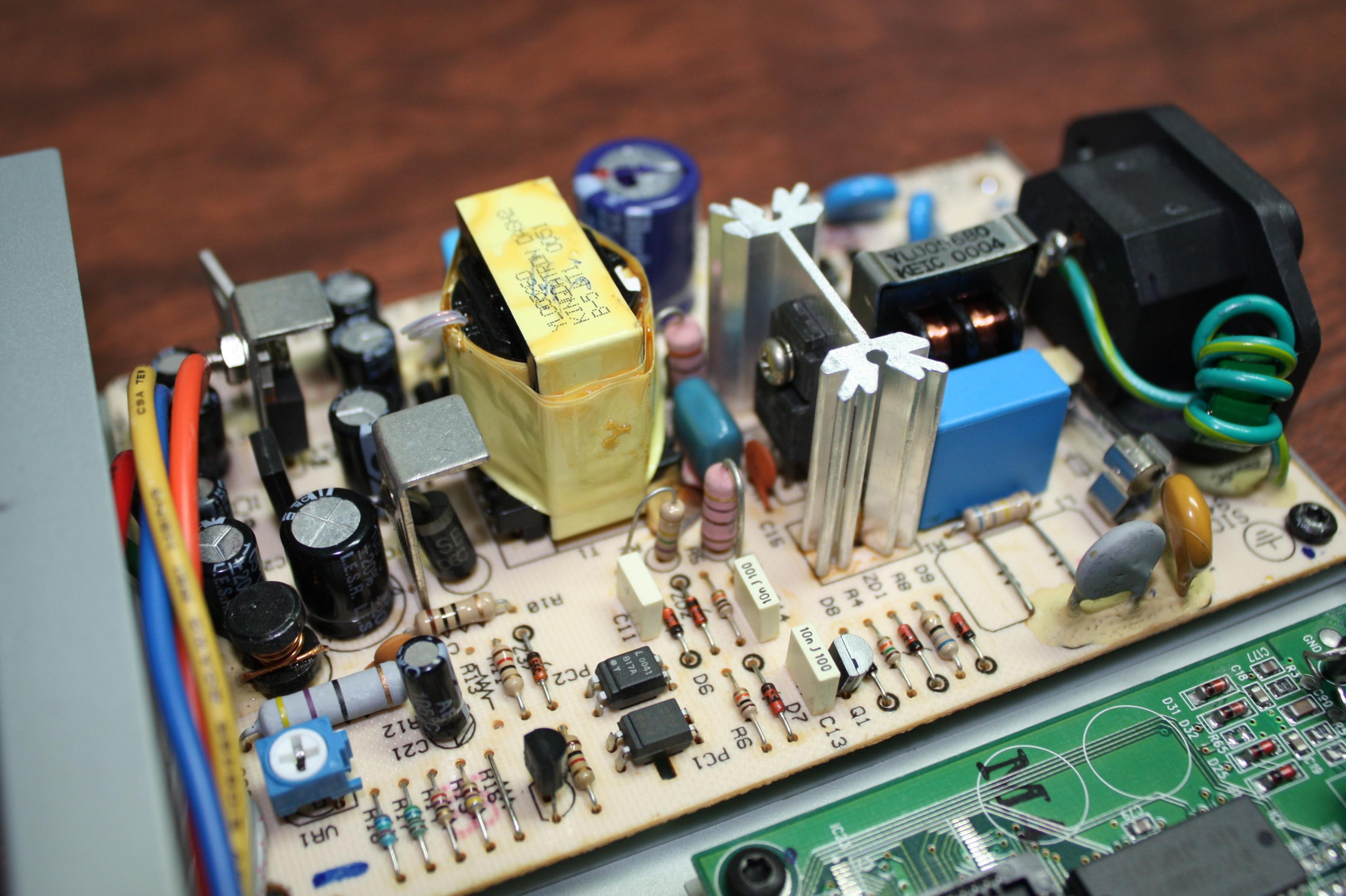

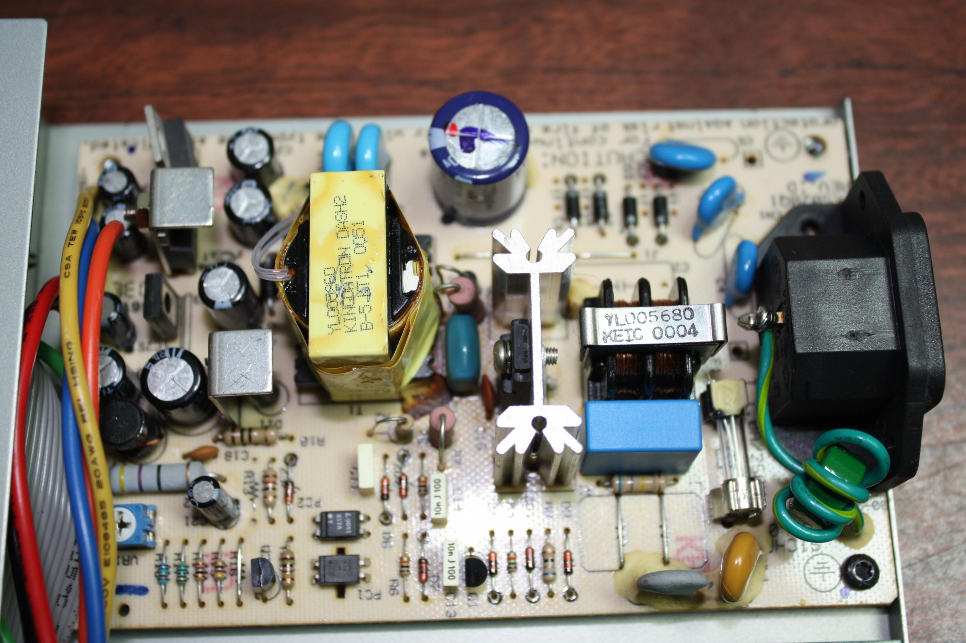

G-Major psu pics
I have attached some pics of the psu and look forward to any suggestions or starting points.
Thanks.

In that case, as you are not too sure, be very careful and first thing is to discharge the main capacitor the blue electrolytic next to the transformer.
When you are satisfied that it is safe to remove the board to allow access to the copper side, release the board to allow access to the copper side.
Check the secondary diodes for short circuits. If all OK, replace the FET power transistor and the blue small capacitor between the FET and transformer. Check the value of the resistors on the FET side. That is about it. Any more will require an isolating transformer and test gear with a lot of knowledge.

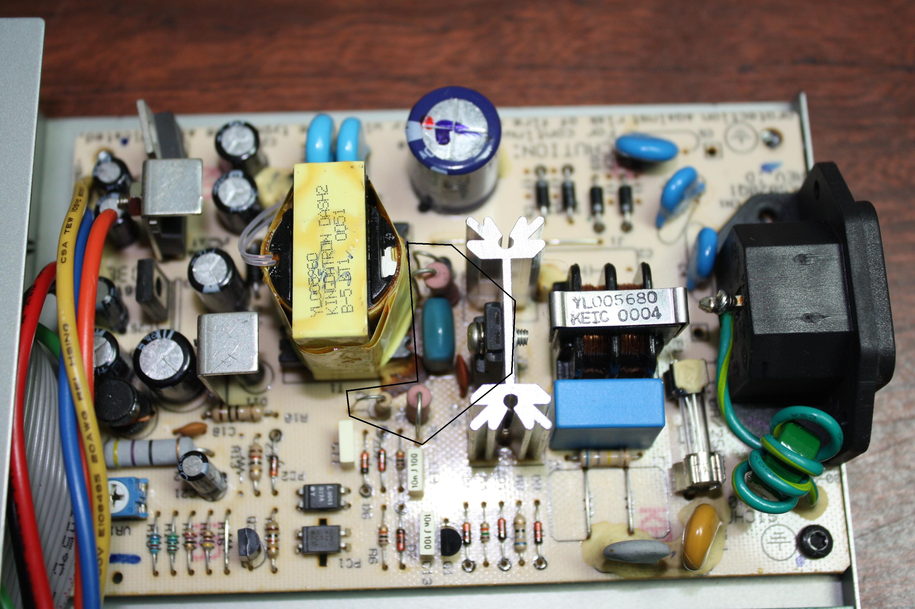

component locations
Thanks. I am aware of the cap risks and will discharge them. The psu has been standing in the G-Major dismantled for over a month now so it should be safe, but I will still discharge them to be on the safe side.
I have attached pic of the psu with components of interest marked:
- FET is attached to heatsink.
-Blue capacitor of interest
-four resistors -two north of blue cap and two south of blue cap.
Are these the focus of troubleshooting?
The diodes you mention are those the zener diodes along the bottom edge of the pcb?
