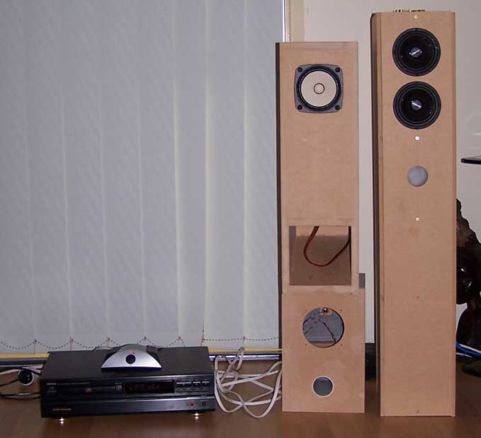

Jeb, I don't want to post a load of detail here, I'll just report on final construction/sound. But if you are interested you can follow "work-in-progress" at http://www.greenie512.net/greenie512/html/wip.html where I'll post pics over the next week of build process.
Cheers - Phil
build progress
Finally have one box build, wired and just running in. If you are interested in the fabrication see .. http://www.greenie512.net/greenie512/html/construction_w4.html
Currently one side is my Seas Thor TL's with the little W4's running on the other side not a very good balance but couldn't wait to hear a least one box. First impression was their efficiency - sound louder that the Thor on the other side at low/mediam volume. I've put biwire sockets in rear and am currently running speakers as bi-amped 4 ohm's but with a few jumper leads will play around with serial 8 ohm and parellel.
Sound are very good, but as an unbalanced pair can not really say yet what sound stage/depth etc are like.
Will try and get box No 2 finished during the week.
Cheers - Phil

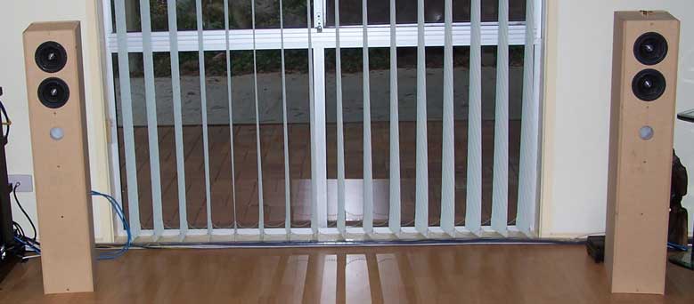

Final boxes … http://www.greenie512.net/greenie512/html/finished_w4s.html
Cheers - Phil

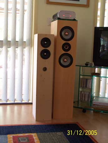

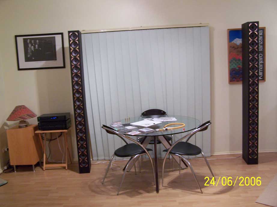

Gotta sneak these in, they now reside at my brothers place ...
Don’t know whether I should speak to a Stingray after what happened to Steve Irwin.
However … no grudges held – if you “backread” this tread you’ll see all my comments/judgments are based on what I heard as I have no measurement gear. I ready could not hear any undue anomalies due to these peaks/troughs you mention. That’s not to say that a younger (less that 50 - yikes) pair of ears might spot something.
So yes, I recon’ Joe Public would be very happy with these drivers. As I said in an earlier response – I’m afraid I can not give you further information as I sold the speakers on eBay quite some time ago. And, the buyer hasn’t come back knocking on my door saying I sold him a “duff” pair of speakers. Before you ask - I was very happy with them but just don't have room for ever set of speaker I make - so some have to go.
Cheers - Phil
Unusual for me, but I while I was here today I looked through several threads. I have a couple of things to add to this thread.

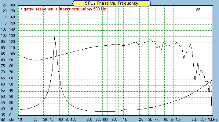

As far as I know, Tang Band has not changed the W4-1052SA (if it still goes by that model number). If it is still the same, then the cone glue mod and passive eq filter modification still hold and will improve the accuracy of the reproduction.
Cone vibration modes (or cone breakup) rarely show up in the imped plot. Imped plots show what is happening to the voice coil. During a vibration mode the cone and the voice coil do not couple well. If they did, either you would see the mode plainly in Imped curves or the cone would not be breaking up.
Two closely spaced W4-1052SA transducers (as closely spaced as physically possible) running full range will comb filter. If the spacing between the vertical listening position (ear) and each driver is the same there is no comb filtering. Even very small deviations from this equal distant position will produce very deep but narrow bandwidth dips in the response. These dips are audible. I find them easily audible if I move my head and change the vertical position of my ears in relation to the loudspeaker.
The effect, while audible, is not terrible. They are very narrow bandwidth dips in output. Dips are never as bothersome as peaks.
The effects of comb filtering in line arrays is very easy to measure. While I have measurements of the the combing effect I am not on a one man crusade either for or against line arrays. Does anyone else have measurements that they are willing to share?
If so, start a thread or contact me directly. I would like to talk about this, but I do not want to be the lone voice.

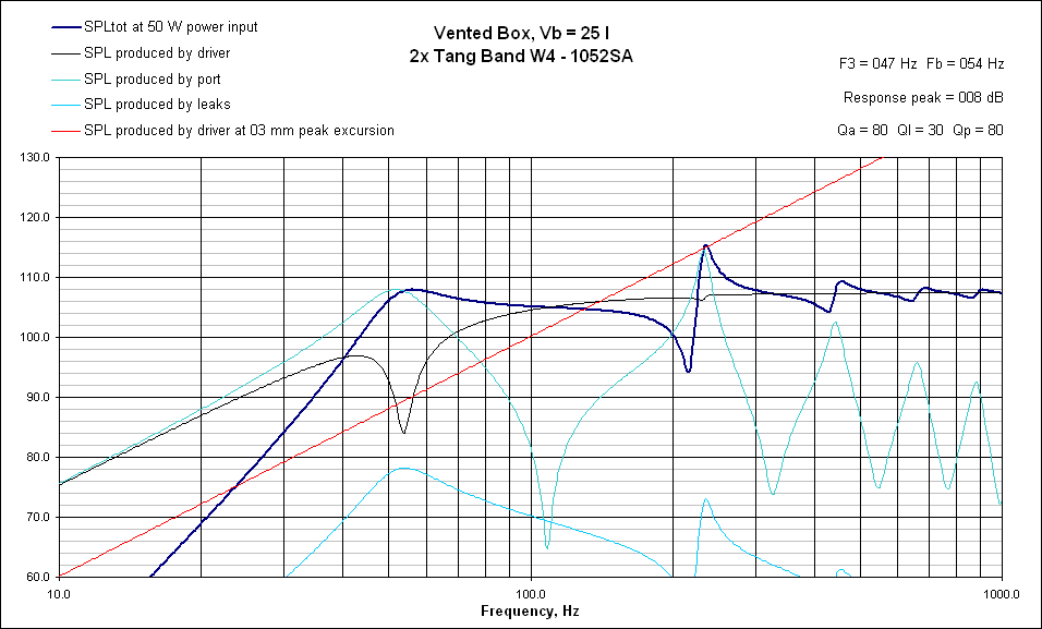

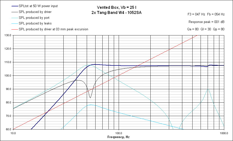

I finally got myself 2 pairs of these drivers and am going to try to build a pair enclosures. I am going to build a pair of bipolar bass reflex enclosures. I've been fooling around unibox and trying to understand how port end correction works with slot ports. I found an interesting article on JL Audio's website about slot ports and end correction. I was trying to think up dimensions to build a pair of bookshelfs without making the enclosures too deep and not too tall. I personally do not like the look of a tall bookshelf with a single driver per side because it looks plain. Since these will be made with solid wood or plywood i'm not going to paint, and cannot paint designs on the front so that they don't look so plain. So I was thinking about making it have 2 slot ports (one at the top and one at the bottom). I figure this would make it look less plain.
This brings me to the question of whether or not there are pros of having multiple ports vs a single port. ???
When I thought of using multiple ports I thought of designing an Onken style enclosure, but after trying to do some sims I found that the driver is definately not suitable in an Onken style enlcosure.
Any suggestion? Are there pros to having multiple ports?
Thanks,
Josh
Well after bringing up the issue with Dave I learned that I have much to learn.... By increasing total port area, port resonances decrease in frequency. As the resonance decrease in frequency the magnitude increases. So it looks like I need to stick with a smaller port, probably a single port.
Thanks,
Josh
