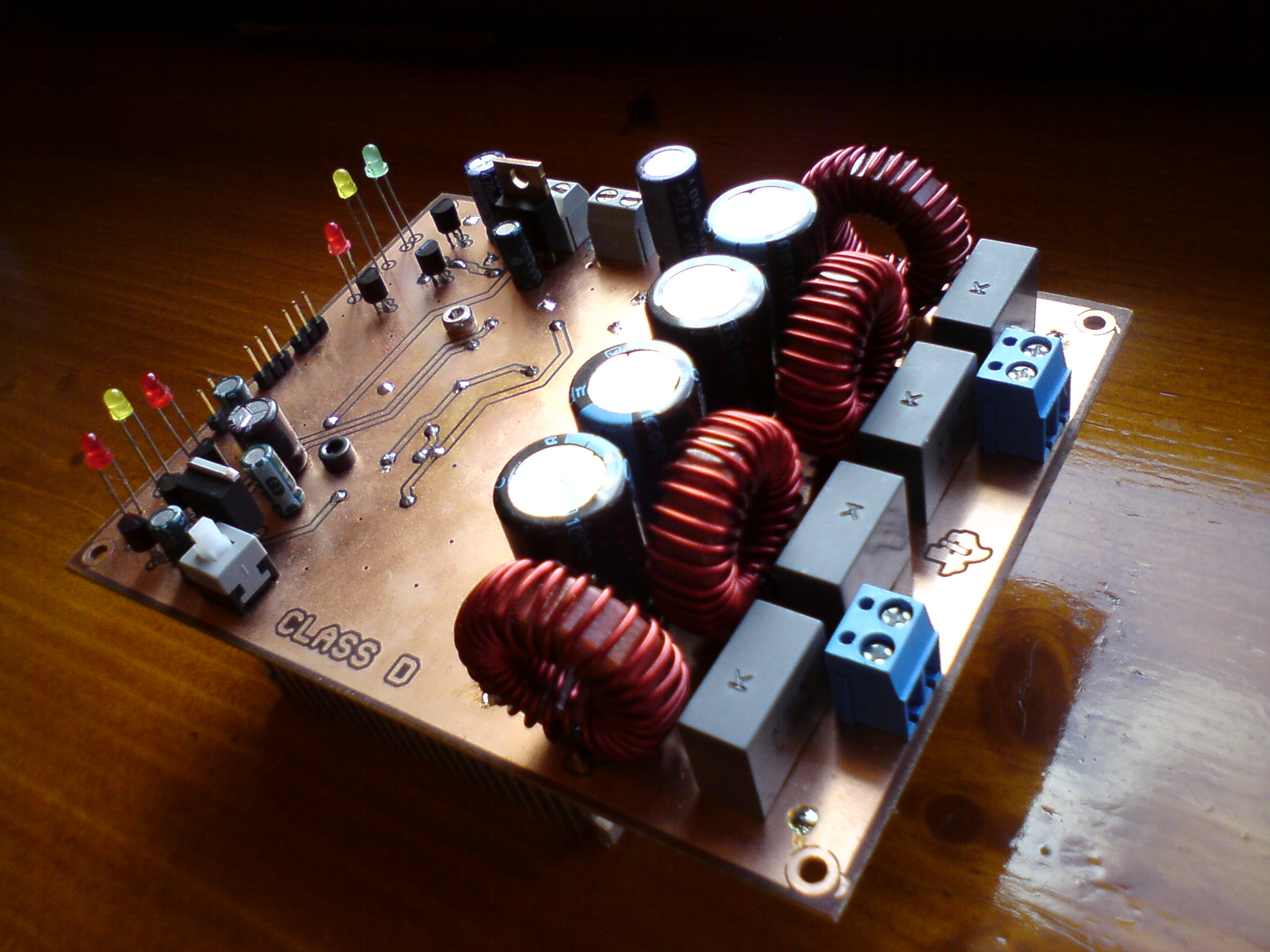

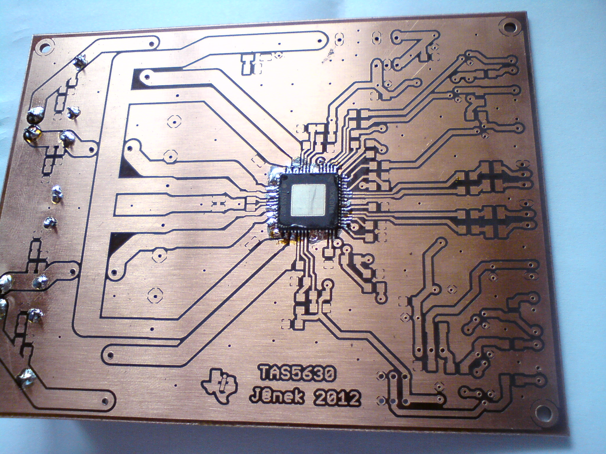

Hallo boys, this is my first poste here. I decided to built some small and powerfull amplifier. I found TAS5630 chip from Texas Instruments and here is result of my half-year work. Design of PCB is my own, 50% copied from datasheet of TI evaluation board. The amplifier have good sound and good power potential. After some time i will upload some measurments.

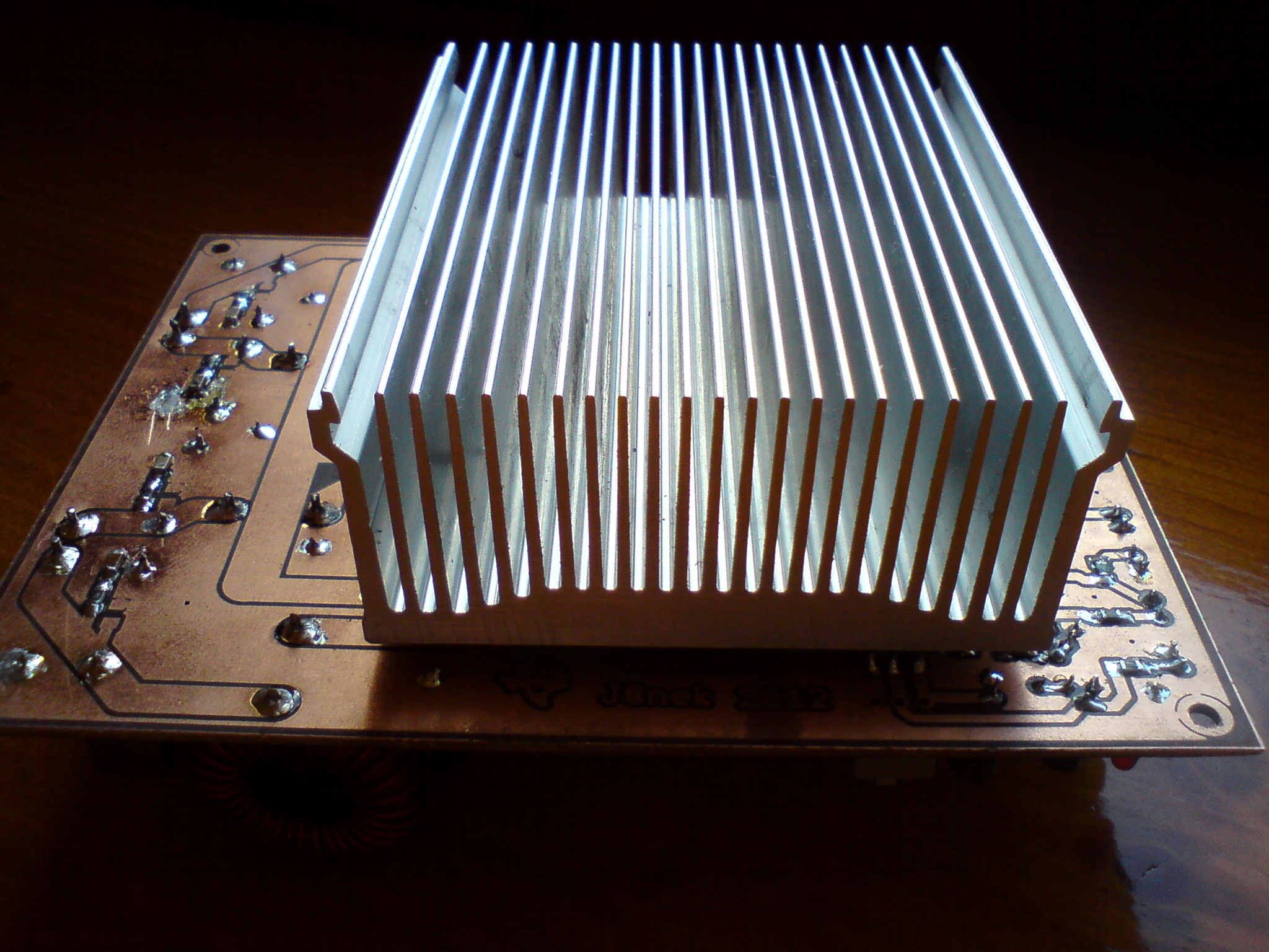

Thanks, i placed TAS5630 on botom of board because it was easier, i think. Heatsink is fixed by 4 screws, between chip and heatsink is thermal paste. Here is small gallery from measuring.
