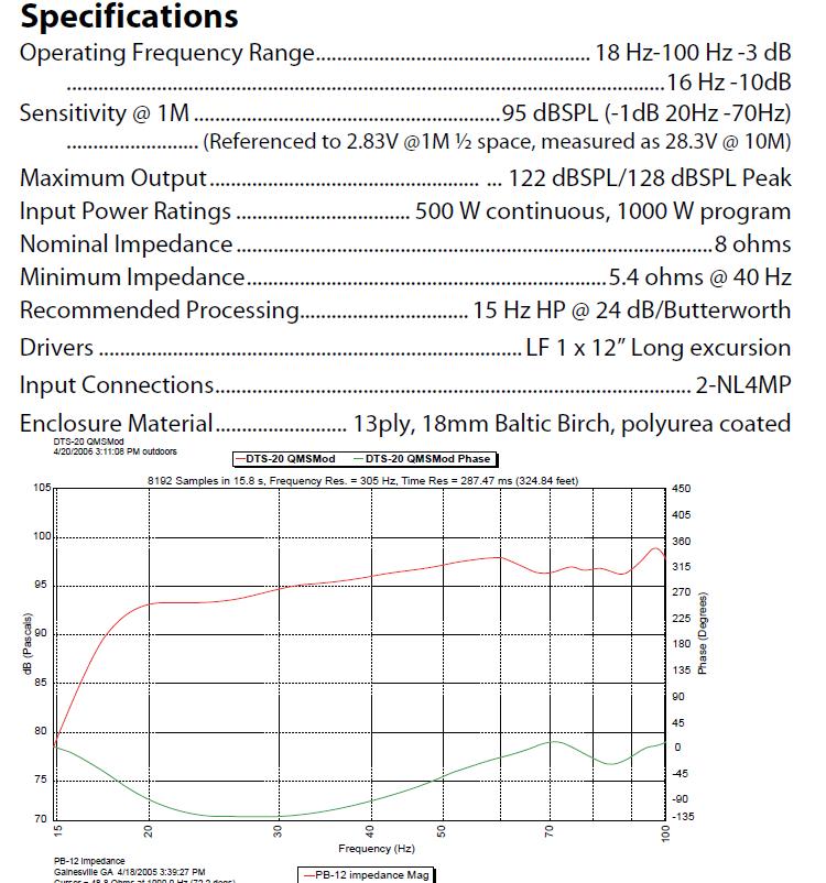

I'm interested in a high quality horn subwoofer. Initially to use in a home theater but also get the chance to try it out in a two channel setup where I also need a subwoofer solution in near future. Horn is tempting due to high output and low distortion.
The ideal bandwidth would be 18-120 Hz (I know, probably too wide) and my minimum requirement would be 23-85 Hz. The Danley DTS 20 would fit the bill, but unfortunately isn't sold as kit.

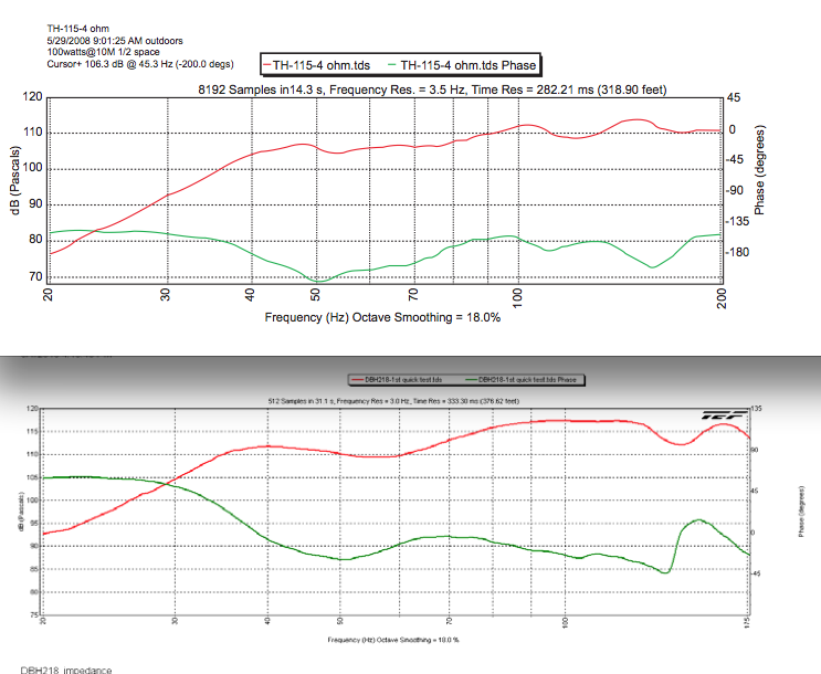

In general, a good FLH can approach a decade (20-200, 40-400 Hz) of useful smooth operation, while a TH is more limited to 2-3 octaves.
As you can see from the phase and frequency response of the DSL TH and their FLH with roughly the same low frequency cutoff, the TH actually has less phase shift than the FLH in the 20-200 Hz range.
