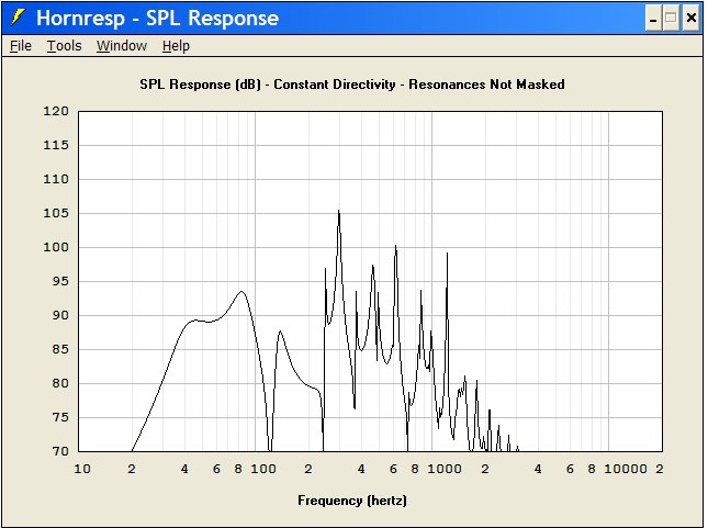

I hate to say it, but there's a big fat fundamental flaw to all the tapped horn simulations that everyone's been doing here.
When I built a bandpass and a tapped horn, I was surprised to find that the bandpass seemed to be louder. The simulations indicated the TH would be dramatically louder.
Well here's the prob. Everyone is doing their simulations as if the tapped horn is perfectly corner loaded. To see if my hunch was correct, I used horn response to model a bandpass subwoofer, then modeled the *exact* same bandpass subwoofer in bandpass boxmodel (which has proven to be quite accurate.)
Sure enough, horn response predicted an SPL level that was DRAMATICALLY higher than the other program.
Once you tell horn response to do it's simulation in "free space", the results are a lot closer to reality.
Just to do my due dilligence, I modeled a tapped horn with the same driver, this time in free space. It confirmed exactly what I'm hearing. The tapped horn wasn't more efficient than a bandpass, but it played about half an octave deeper, in a box that was marginally larger.
Again, I'm not trashing tapped horns, they're a clever invention. But if people think they're going to get an extra 12DB of output with the same driver, they are DREAMING.

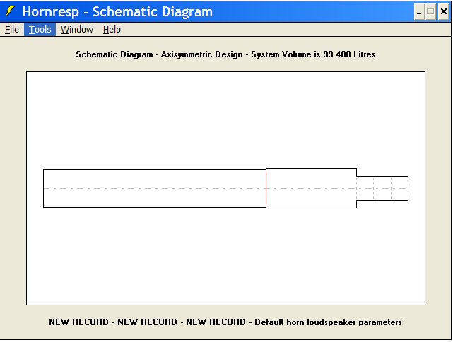

Here's a schematic of a front loaded horn modeled in horn response, which is actually a bandpass subwoofer. Though a bandpass sub is not a horn, horn response will happily model it. As Geddes noted, most sub horns aren't horns either, they're just deviations on dual and single reflex bandpass boxes. In this schematic you will note a front chamber, a rear chamber, and a port. It's a single reflex bandpass.
