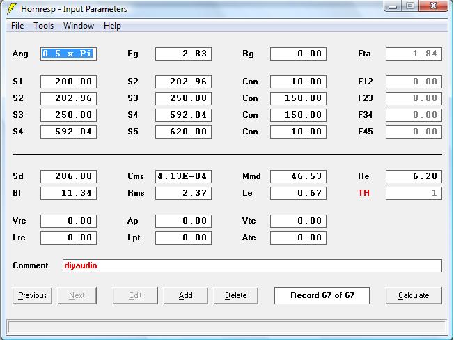

TRIO8 Beginning
OK gents here is the biginning of the TRIO8 True Tapped horn. It is not that small. It is actually 5.5 cubic feet or 156 liters. But it is quite efficient. As a home wall mount it is 94db/watt. In a car you get a nice boost.
Just as a teaser I modeled a twin SDX7 to go down to 20hz. Not a true tapped horn just a nasty littel impedance transformer like the unhorn. About 57 litres. This I have to try.
So here are the pics:
Raw driver measurement
1 watt SPL
Max SPL
Simulated impedance.
Mark
