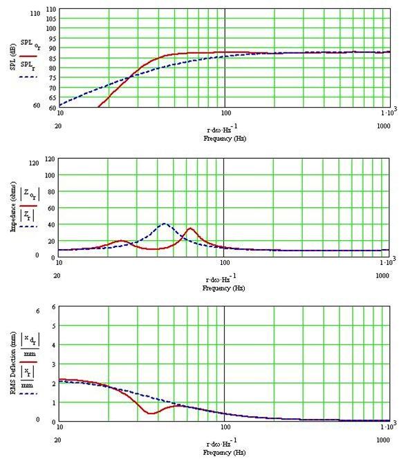

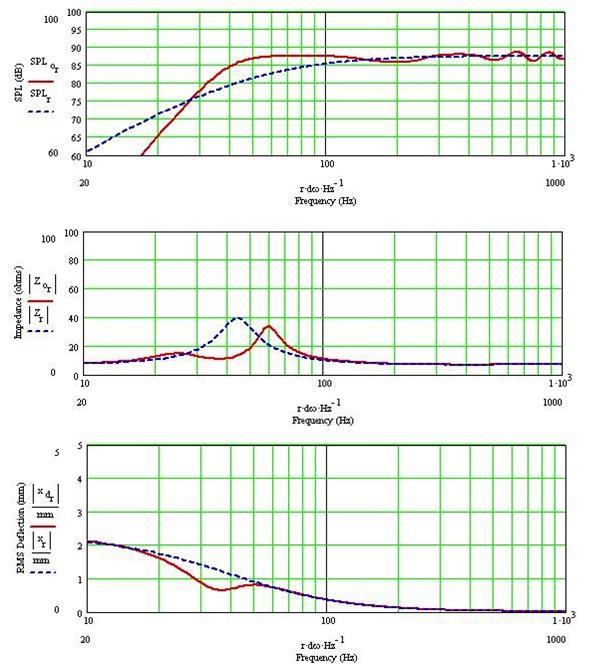

While I don't want to make claims of what's "right" and "wrong", i think that if the tapered TL (quarter wave) is getting the same response profile as the ML-TL (bass reflex) then you're probably modelling the Tapered TL... unusually.
In my modelling, the MLTL was uniformly stuffed at 0.5 lb/cu ft, but the TL was only stuffed in the first half (from driver end) of the line at 1 lb/cu ft. The second half of the TL was left empty. I used a 5:1 taper, starting at 3.4*Sd and ending at 0.68*Sd. The driver was a 6.5" poly-coned unit from HiVi, although that may not be my final choice.
The attached plots show freq resp, impedance and cone excursion for each configuration. If I stuffed the whole of the TL, then the plots were very similar to yours, with very little bass reinforcement.
Chris.

What I've found to be almost always the best stuffing configuration for the best overall system response coupled with optimum port/terminus air velocities and driver excursion considerations, is this: In an ML-TL only the first 50% of the line's length contains stuffing, while in a tapered TL it's typically the first 60-67% that's stuffed. If stuffing is added beyond those lengths, the detriment to F3 is usually too severe for whatever is gained anywhere else. Increasing the stuffing density, however, for the lengths I mentioned will provide improvements in response smoothness with a much smaller detriment to F3. Just a whiff of stuffing in the terminus of a tapered TL will completely kill its output. In a tapered TL I will use a larger taper ratio before increasing stuffing density or length because the larger taper also minimizes response ripples (I never use a taper ratio smaller than 10:1).
Paul
