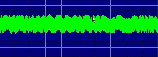

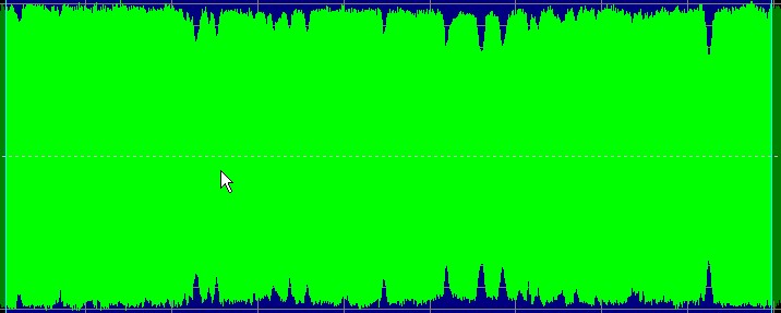

I'd also like to post the waveform of the spectrum.
This is a small portion of the recorded waveform - not zoomed in all the way - as I wanted to show you the "notches" at the top and bottom of the waveform.
What does that indicate ? An issue with the tape, or the heads, or bias ??

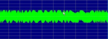

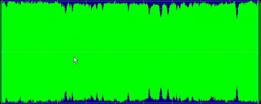

Higher the frequency of the signal the more rougher they get. As you can see in the next one which is a 16Khz signal.

The "skirt" is phase modulation of the test signal, caused by wow and flutter. It does not widen as the level is increased, just shifted upwards along with the test tone. If that is a Pio RT707, the dual-capstan explains the low level of wow and flutter. The notches in the waveform indicate worn tape, inadequate tape tension or both (dirty head excluded). Another interesting test would be to connect the L/R channel outputs to the X/Y inputs of an oscilloscope. You should get a stable 45° straight line. If there is some phase difference between the channels or the playback head is misaligned re the record head, the line becomes elliptical. It is a tough test at 16 kHz... Also the playback level at 1 kHz and at 16 kHz should be about the same, if recorded at -10 dB.
The Rt-707/701 has a bad capstan AC servo, if you play back a 1kHz tone you can hear it. I sold my RT-707 in the mid eighties because of that. Looks like a tank ,but it is a flawed design. The wave form as oshifis mentioned is looks like dropout, the recording probably was made on an old used tape.
