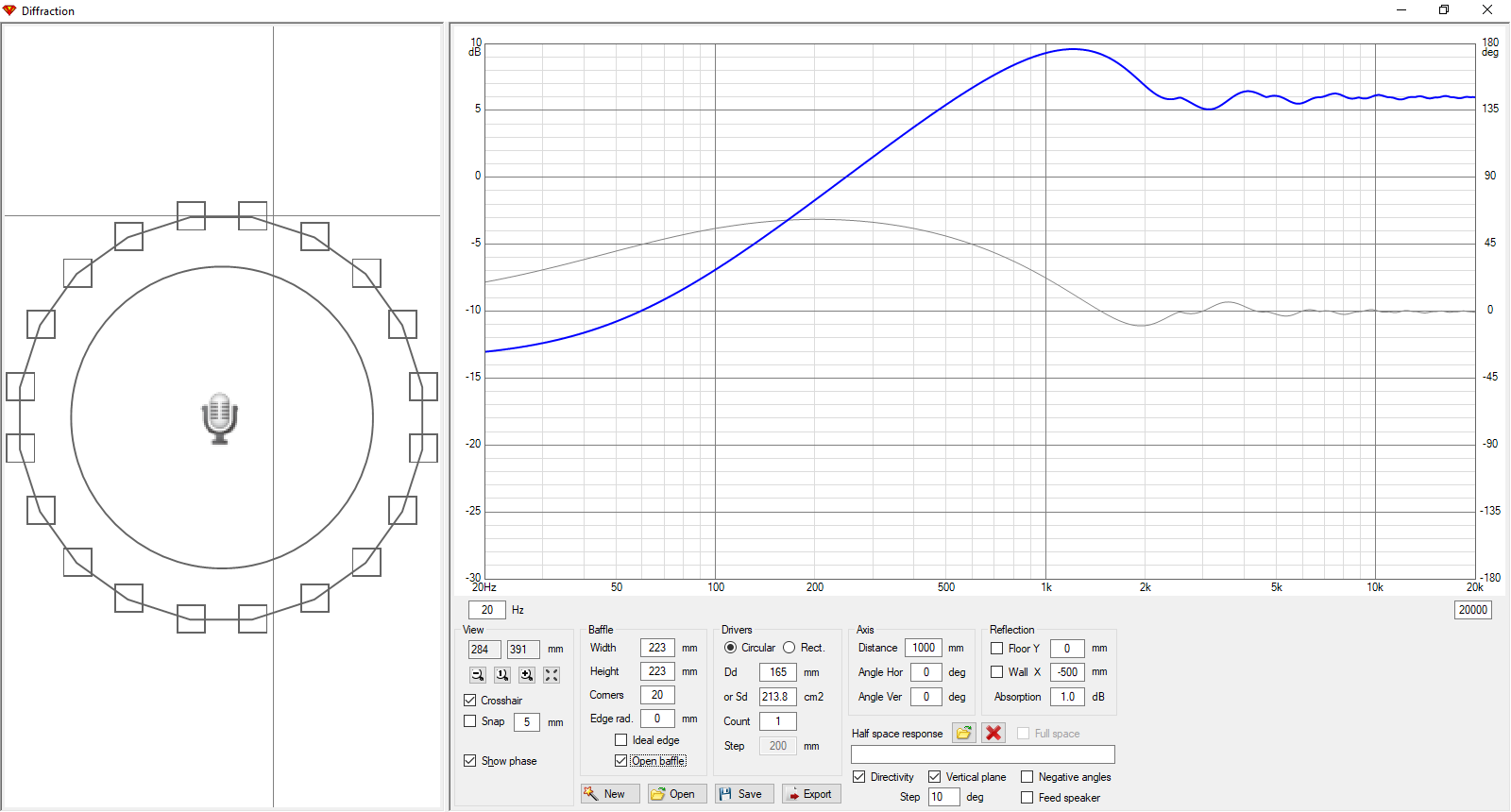

By the way your calculation above is way out - a first approximation of the 3dB rollover point on a rectangular baffle is 115/width in metres. So in your 11 inch example the rollover point would be 412 Hz not 1232. :) And yes, very audible if not equalised.

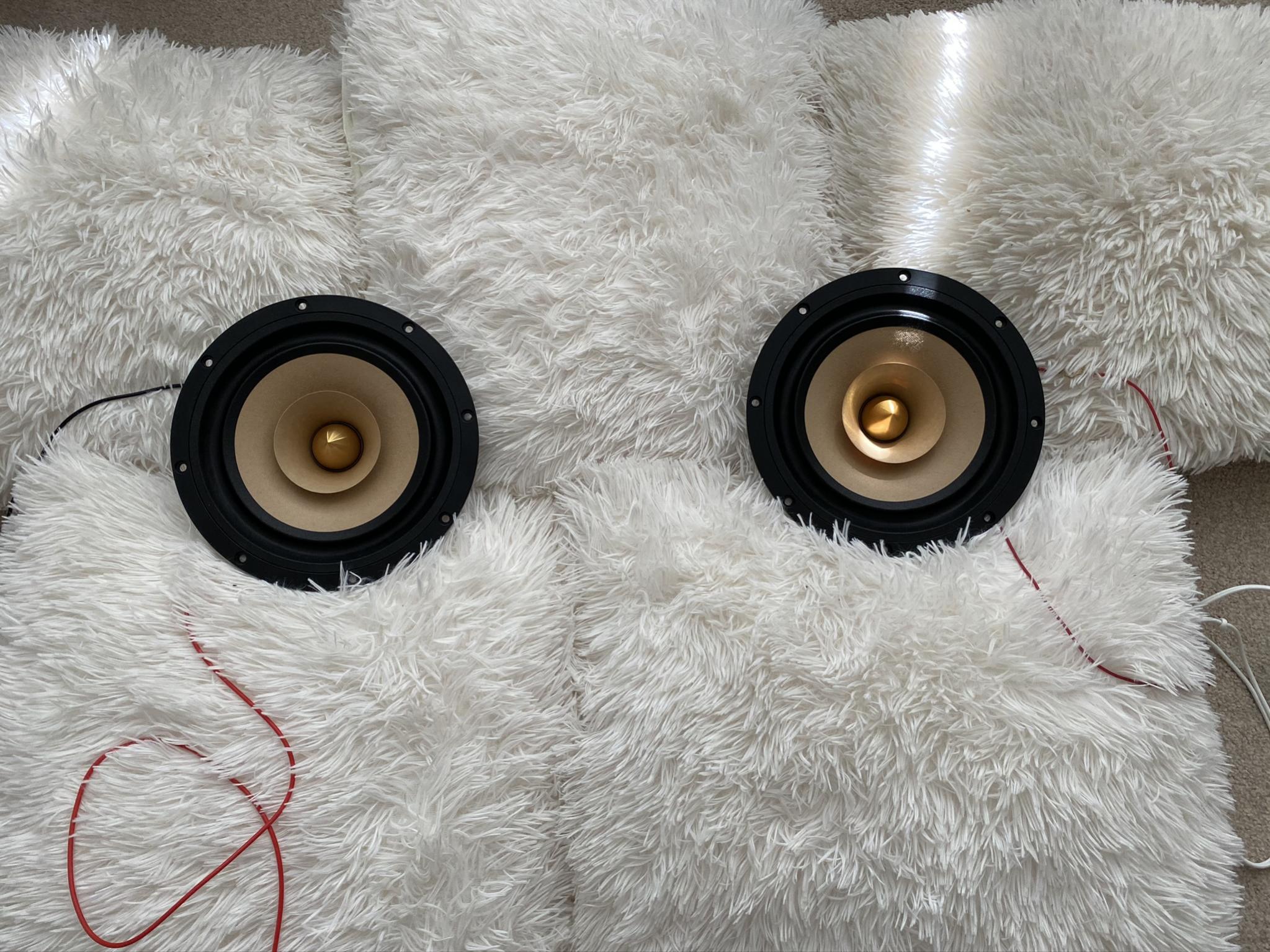

So the 1772's arrived today, and I thought I would give my first impressions. :)
This is not a review as such as I don't have a proper cabinet or even a flat baffle to test them on at the moment, so just some observations about their construction and build quality, along with a bit of quick listening with them on their backs on the floor pointing up nestled within a "cushion baffle". :D
Obviously in this condition they won't produce any bass and will only go down to around 300Hz since it's basically a very lossy open baffle. However, I'm only listening to the midrange and treble to evaluate how neutral they are and whether they have any obnoxious (and potentially incurable) upper midrange or treble resonances that are common in many full range drivers, and I have listened to several other full range drivers in a similar fashion in the past as a rough and ready test so sort of a fair comparison.
In short, in the couple of hours testing I did I'm extremely impressed by the midrange and treble quality of these drivers. I think it would be fair to say in terms of midrange and treble smoothness they are probably the best 8" full range drivers I've ever heard, and I don't say that lightly. Perhaps even the best full range driver I've heard, full stop. The frequency response measurements while good, just don't do them justice.
Yes I still love my vintage Coral drivers, and for their age (designed in the 70's using paper and pencil without modern CAD and measurement equipment) they are still wonderful but these are better. No question about it, at least for midrange and treble.
And that's a good thing, because I've been looking for many years for a modern driver which follows the same basic design principles as the classic full range Coral's but which are affordable, in current production, and don't suffer from excruciating whizzer cone resonances common to many other other full range drivers.
And I've tested some duds in the past. Particularly disapointing was a pair of Fostex FE207 which I bought in the late 2000's before the W8-1772 existed, which was well regarded at the time but which suffers from a severe and inexcusable resonance around 2.5Khz which totally ruins the driver, IMHO. A resonance that can't be notched out or ignored. (It's not a symetrical peak, it's a razor sharp high Q peak and notch side by side due to some sort of phase cancellation effect between the cones I think)
Within minutes of listening to the FE207's all those years ago my heart sank and I knew I had wasted my money. I soldiered on with them for a few weeks but eventually gave up on them and went back to the Coral's. Also disapointing with the FE207's was the whizzer cone was ineffective at improving upper midrange dispersion compared to the Coral's.
That bad experience is partly why I've held off for so long in taking a chance on these. But I'm glad I finally took the plunge.
I tried a variety of music listening for any trace of upper midrange or treble harshness and couldn't hear any at all. Clean, clear, smooth. Not even any sibilence. No random "cone breakup hash/noise" audible either.
Granted, it's not completely neutral, at least on my cushion baffle....:) There is some emphasis in the presence region (later revealed in measurements) and the on axis treble is a bit hot, as widely documented, but not unreasonably so. Both easy to tweak with a little bit of EQ.
I was particularly impressed by how far off axis the treble response goes. It's remarkably wide dispersion for an 8" whizzer cone driver with usable treble right out past 20 degrees, and there is a decent amount of treble in the room reverberant field.
By comparison the FE207E has very poor off axis treble more akin to an 8" midbass driver, the Coral Flat 8 have considerably better off axis treble than the FE207E but these are on a whole other level when it comes to off axis treble dispersion. Quite impressive.

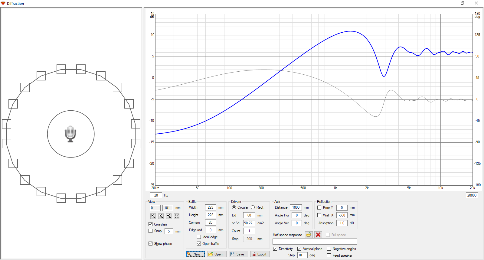

I then did some very rough measurements with the microphone pointing down at the speaker and noted a few things.
There is indeed no "surround" dip at 1Khz at all, agreeing with other measurements posted in this thread. Every other 8" full range driver I've measured has had a distinctive surround dip near 1Khz - some worse than others but always there.
This is the first one I've measured with no dip at this frequency. That is quite some engineering as it would take precise mechanical impedance matching between the cone material and surround with just the right damping in the surround to achieve this. Well done whoever designed this driver, surround dip is a hard problem to solve!
There is a peak of about 3dB at 2.2Khz with approximate 1/4 octave width which explains the slightly forward presence. I tried notching this back a bit with active EQ and sure enough it made the driver more neutral in tonal balance and a little bit more laid back. To be honest it sounded good with or without the notch though - just a bit more forward or laid back respectively. In neither configuration (notch or not) did it sound harsh or dull.
On axis a peak at about 3.5Khz is evident and this is shown in some other people's measurements, however this peak is not there off axis, and also not there when I change the baffling around the driver. Likewise there is a significant dip/hole around 4.3Khz on axis which disappears off axis or if I change the baffling. However the 2.2Khz peak is always there roughly the same at different angles and with different baffling.
From that my initial conclusion (until I can do properly controlled measurements) is the peak at 2.2Khz is a genuine (but fairly benign and damped) cone resonance which could perhaps do with notching, while the peak at 3.5Khz and dip at 4.3Khz I initially measured is just a diffraction artefact due to the driver not being properly flush mounted on a low diffraction baffle.
An unbaffled driver is a bit of a worst case scenario as the frame of the driver behaves as a circular baffle which is much worse than a rectangular baffle since every ray leaving the middle of the driver reaches the edge at the same time, stacking all the standing waves all around the perimeter at the same frequencies... The worst measurement result was achieved with the driver sitting on it's back with the frame in mid air, and the response with cushions acting as a partial baffle was much flatter. At some point in the future I will get a chance to measure it on a proper baffle.

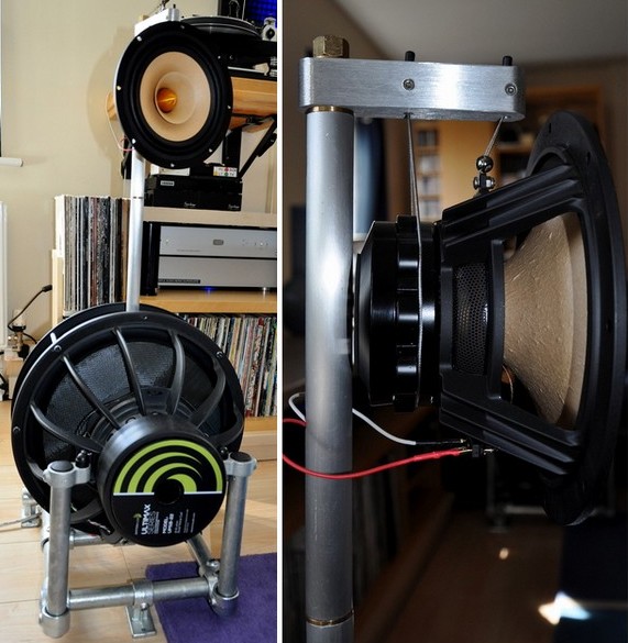

You should borrow a pair of decent performing speakers, done in conventional enclosures, just to hear how far off the open baffle approach is.
Ouch. A bit harsh, but true I'd say.
Also a traditional open baffle approach uses a large baffle to put the transition frequency sufficiently low and add sufficient time delay to the first diffraction events.
When you mount the driver in free air the drivers own frame is the only baffle, so it is very small, (high frequency transition) has a very small time delay (image smearing) and it's a circular baffle, which is the worst possible shape because all rays travelling from the centre reach the edge of the "baffle" at the same time.

If you simulate an 165mm cone with a 223mm frame diameter (which is about right for a 1772) you get something like this:
attachment.php
A big honking (literally) broadband peak of around 4db at 1.2khz, and a rapid fall off below 500Hz.
It's not quite as simple as that as that though as the 1772 is a dual cone driver which does not have the poor high frequency dispersion of a typical 8" driver, it has a wider dispersion in the upper midrange. This can be approximated by using the diameter of the whizzer cone in the simulation:
attachment.php
Oh dear, that makes things even worse, adding a big dip around 3Khz and a response that is more bumpy above 3Khz.
For what it's worth I took some measurements of mine held completely unbaffled when I first got them (I didn't save them unfortunately as I was just messing around) and I saw just that - a big peak around 1.5Hz, a notch around 3Khz and I actually saw more peaks and dips than the simulation suggests. (Which implies the dispersion is wider)
Not a good sound. I also tested them with pillows forming a crude, lossy baffle for a quick rough and ready listening test:
attachment.php
The difference between the bare driver and the "baffled" response with the pillows was night and day, and the measurements were totally different.

Each to their own I suppose, however in the nearly 20 years that I've been tinkering with speaker designs (only as a hobby) the single biggest dawning realisation that I've had that has resulted in a big shift in my design approach has been taking diffraction at high frequencies (>1Khz or so) really seriously.
And flush mounting of drivers to avoid any diffraction at the driver/cabinet interface is a big part of that and it really does make a difference to not just how smooth a speaker sounds, but how good it's spacial pattern is.
Despite the knowledge being in the public domain for years, I still see so many DIY designs that don't really care about diffraction at all with drivers screwed onto panels not flush mounted, and old fashioned recessed front panels with large frame around the outside, especially on mock vintage full range cabinet designs. Or other oddball high diffraction designs. Just a diffraction nightmare.
I think taking diffraction seriously is so important that I actually went back to an older pair of speakers that I built more than 10 years ago that I've been using for years and flush mounted the tweeter, (previously screwed lazily onto the front with a small lip) and brought the front panel forward so that it was now flush with the frame instead of recessed. Big improvement, and not hard to do.
Mounting a driver in mid air with no baffle at all so that there is a huge diffraction wavefront coming from the abrupt perimeter of the driver frame (it's almost a ring radiator around the driver producing a destructive interference pattern) is frankly the worst nightmare scenario from a diffraction point of view. You pretty much can't do worse for diffraction than a circular open "baffle" that the driver frame forms by itself.
Sure you could attempt to EQ it and remove the most egregious peaks and it will sound better, but it will never be right on and off axis.
While I think there is some merit to large open baffles, (not a design that interests me though) I just can't get behind a circular open back driver suspended in mid air without any baffle.
