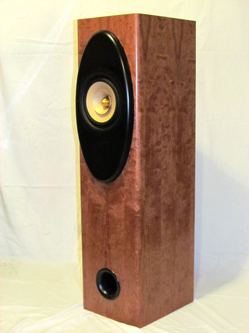

This is what's left from my 90x90cm baffles:
The new crossover frequency is 350hz (W8-1772 goes flat to 300hz without any EQ). With this design midrange sounds more open and much cleaner then before. The soundstage has grown in all dimensions. Bass has lost 3-4 db's, but that's not a big problem with an active setup.

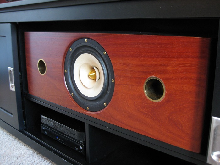

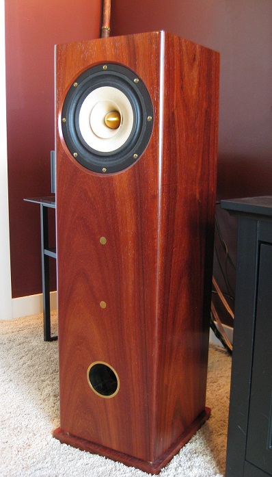

Tang Band W8-1772 Fronts, and Center Channel
These were a labor of love.
I'm very pleased with the way the cabinets turned out, and they sound wonderful as well. The imaging and vocal presence are especially remarkable. The cabinet materials are padauk and brass. They are tuned to 48Hz and the internal volume is about 1.6 cu. ft. I applied a 1.3mH / 3.3 Ohm baffle step correction to both the fronts and the center.
A special thanks to Mr. Brines, for inspiring me with his work.
Do note that these look much more like an ML-TL than a BR. If you used a BR modeler to get that tuning then it is not the actual tuning.
