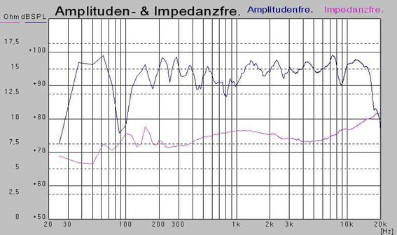

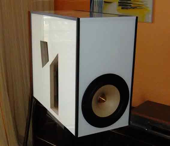

hello,
i got a nice Schalmei Sat feedback: 2
schalmeiFB
norman:
thanks for the link,
Voxativ so bad measurements and so good,
look my RDH20 measurement and IMP !!,
both cheaper than one V-driver

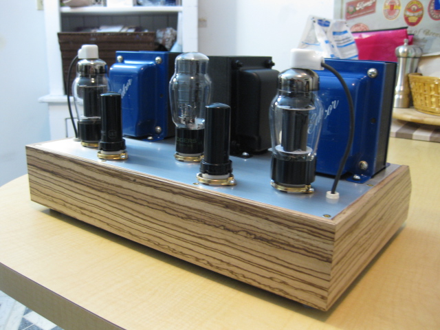

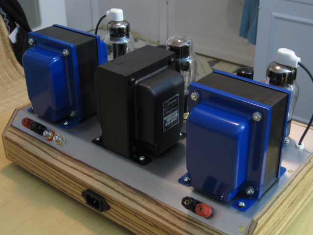

I spent a couple hours last Thursday night listening to a 6CB5 se tube amp on my TB1772 speakers! This combo sounded really good!!
