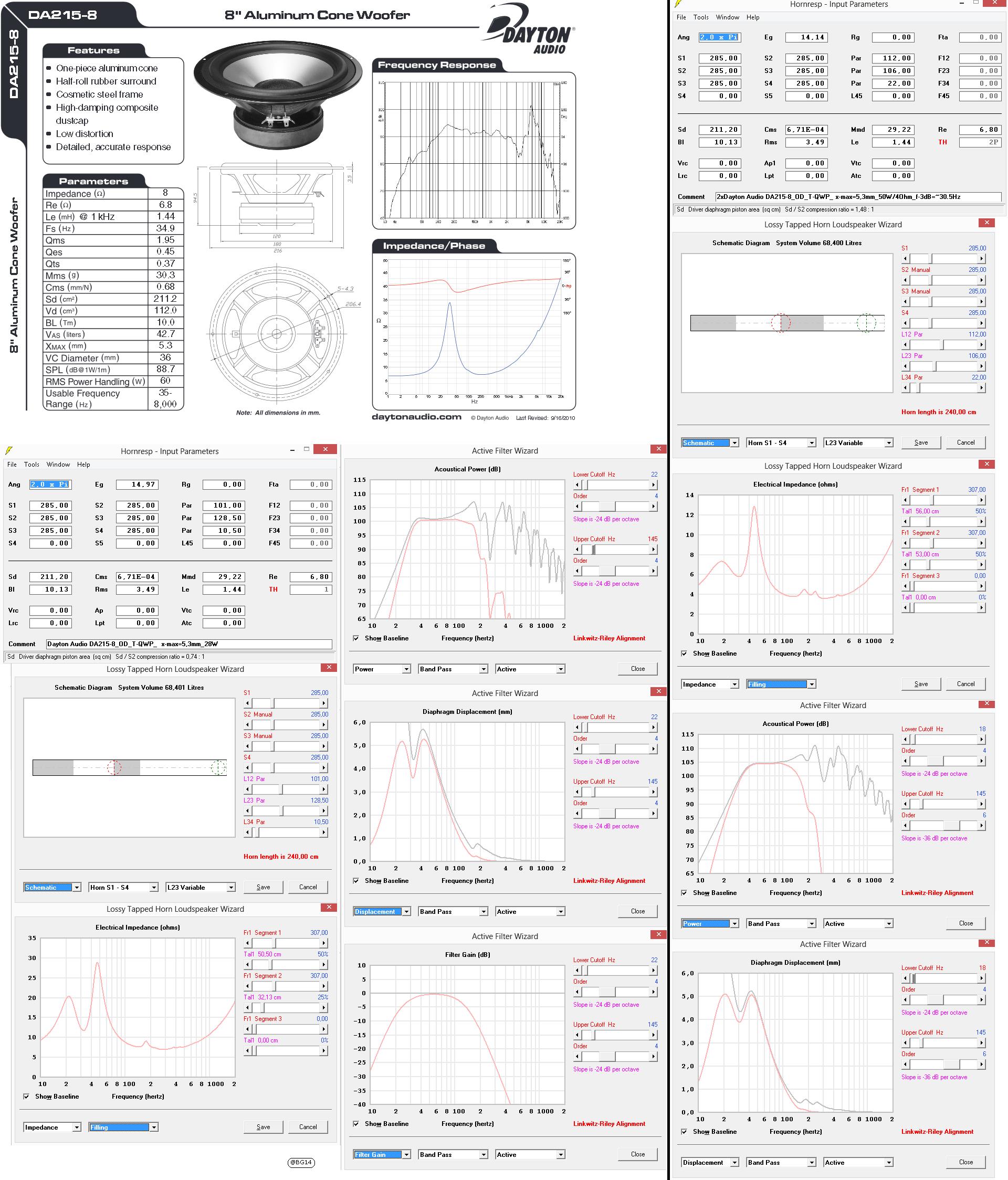

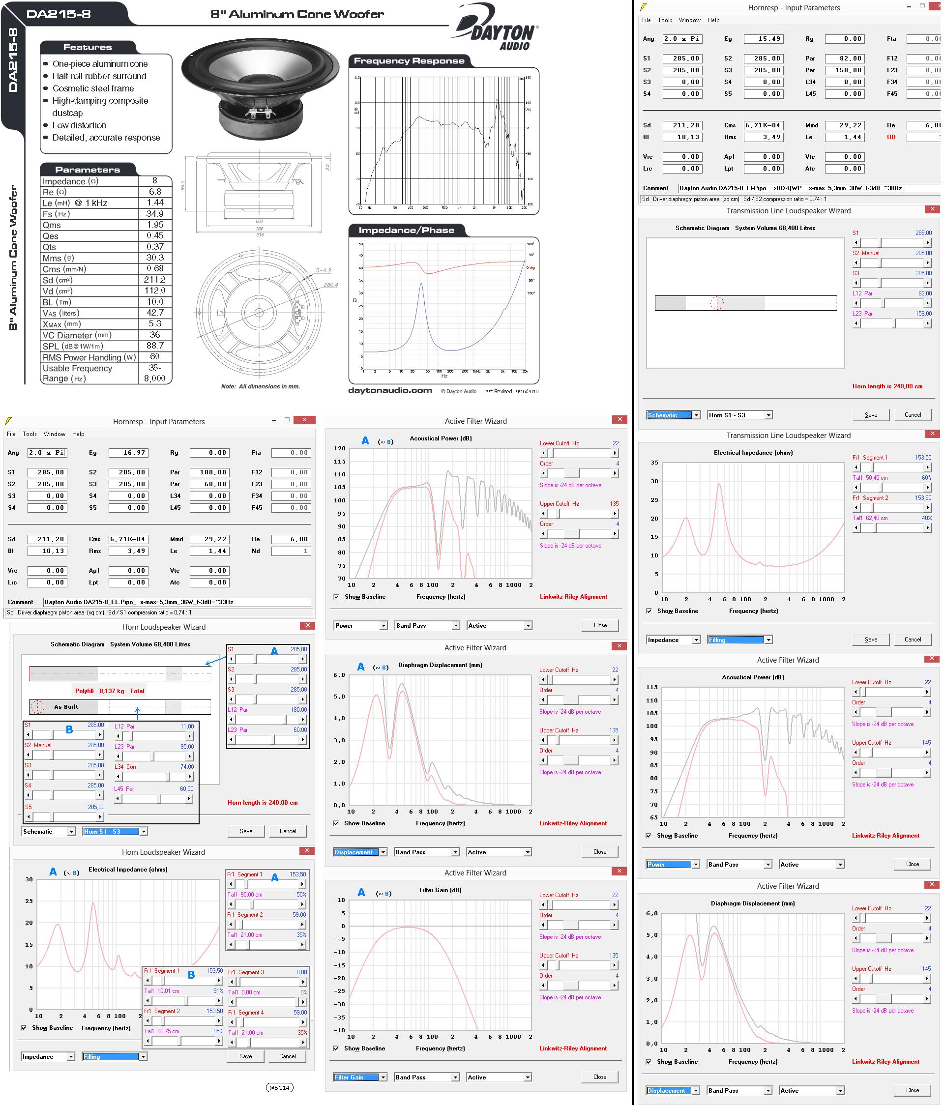

Hi Zilla,
Have a look at the submitted Pictures:
b:)
