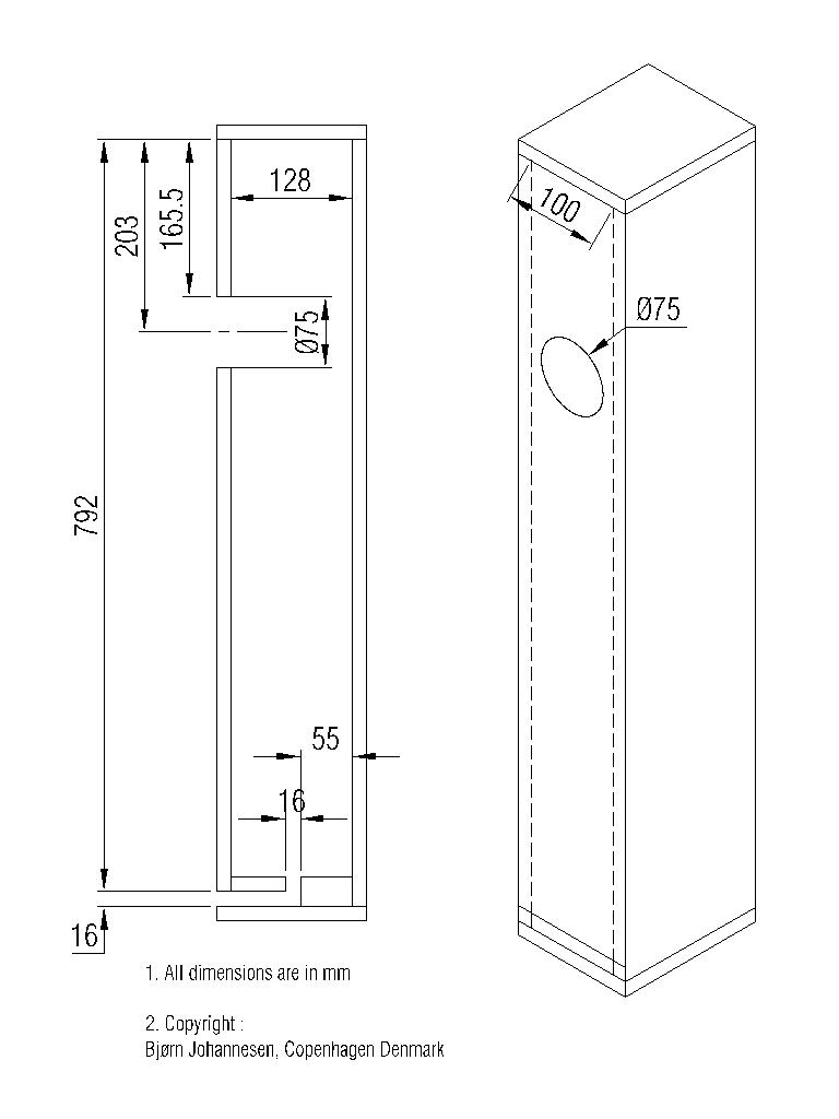

The drawing is a little confusing. What are the port dimensions?
9.7cm.
Original design has the port running flat along the floor of the enclosure. Leaving a narrowed part at the rear. This acts to lower port tuning below that intended, I believe.
The new arrangement bends the port up through the middle of the enclosure more accurately match the model.
The square area under the "5.5cm" is a box/right angle of ply/mdf to form the rear port wall and bottom of the main enclosure.

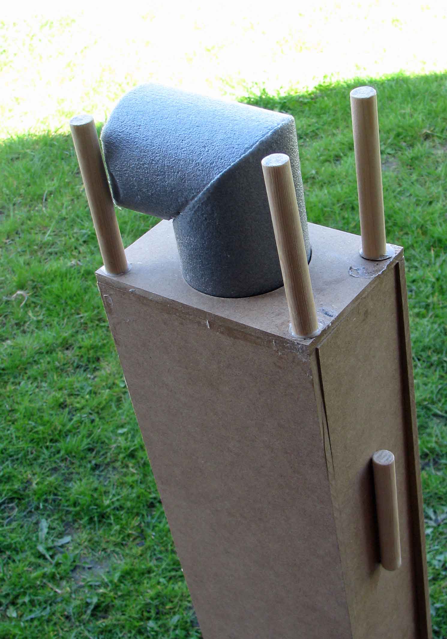

Innovative ideaThis also a way to make the port. Made by a foam insulation tube.
Hope this will clarify how the port is ment to be. I used this to test stuffing as the back panel was easy to remove as you can see.

Here it is !By the way, I'll make a simplified drawing of my understanding of the enclosure when I get back from work. And I hope it would clear any doubts in this matter.
Would also post a BOM.
Please comment.
So, the drawing is OK, right ?Keep it at 10cm.
Here it is !
Please comment.
That's what I was looking for.
Thanks.

I ordered some W4-1052SD today and plan to build a pair of TABAQs.
I plan to build it using 19mm mdf since that's what I have at hand. I guess that's fine as long as the internal dimensions are correct.
Then I started thinking about the port I guess it will be longer if I use 19mm mdf on the part marked on the sketch. Do I have to use 12mm here to get correct port lenght and volume or is it ok with 19mm?
