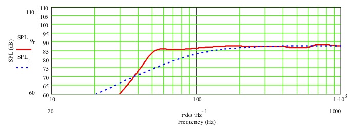

Are there any TangBand 3" drivers that are not suited for the TABAQ and should be avoided?
Which of the 3" drivers would be the most bass strong among the TangBands? (not including the extra super expensive w3 1878) would the Vifa TG9FD 10 04 be stronger because it's slightly bigger?
What about Xmax, some of the models used in TABAQ had only 0.5 mm, awfully small, isn't that a problem?
Hi Krakatoa,
TABAQ was desinged for the TB 3" 315SC which has a high Ots of 0.64. This makes it possible to get much lower bass than expected for the drivers relatively high Fs. You can use any TB 3" - or other 3" drivers - as long as the Qts is not much lower than the 0.64.
For drivers with a lower Fs than 100 Hz, the Qts can be lower. This is the reason TABAQ works very well with the 4" TB drivers.
I must admit I have also considered the Vifa TG9FD, I have enclosed a simulation of this driver which you might find useful :)
Hi from Bjorn

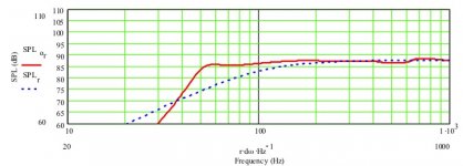

Hi Bjohansen:
Im thinking to build some satellites for my HT with your Tabaq design with the Tang Band W3 881SI, the Qts that shows the spec sheet from I got from Tang band its says a Qts of 0.59. the Fs is 100Hz... Would you recommend the Tabaq TL for this drivers!?.
Thanks!!!
PD: I think this will help a lot of people that bought this drivers from the PE buyout, and still doubting like me wich design to use.
Hi Danzz, you can start building your First TABAQ, the driver is doing very well. I have attached the MJK simulation.
For this driver i would definitely recomend to use the BSC, as the driver has a slight peak in the top already. Something that will get worse caused by the baffle step. Therefore: Use the 3,9 ohm and 1.0 mH in parallel.
Have fun !
Bjorn

Thank you very much!!!!...
Little doubt... The resistence and the inductor in parallel but I guess that in series with the +, right!?...
