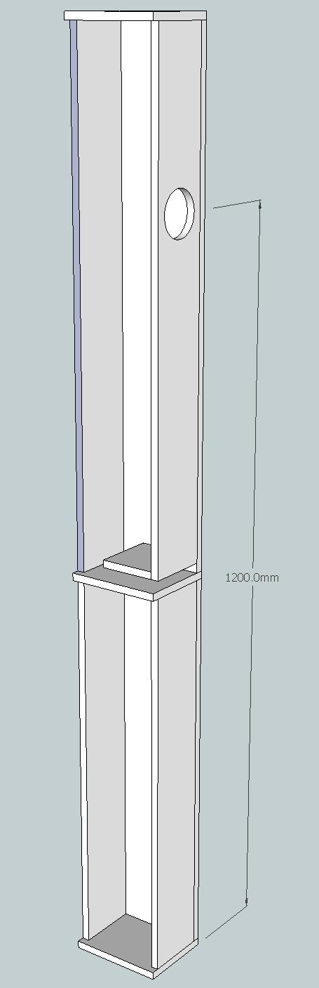

I'm interested in building my first fullrange speakers & the tabaq seems like a good place to start as the cabinet is very simple & has only 90 degree cuts etc.
However my normal listening position is sat at my desk, so I would need them to be much taller to bring the drivers to ear level, otherwise they'll be playing music into my legs! Can I simply extend the cabinet like in the attached picture, filling the bottom part with sand for stability/damping? I know that design is probably not the best (I could use single long pieces for the sides/back) but I'm just toying with ideas atm.
That'd be a lot of sand, or any type of ballast, and I'd imagine with that very small footprint that they'd still be a bit tippy - so add a wider base plate
Even better perhaps - would it be possible to mount the shorter cabinets on the wall? Using lighter materials such as a decent plywood or solid pine, etc, they'd probably be light enough that a small bracket or pair of hooks would suffice.
I probably wouldn't fill the bases entirely with sand, just enough to keep them stable - as you say a larger base will be a very sensible idea as well & will reduce the amount of ballast needed to keep them stable enough anyway. I can't mount them to the wall as I rent the flat so can't drill holes into the walls :(

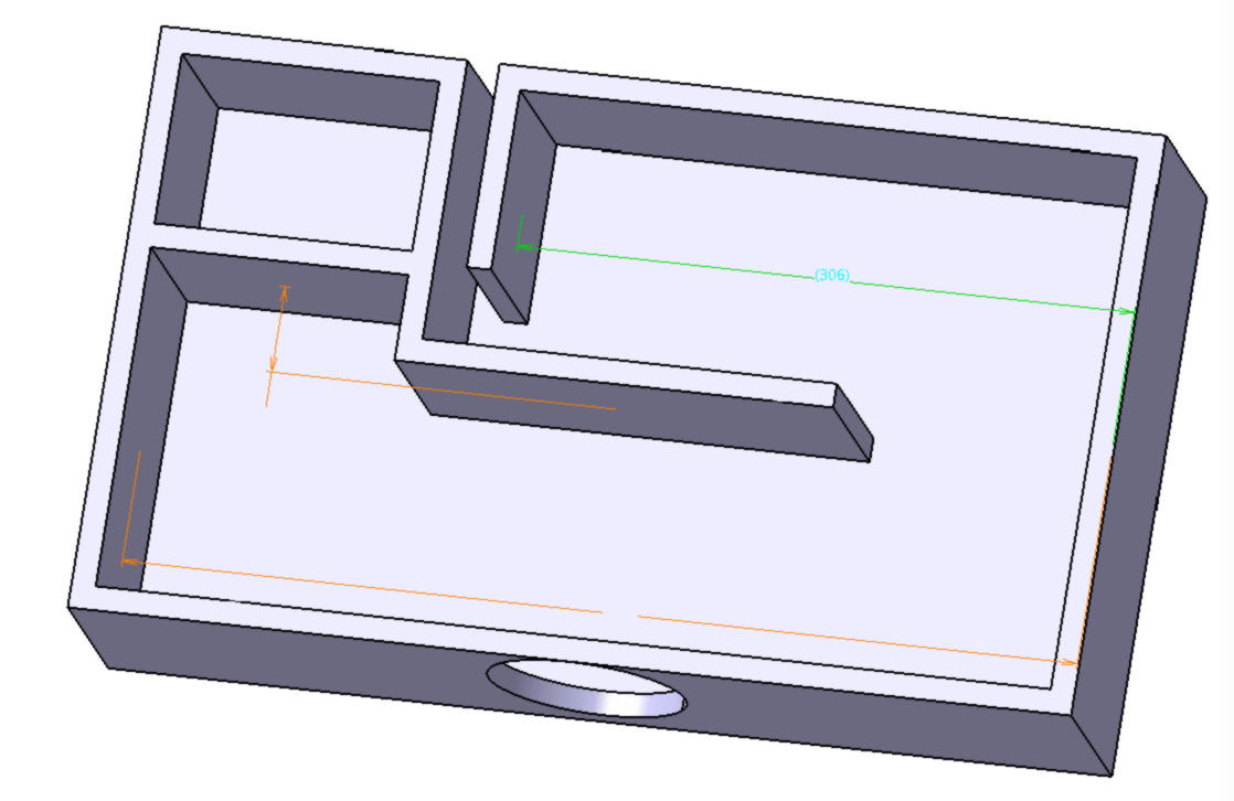

I did some changes to make a center speaker, too. I attached the current 3D-model. Could you have a look at it? It looks a little different to your approach. But the TB is in the middle of the front face an the volume should be nearly the same than original TABAQ.
I used 12mm (MDF) wall thickness. I think I can make a little sketch with all the measures.
As the measures are not all readable: The long area is 458 mm long, the short corner is 51 mm and the rear chamber is 290 mm (306 mm as in the picture is not correct).

Hi bAD, to be able to comment on your design, it has to be simulated by MJK´s software. As far as I can see, your design differs from a folded TABAQ. However, this is not neccesarly a bad thing.
You were right. I wasn't aware of the corners. I revised the design of the center and it looks a little different now. I attached a cut through with the measures and components of the length of the line. It should be better now.
