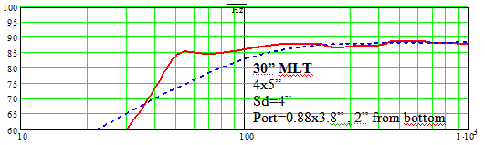

The square port gets mighty thin. Stretch it across the 4" face and you end up with a height of 5/32".
Just for grins, here's a drawing of both the round and square port versions. I took the liberty of putting a base on the bottom to both bring the drivers up closer to ear height and to make less prone to being toppled. Maybe a nice plinth is in order here.
