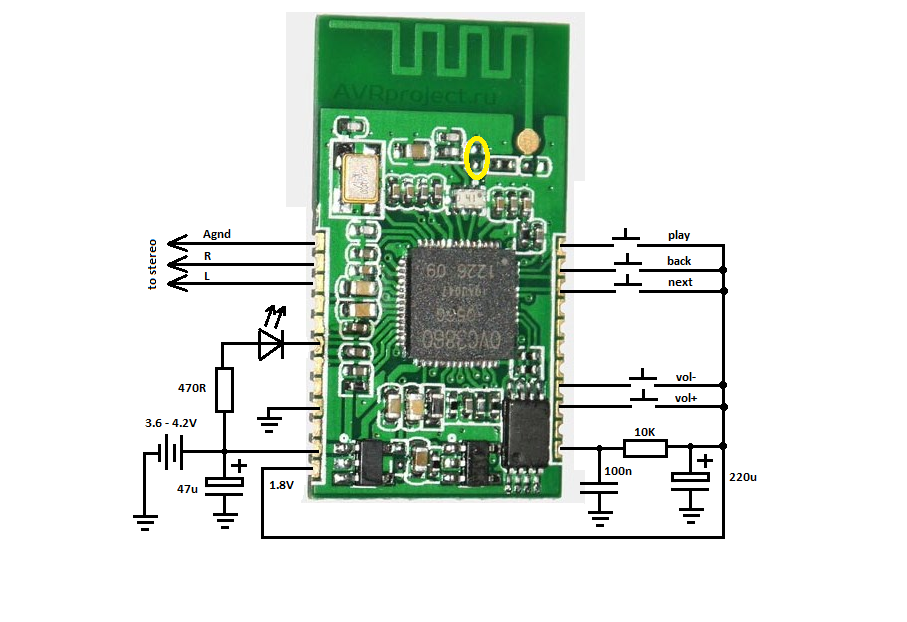

I'm building a Bluetooth portable speaker as well but I have a problem with Bluetooth module. Has any of you used XS3868 module? I choosed it because it's cheap and looks great (having keys and battery charging onboard).
I connected it according to the schematic in attachment. When I connect it to power supply it produces a sound that it's turned on but mobile phones or other BT devices can't find it.
First, I connected it to a DC-DC converter giving 3.7 volts. 3 seconds after turning it on, the DC-DC converter started to produce some strange sounds and the chip on BT module got very hot. Then I tried to connect it to a 3.7 V battery from a mobile phone but still it doesn't work.
My first try was on a proto board but then I tried to solder it to a real board but it still doesn't work. My phone can't find it. I tried without keys and without these capacitors and resistor but nothing.
Is it fried or something?
