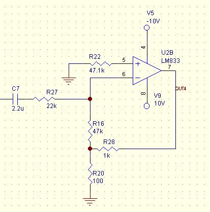

Have you tried a compromise like the one on the sch. I'm attaching here? That should be better if the high input Z is not as important as in the old post bellow. The DC gain is only 10 (or 5) instead of 100, thus matching R16 and R22 is 10 times less critical. The rest of the gain comes from R16/R27 (on the attached sch). So you get reasonable NFB resistor of 47k and a good DC offset.
Ignore the OPAMP type, please. It was for simulation purposes only.

GregGC said:Have you tried a compromise like the one on the sch. I'm attaching here? That should be better if the high input Z is not as important as in the old post bellow. The DC gain is only 10 (or 5) instead of 100, thus matching R16 and R22 is 10 times less critical. The rest of the gain comes from R16/R27 (on the attached sch). So you get reasonable NFB resistor of 47k and a good DC offset.
/Greg

Sorry, but no, it potentially gives you worse DC offsets (note the plural).
The problem is that your 'reasonable' 47K has been tried and gives rises to DC shifts due to chip input imbalances. It needs to be a lot lower than that and 10K is a better compromise.
Yes, you can go for the lower DC gain, but (don't you just hate that word) it means in your case increasing the R (R16 in your sch) from the (-) input to the "T" junction. Keeping the DC gain around 100:1 (10K/100R) enables us to lower the that R to 10K which is better able to cope with input offset curents and voltages when they are not close to ideal. They are more often than not, but we need to present a consistent solution.
It's not the typical values that are of concern. The Max values means the 3875 is still within spec. NS have covered themselves nicely. Your values would deal very well with the typical, but I have here a couple that are not typical and they will blow out the DC parameters. 47K is too high. Think about it, if this was zero, the input difference in current (the offset) would not make any difference. That's not practical, but it shows it needs to be low value. The larger the value the greater the difference will get magnified by the apparent closed loop gain. It goes then that your DC gain has to go high to 100 match.
I have now done 6 channels (chips) using 22K In/10K-100R-10K/10K on (+), and so far all have been under 50mV. When others try that combination of values, we will be able to find whether we have limited DC Offset to below or around 50mV with a larger sample. The spread that I got below 50mV is significant, ranging from 6mV to 38mV so far. Time will tell whether we have a consistent solution.
