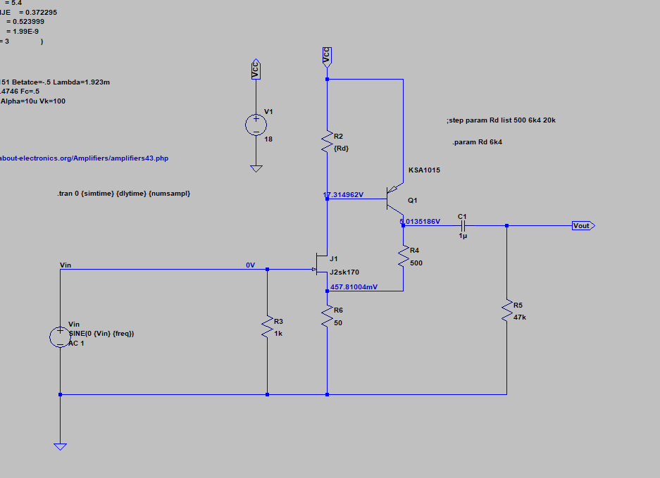

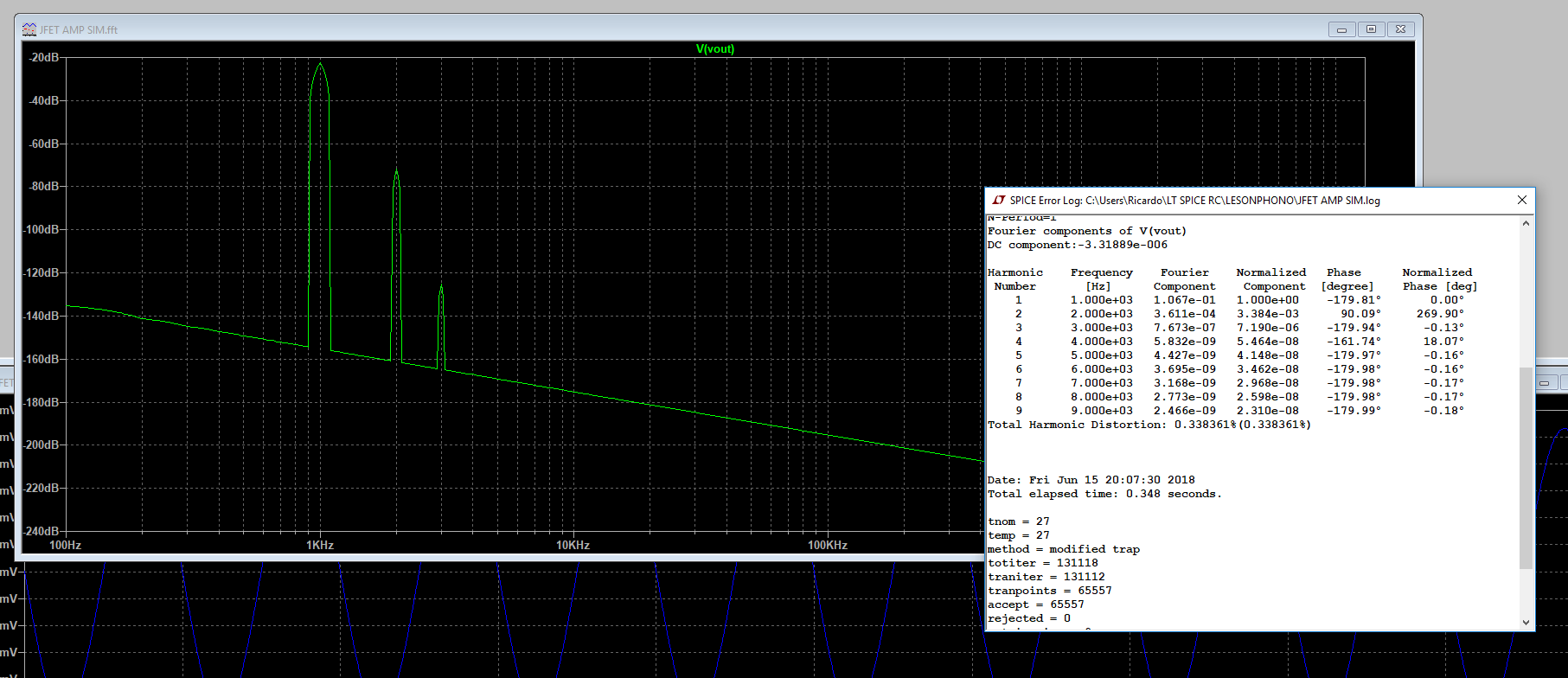

I am currently building a phono stage and need a circuit to replace the usual 10x SUT so I can feed the rig with a MC cartridge.
After lots of reading I found the Sziklai pair (JFET + BJT) that can do the job.

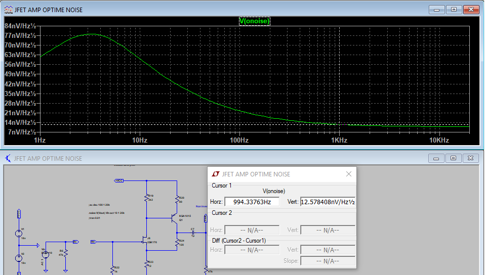

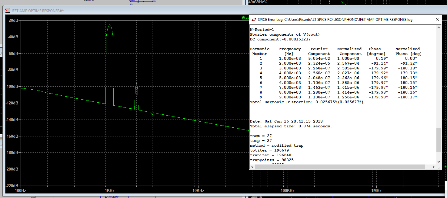

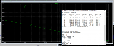

My simulations show outstanding results as far as THD goes but I am wondering why the best results are obtained only if using minimal current throu the jfet.
R2 sets the current on the jfet so if I use R2 = 500 I have 1.3mA Ids but THD is 0.047%
When using R2 = 6400 I only have 0.147mA Ids but THD goes down to a minimum of 0.002%
I know that for best results I should run the jfet near it's Idss (8mA) but in this case the simulation seems to indicate quite a different result.
Now the question is: How low can I run Ids in the input jfet ?
Looking forward for your input
Best
Ricardo

...I know that for best results I should run the jfet near it's Idss (8mA) but in this case the simulation seems to ...
Why?
This is a feedback amp. Higher internal gain will lead to lower simulated distortion. Gain will peak around the point that JFET current is slightly higher than PNP's Base current. Which is near what you report.
Why worry about distortion? The MOST you could ask out of it is like 100mV; anything more will clip your MM-input phono stage. So 10mV input at-most. THD is likely to be below point-oh for almost any working condition.
*HISS* may be lower at high JFET current. However as drawn the hiss level is the 50 Ohm resistor, not the unavoidable ~~10 Ohms of the MC cartridge, so not "optimum hiss".

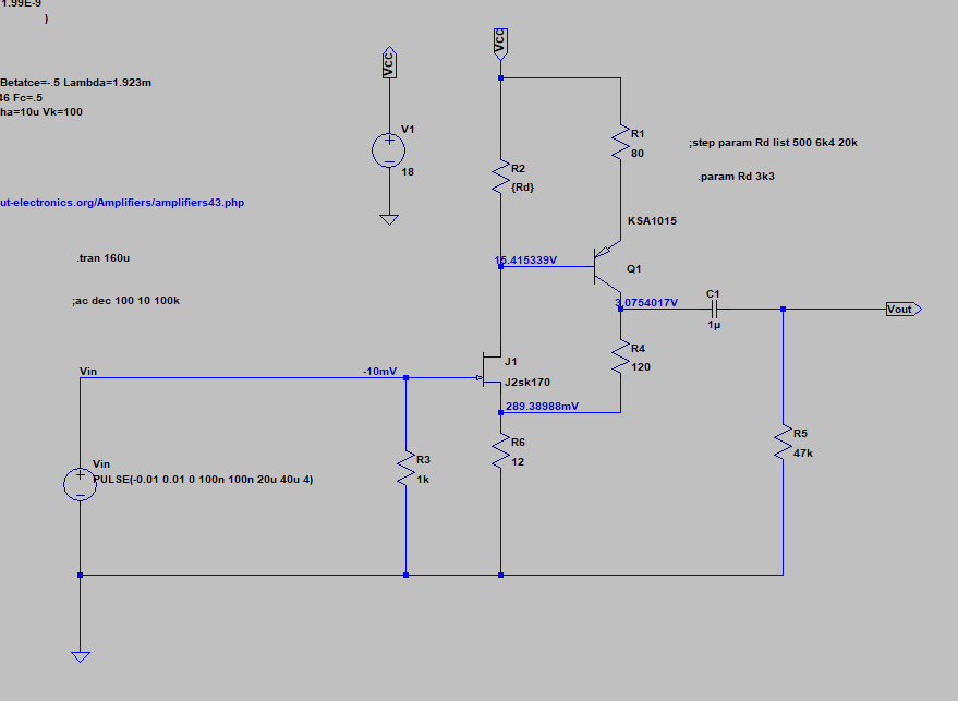

You "could" reduce R4 R6 to 100r and 10r, get the hiss down. To take full advantage you want to run the JFET a lot warmer than 0.15mA, near 1mA. However the higher current seems excessive. But actually the operating point is NOT well-defined, being the Vgs of the JFET at some small current.
I am uncomfortable (and unsure) about 16V across the JFET. Gate leakage (hiss) increases. Since the gate circuit is super low impedance this may not matter. However I think the thing could eat 5V not 18V.

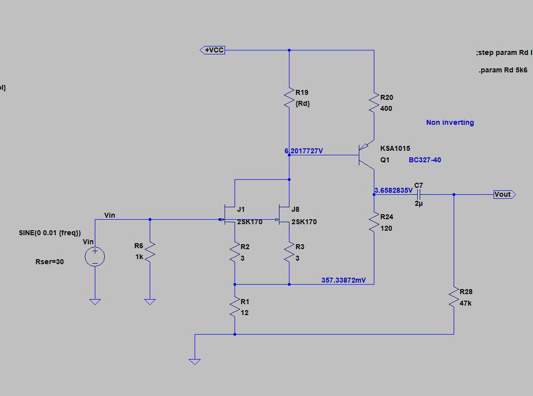

I added one jfet so to have higher current and so I could raise Rd to 5k6 reducing THD.
The resistor arrangement on the sources of the jfets is peculiar.... comments are welcome
