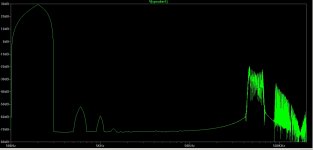

I was not satisfied with the performance of my 320kHz design and at the same time I was not happy with the 400kHz version which would chase IRFP4668 at 400kHz/160V/60A hard switched.
In the mean time I have settled a new adjustment which is fitting mostly my taste.
It has a comfortable idle switching frequency around 320kHz, good step response and bandwidth around 80kHz.

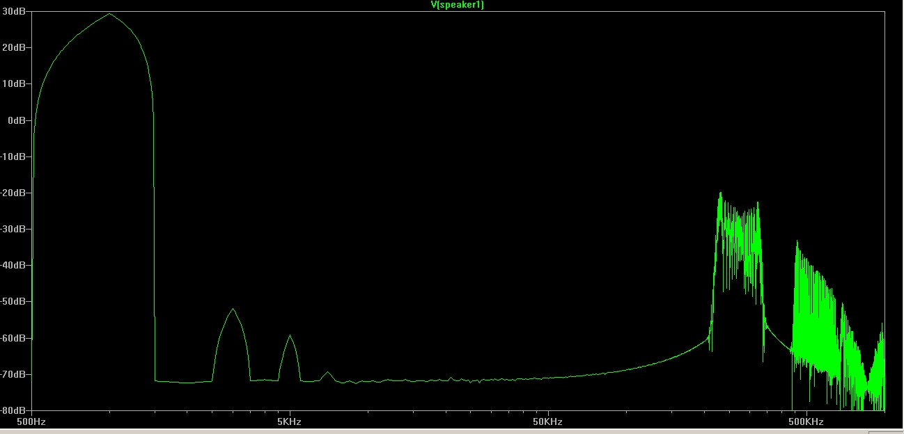

Harmonics at 400W/2R are in the -80db range, means further optimization by simulation would be completely meaningless, because in this range simulation and reality typically differ already pretty much.
Output voltage ripple is slightly below 500mVrms during idle.
No lunch for free.
These selfoscillating topologies are a tight knot in it self. No matter what you change, all other parameters change as well. Swichting frequency, loop gain, carrier shape, output ripple, step response...

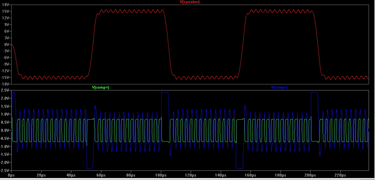

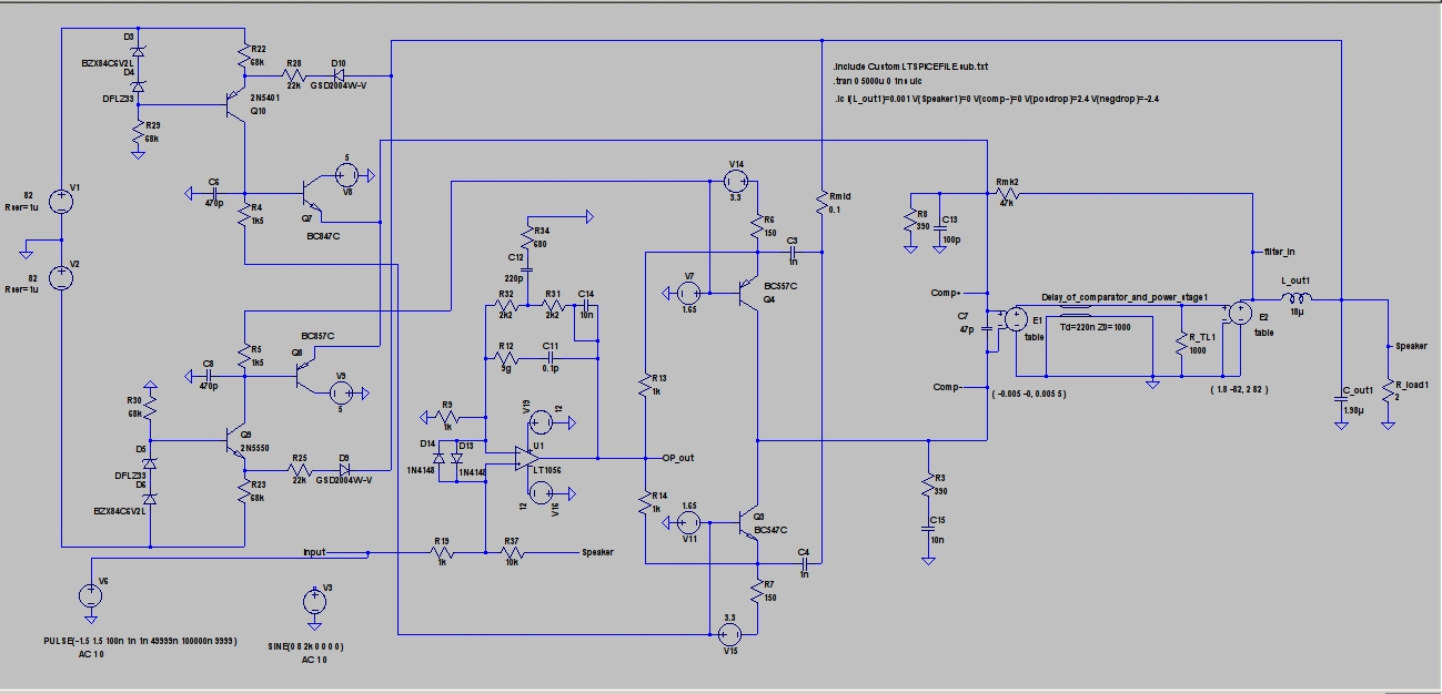

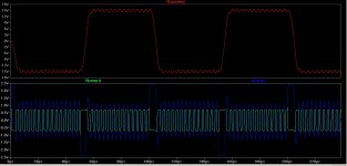

Achieving overall good results with 320kHz does consequently lead me to a design with higher output filter inductance. 18uH.
Ok, that's not really high and for ripple current load of the e-caps this is even fortunate .
The downside of this higher inductance value is that it impacts the physical size of the output inductor and it also limits the power bandwidth of the amp.
The new adjustment has a bandwidth of 80kHz, but the high filter inductance is limiting the -3db power bandwidth to approx 24kHz (into 2R), which is just acceptable. Well, my intended MKP2 filter caps will also be close to melt down (at least running beyond spec), when applying something like 20kHz with full power as continuous load...
Attached the updated circuit and some simulation results. Please note the harmonics where derived from a more extensive simulation, which includes a switching stage with IRFP4668.

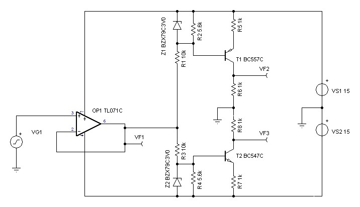

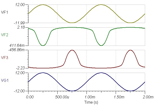

Brilliant, the threshold could be set very easily thru symmetric current sources/mirrors.:)
Here is a TINA SPICE sim of an opamp with symmetric voltage controlled current sources. The Zener diodes clamp the VCVS so they only change the output current when the output signal approaches the rail. With suitable component values, something similar to this might be able to provide the upper and lower threshold voltages for my 'Window Comparator plus S-R latch' acting as the PWM modulator.

The op-amp is only there to provide a suitable sine-wave signal to demonstrate the concept, but I think that a similar pair of voltage controlled current sources could monitor the output of a class-D amp to provide the threshold voltages for the comparator.
If the window comparator technique can work with only changing one of the threshold voltages at a time (according to if the output waveform was approaching the +ve or -ve rail), then the voltage outputs from my simple circuit above might be able to be used directly.

... have a look to Q9 and Q10 in posting #3.
They form a pair of current sources, which are monitoring the output of the class D amp.
Main difference is that I had chosen to run the BJTs in common base connection, because I do not need high gain in these controlled current sources, but appreciate linearity and speed.... and for my method of directly controlling the modulator thresholds with Q7 and Q8 also the signal polarity was fortunate.
