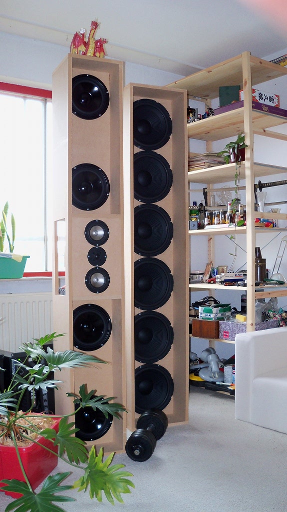

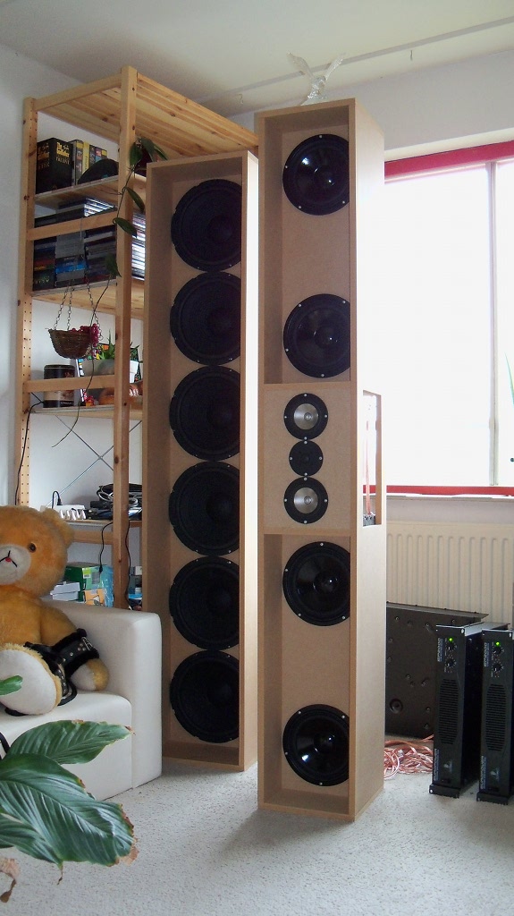

Presenting The Gate
Picked up my camera today so I can finally present my own humble creation in its current raw form (and prove my level of insanity):
Mains: 3.5 way WWMT/TMWW, 190x28x28 cm, part H, part (shallow) U frame,
2x G 20 SC, 2x TI 100, 4x W 200 S, crossover points (LR 4th) 2300, 243 Hz with top and bottom woofer rolled off 30 dB at 243 Hz/12 dB slope.
Subs: 190x35x35 cm H frame, 6x W 300 connected per 3 in parallel, crossoverpoint (LR 4th) 50 Hz between mains and subs when in use, otherwise the mains run full range.

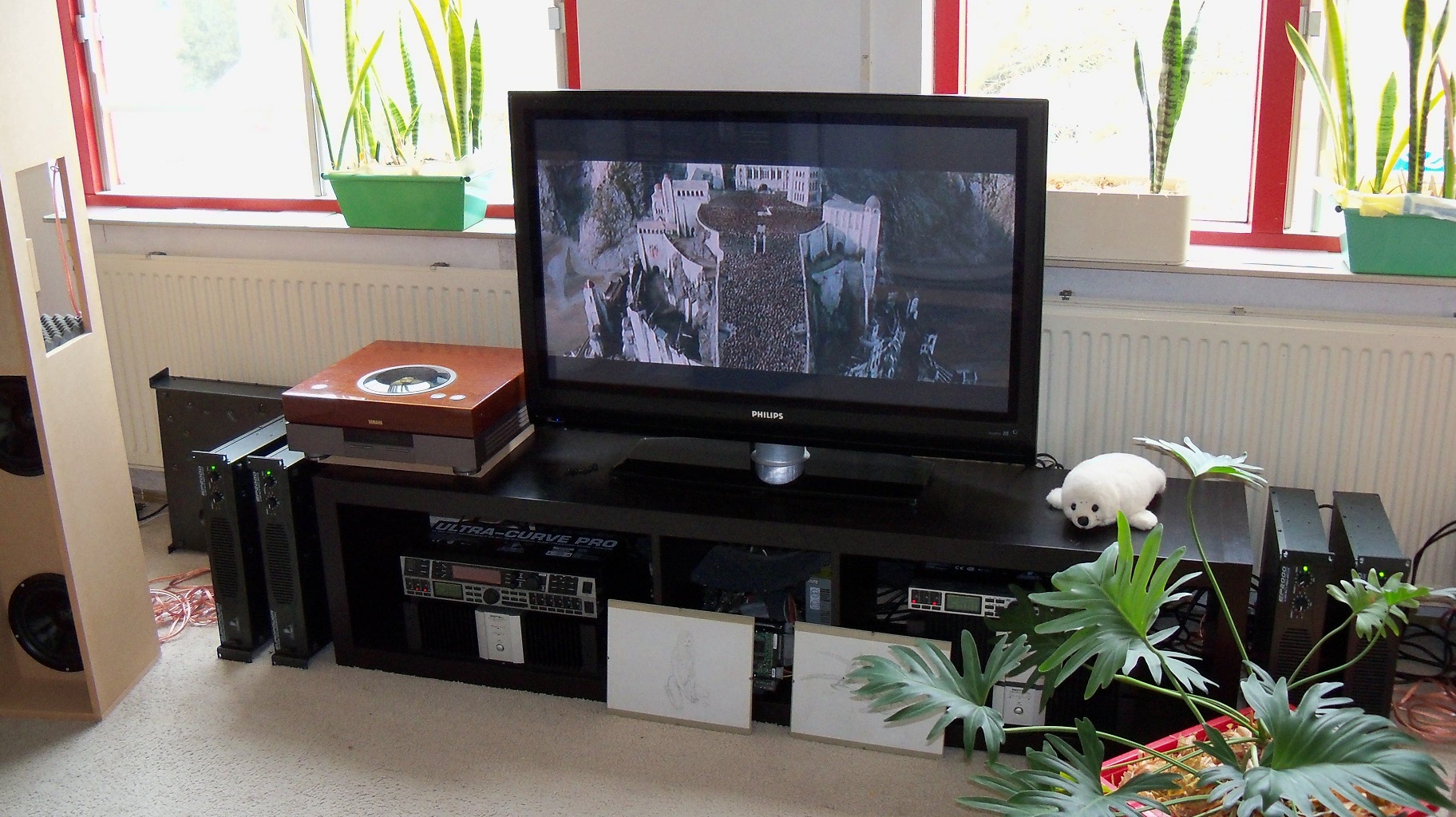

TV: Philips 42" plasma (used only for watching (ripped) movies/series, cable content holds nothing of interest for me)
Source: VIA Eden Mini-ITX based mediaserver with Terratec Aureon 5.1 soundcard; OS: FreeBSD 7; player: good ol' XMMS and Xine. The Yamaha GT-CD1 (one of the very few original 220V versions) needs a replacement drivebelt for the lens transport first, then I'll look into getting a nice pre-amplifier.
Processing: Behringer DEQ2496 for room equalizing, connected with digital out to 2 DCX2496'. Outputs are configured for sub, sub, low, low/low-mid, mid, high and time aligned.
Power amps: (per side) 1x Behringer EP4000 in stereo for sub, 2x Behringer EP2000 for main (all with combined silent fan and resistor mods).
Planned finishing: all edges rounded, front and inside behind mid/tweeters white felt, complete frames white high gloss paint.
Sound: Depending on the quality of the recording a deep and wide soundstage, very realistic and detailed (often up to the point where I suddenly hear more faint noises in the recorded background), tight and deep open baffle bass not fazed by the cannons from Overture 1812 :D.

I can't believe nobody else is commenting, it looks like a dream setup to me!
Sometimes people are just left speechless. :p
(happens more often with me, but usually there's mention of straightjackets soon after :spin:)
Sorry, off watching the olympics and doing an earthquake and tsunami watch. Busy day. Yes, that is truly something James. I love your humble creation.
Thanks! :)
Btw, if you spot seismic activity in the south of the Netherlands, my apologies. I'll turn the volume down. :eek:
