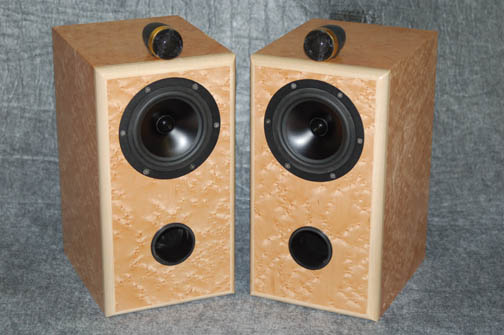

Hi guys,
Here are my recently finished speakers, the first time I have attempted anything like this!!
They use Hi-vi d6.8 drivers and Hi-vi sd1.1A tweeters
18mm MDF with internal brace,
Bi-amped with 2 x peter daniel 3875 kits + Rod Ellliot active x-over ~ 2.2Khz (more info in chip amp gallery)
Using precision port, 13 Litre enclosure tuned to 44Hz
OregonDV spikes,
Still deciding what finish to eventually do on the green mertyl veneer.
Regards and thanks for all your help:

Looks awesome, probably took many many months to build!

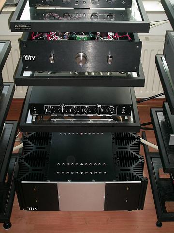

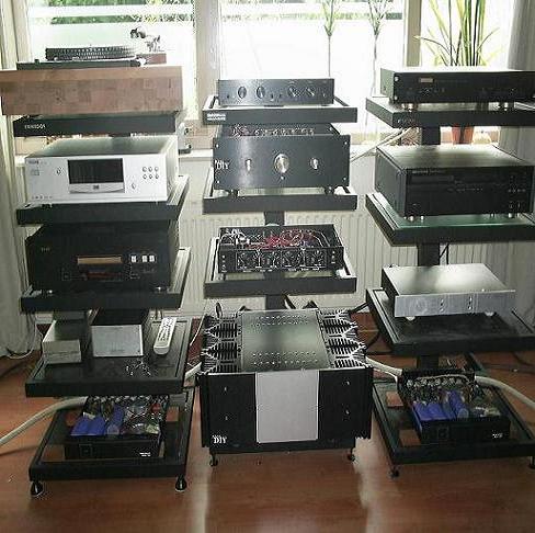

intense-tavda said:My stuff
I like your style... speakers look kinda familiar, bet they have an extraordinary sound stage...
http://www.diyaudio.com/forums/showthread.php?s=&threadid=23208&perpage=40&pagenumber=29
John L.

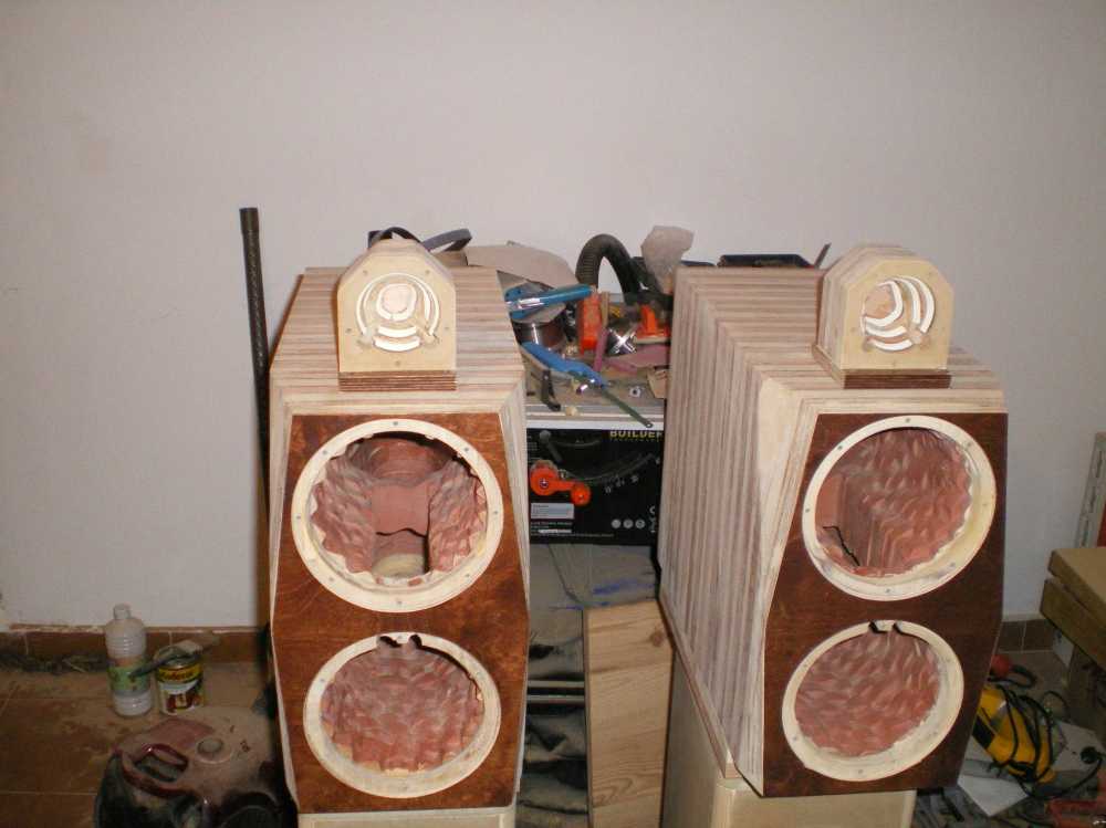

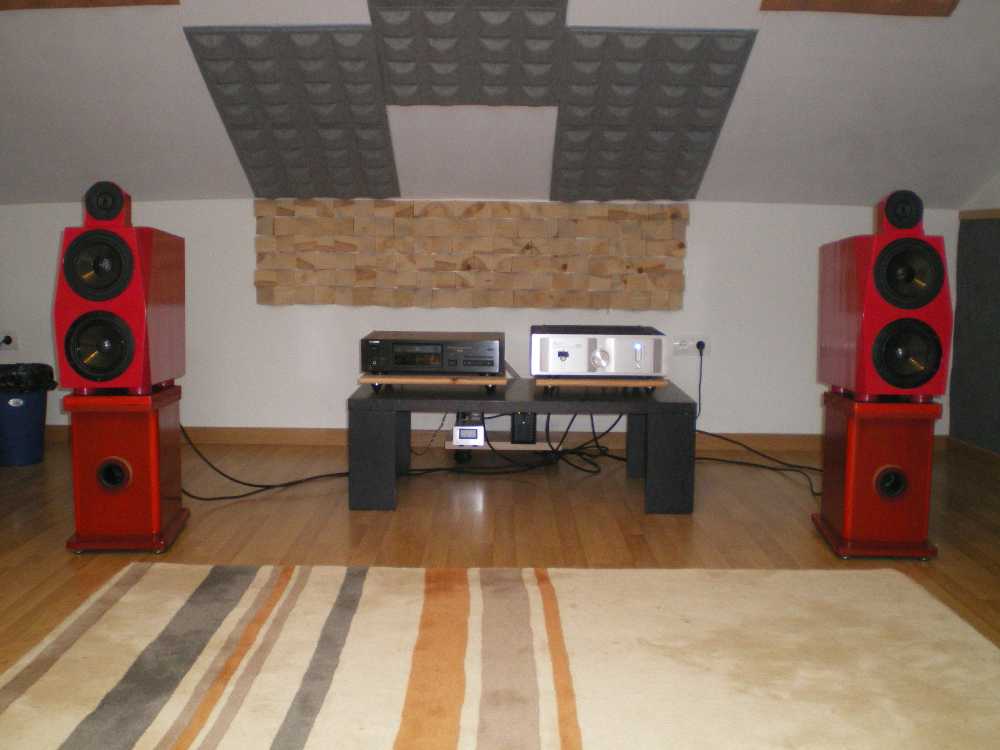

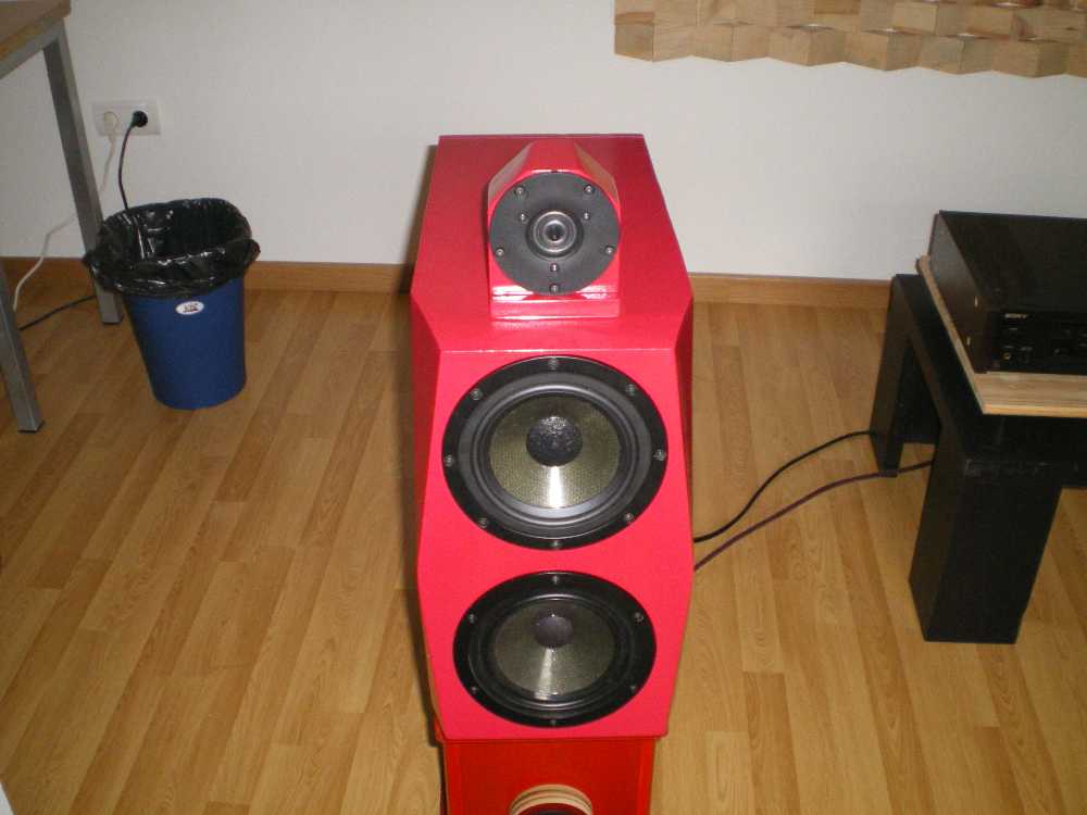

luiluilui said:And the last one.
I'm searching for a good crossover design for my proyect : Vifa XT300 KS/4+ Dayton RS52+ 2xEton 7-360 Hex. Any suggestion?
Clean & Sexy, i like that alot, yet so simple too. GREAT WORK!

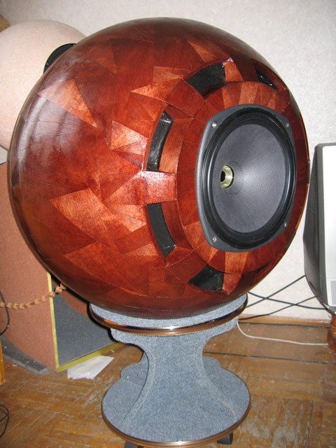

Hi, guys.
This is my last project Onken in sphere. Material MDF, 175 litres, diam 176mm. Designed for speaker Tannoy Dual Concentric 12''.
More pics here-> http://public.fotki.com/igormak2
Two last alboms.
Hi, guys.
Two last alboms.
Re: FireBall
seriously interesting project, please accept this as a compliment:
"you're a crazy-man"
is that last project as in "never again, that nearly killed me", or "just catching my breath 'til the next inspiration"?
igormak said:Hi, guys.
Two last alboms.
