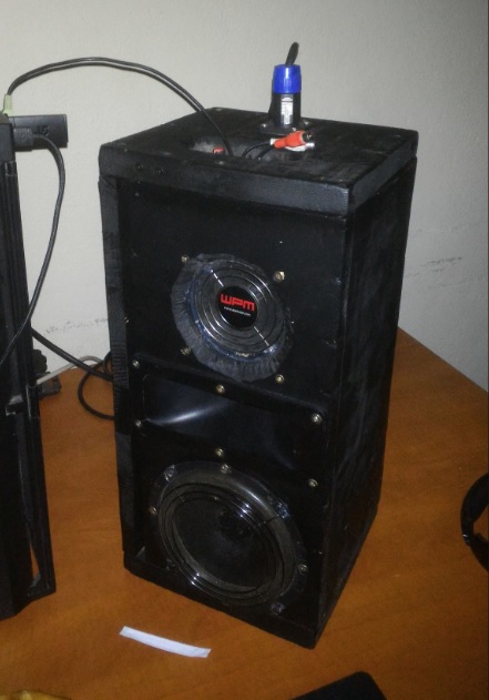

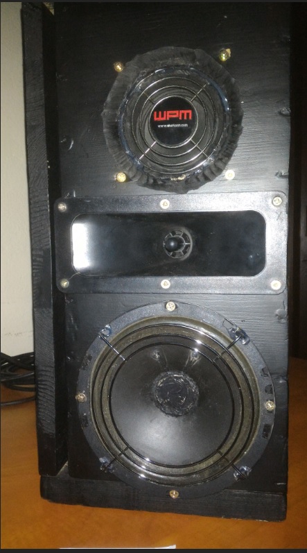

abomination made in good old diy spirit(from garbage xD), powered by slightly modified ebay tpa3116 2.1 and laptop psu. separate box for "midrange", piezo tweeter replaced with normal, car coax speaker with tweeter removed for bass.
:D:wrench: had fun making it, sounds interesting :boggled:

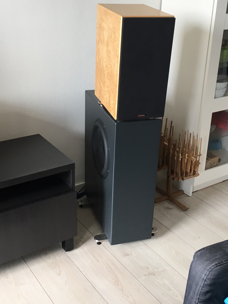

Much like my own system. I've built some speaker stands/subwoofers too, one on each front channel. Although they turned out a little too big. They might have been 10 - 15 cm lower in hight, or some 10 liter smaller in net volume.
They're an active sealed system, based around a Hypex nCore amp with DSP (11 biquads per amp channel) and a Peerless XXLS 12 driver. 41 liters net volume.
Mains are Dynaudio Special 25's, crossed over at 80Hz. Subs cross over at 120Hz. Integration between the two is phenomenal!
In theory the total system response should be flat to about 16Hz in room. Measurements cannot confirm that with certainty, but they do get pretty close to 20Hz with authority.
When I have enough time, I'll do some more measurements and tweaking.
