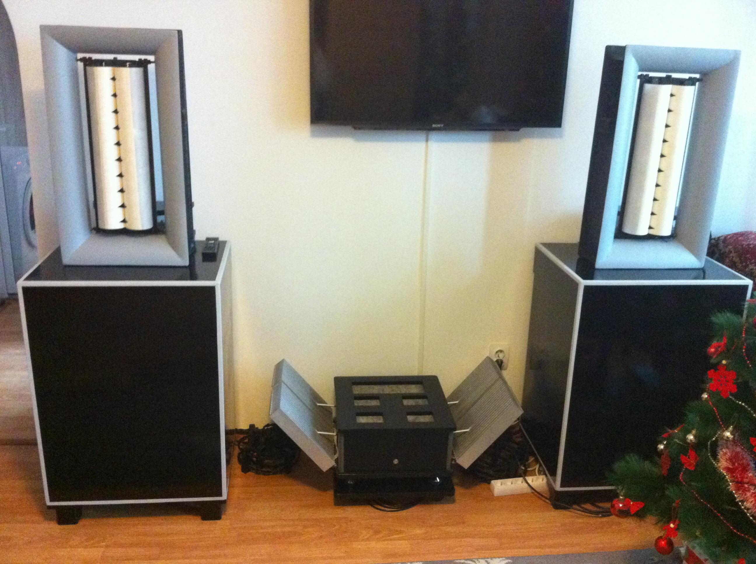

Hello and a happy new year to you all,

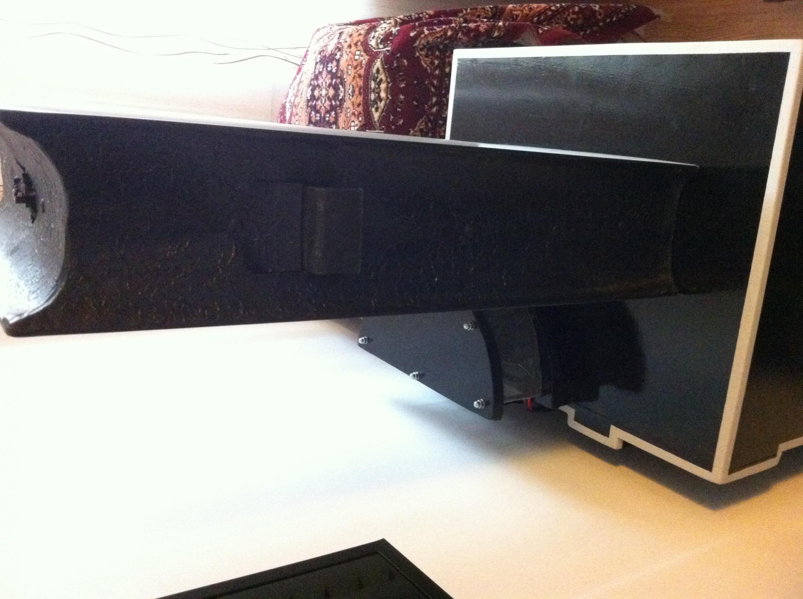

In december 2017, in my holidays i just finished my speakers, and forgot to post. Here are some pics with the finished rubas, bass, cables and filters.

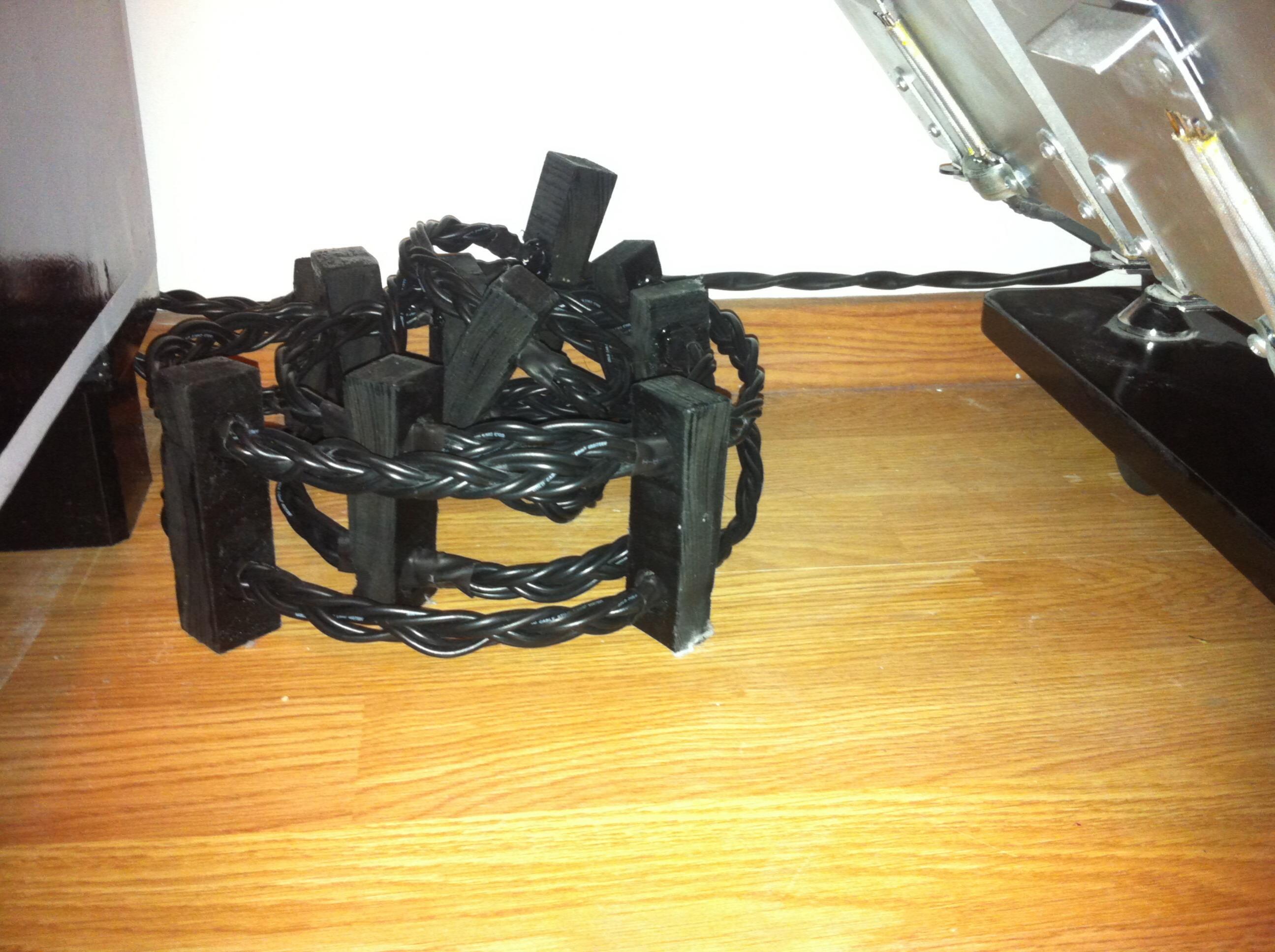

I added a burned wood effect on the sides of each ruban and aded some handles. Those speaker cables are 6*2.5mm wires twisted two by two, then braided and have 3m long, and the + and - are holded together by wooden supports at 10cm distance from each other. This may be overkill but i noticed that cables do affect the sound abit..
The filters are basically butterworth but fine tuned to eliminate the peak at 220hz (crossing point).
My version of rubans are almost fullrange and can go from 150hz to above 23khz (my soundcard cannot do more) have 50cm tall membrane and are almost 360 degree dispersion at 8ohm and aprox 95db each at 100w. The verticall dispersion is poor but can be improved with an easy trick (work in progress).
The bass cabinet is an infinte baffle type with 95db 15inch bass 8ohm at 100w each(down firing--i did take into account all the aspects needed for this) and goes bellow 40hz with ease.
The amplifier is my modified version of Hiraga super classe a rated at max 38w sinus at 8ohms.
Cheers
Sergiu

Those look nice! I’d like to know more of what a "Rubas" speaker is? You say it like it's a copy of some version of speaker. I did a quick search but nothing really came up
Rubanoide, Janus 50, Linaeum ls1000 (call it whatever you want) and my ruban are actually derived from a german speaker from between the ww1-ww2 period. In that period the first type of this speaker was invented and patented i think, and had 3 feet if i remember good. The first ruban had a classic magnet with a classic type round coil. The rest have a longitudinall flat coil imersed in a forcefull neodim magnetic field and other improvements.
My ruban is derived partially from janus (only the height) and partially from linaeum patents (inspiration for the cuts, hinges, and a ton of other aspects that i researched and tested in 'a diy ribon of a different kind' from planars and magnetics forum) and some small adds from myself (the antihumidity paper treatment, improvements for a balanced horizontal dispersion and high frecvency improvement). These aspects are just a small part of the work, the other huge part has been researched and posted by my friend Wrine who is still working silently on a flat almost fullrange ruban. :)
Basically this speaker is a dipole speaker where the membrane has no yellow spider its very light and can almost sustain itself centered in the magnetic field (it has only two thin elasticson top and botton, weak tensionned, to keep things safe and in place) and the front and back of the membrane if summed can make an almost 15" almost fullrange speaker.
