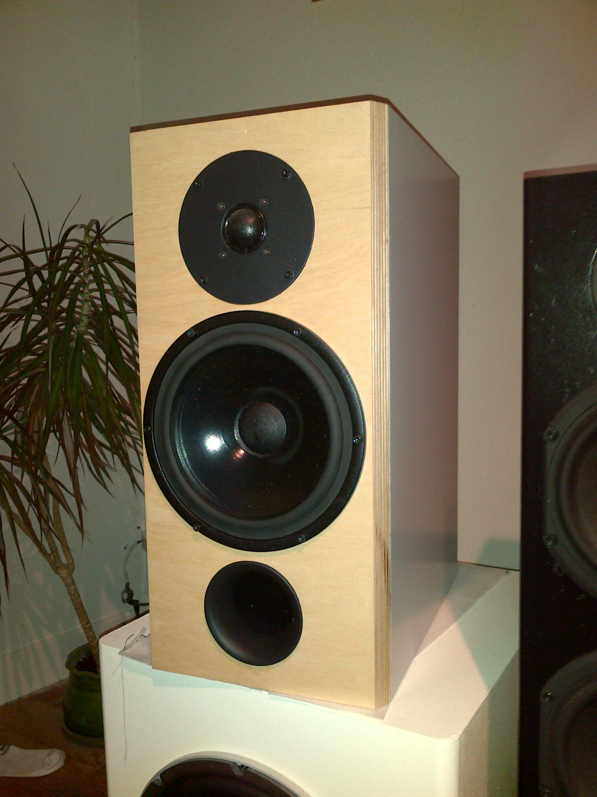

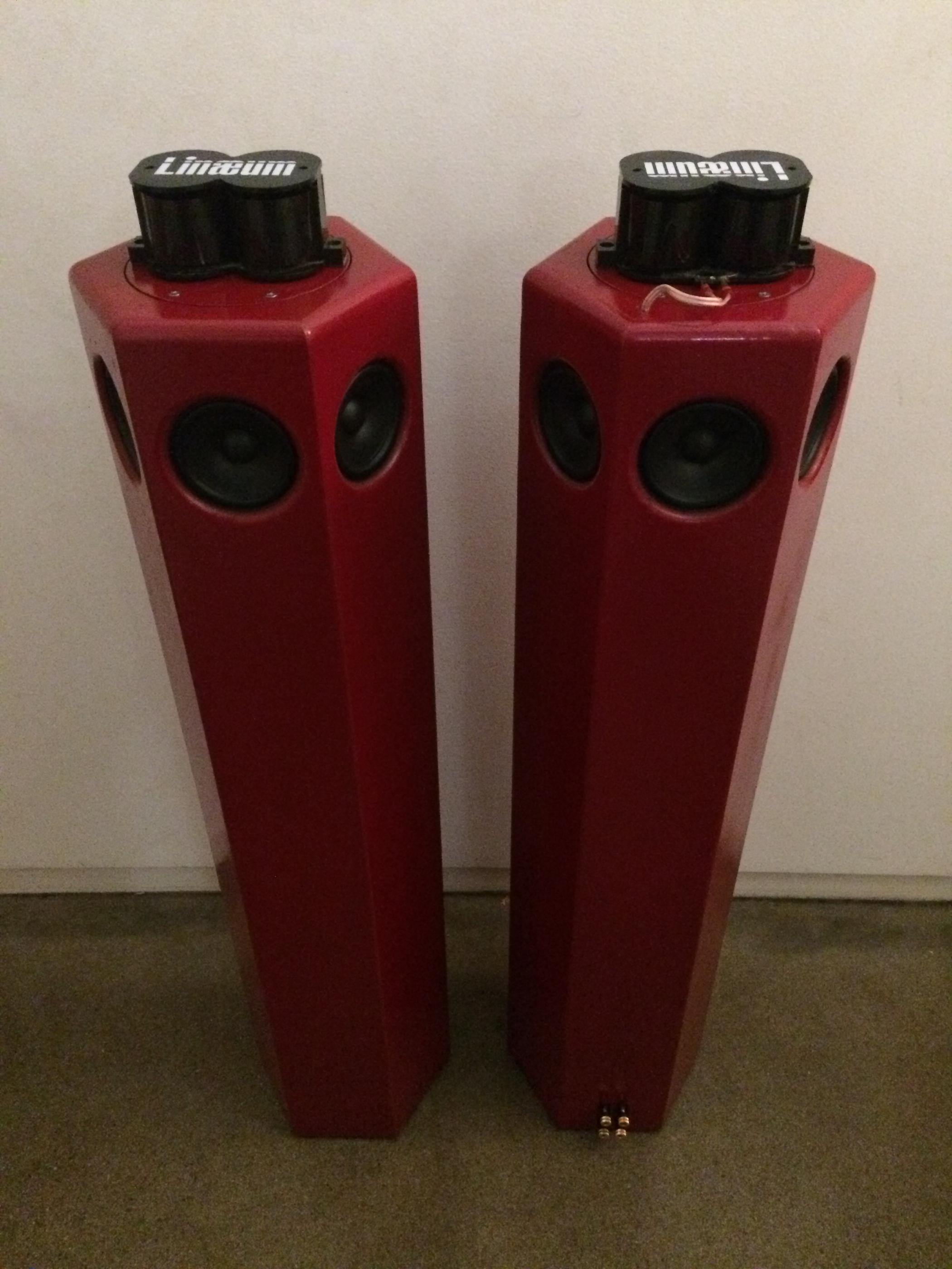

My new buid : Monitor mlII with Seas CA22RNY and Audax TW034 in a 35 l BR.
Crossover is LR24 accoustic at 2 kHz.
Design inspired by few others : Tired two way by Salas at diyaudio, Quattro by Troels Gravesen and Pro 21 Classic Monitor by Hobby Hifi. Many thanks to all of them.
6thPlanet : very nice project and build :)

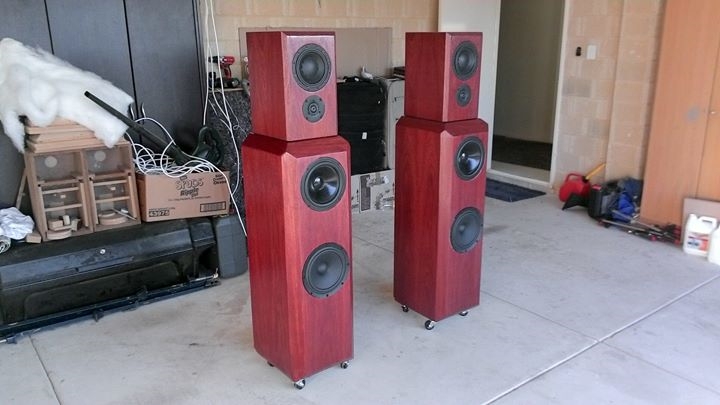

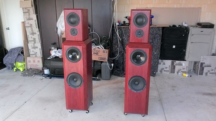

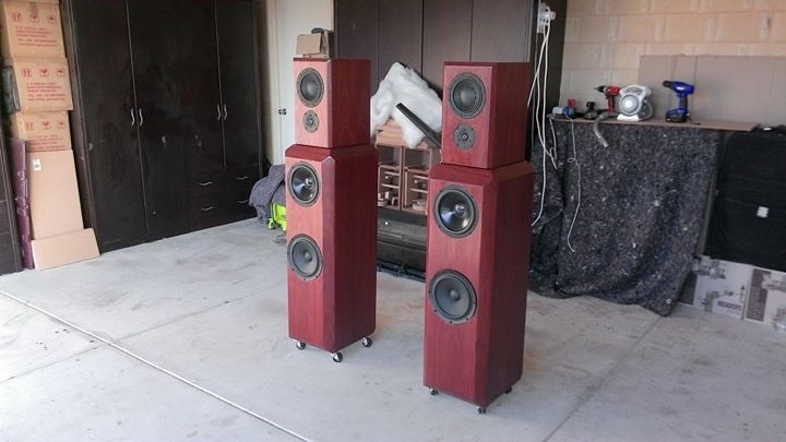

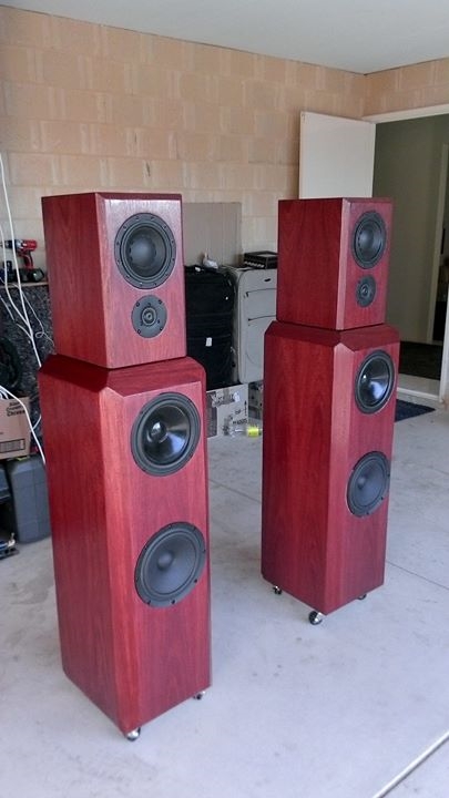

My latest effort.
SB Acoustics. Seas. Hi Vi mixture.
