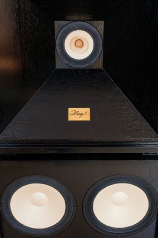

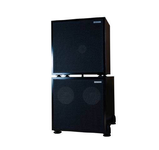

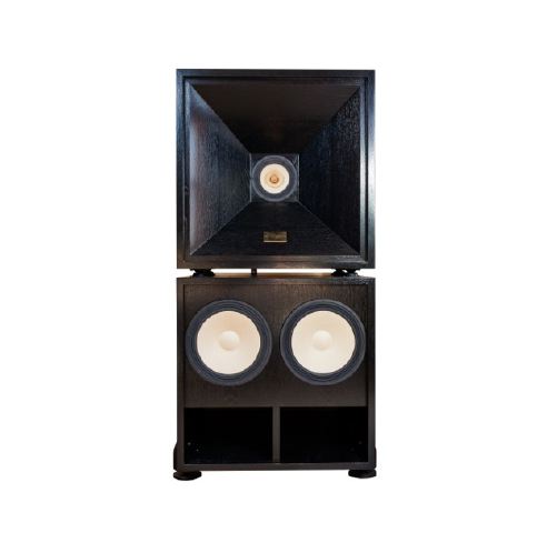

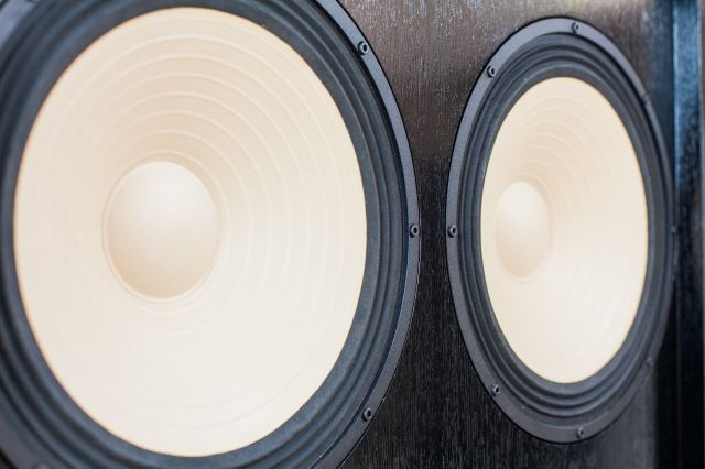

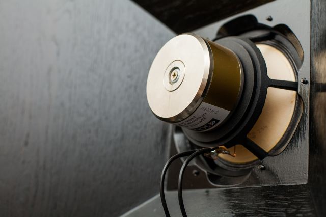

175 SFR sonido in symmetrical dipole horn (back the same loaded as front)
Double custom made 300swc-16 Sonido in bass labyrynth.
First order filters below 200hz. 95-96 db/watt in all working diapason. Drivers are well damped, even with more than 100 watts - was no obvious distorsion increase as it always happens with conventional fullranger implementations.
For big rooms and big life-like sound did not hier anything better.

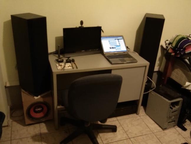

Organized and cleaned space in bedroom to make a mini recording studio. Someone gave me their AV receiver, so I moved my old receiver to power the passive monitors in the little studio system. Went in closet and dusted off the Boston Acoustics VR20 small floor standers and plugged them in as monitors running full range. I wanted to use my CR75 book shelves, but they measured less flat. Grabbed the sealed 10" Sony Xplode :gasp: (free!) sealed sub and connected it to old yamaha sub amp. It is a speaker stand on the left side. I was using it as a secondary sub in my main system. I unplugged the crappy 8" woofer from the yamaha box, and use it as a speaker stand on the right side.
This won't sound any better until I get digital eq/dsp/crossover. Also, I am learning more about building passive crossovers and I hope to tweak all the speakers I have BEFORE eq'ing them. I have also not done any room treatments, yet.
This system sounds really good so far considering my extremely limited budget, and a lot of the stuff was old and used :D Only thing new is the ART USB Dual Pre interface/mic preamp.
I have lots of speakers and drivers to play with. I have measuring equipment now, so when I can start learning more about passive crossovers I will play around with different combos to see what I like best. I even have some old Fostex ribbon midranges and tweets to play with.
I have already redone my main system numerous times. So, this will be a second system to complicate my life :D
So far, so good.

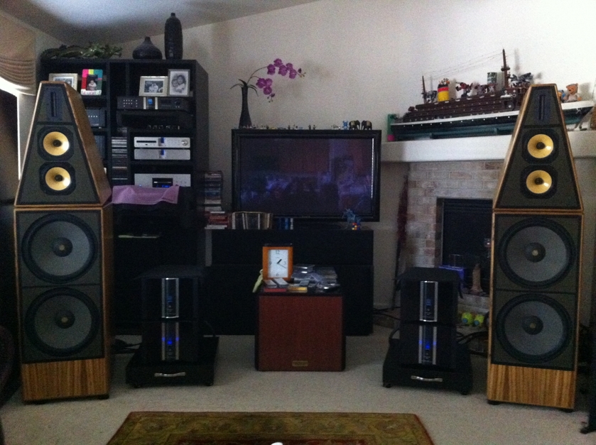

Focal Raven DIY speakers.
System uses Krell Amps, Krell Preamp and Teac Esoteric CD player
Driver complement per channel:
1 Raven R-2 pure ribbon tweeter
2 Focal Audiom 7K- 7" Poly Kevlar cone midrange
2 Focal Audiom 15VX- 15" Polyglass cone woofers
