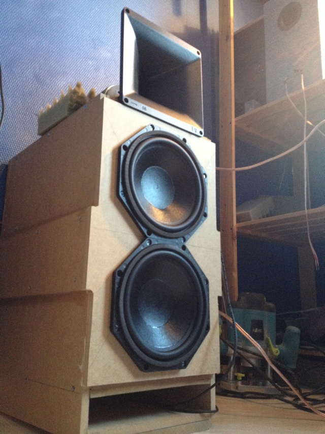

Testbox for 8BG51
I built a test box for my B&C 8BG51 during this week, the result is a hideous shaped speaker that sound great. I currently play a 54Hz sinusoidal tone to break in the transducers. I only have a micro stereo available as amp for now, I will later bring home my McIntosh and test the speakers fully.
But the speakers actually sounds much better than they look, even though the crossover was made without any simulation of any kind!

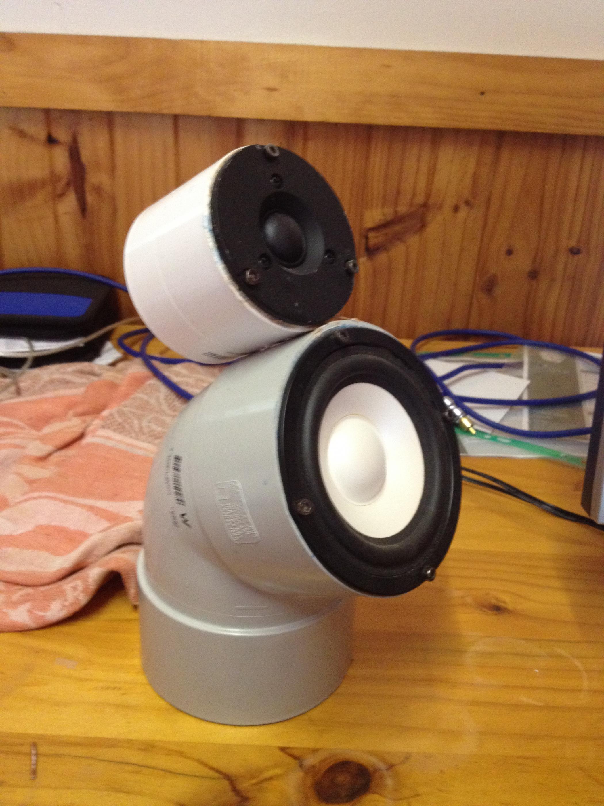

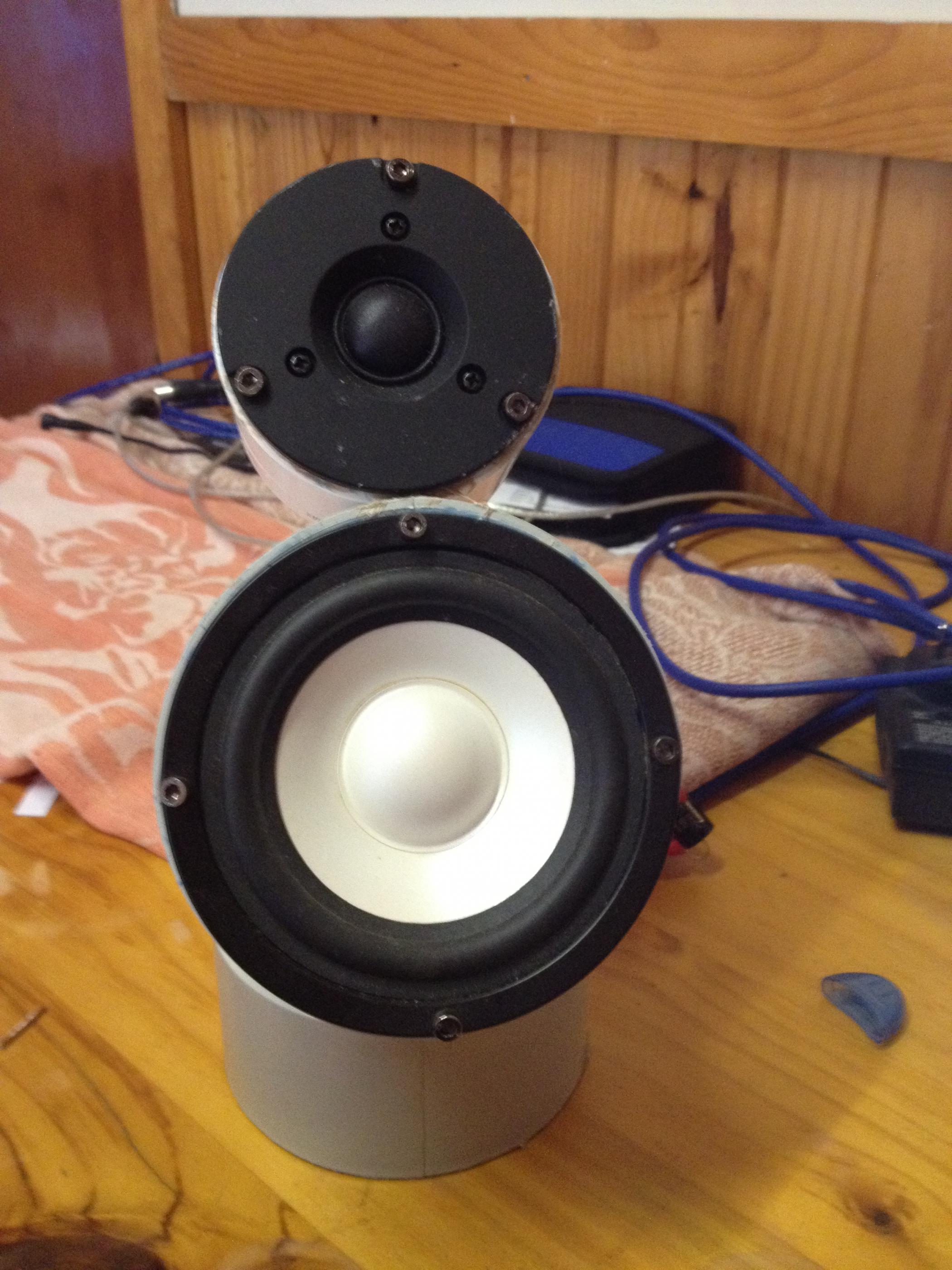

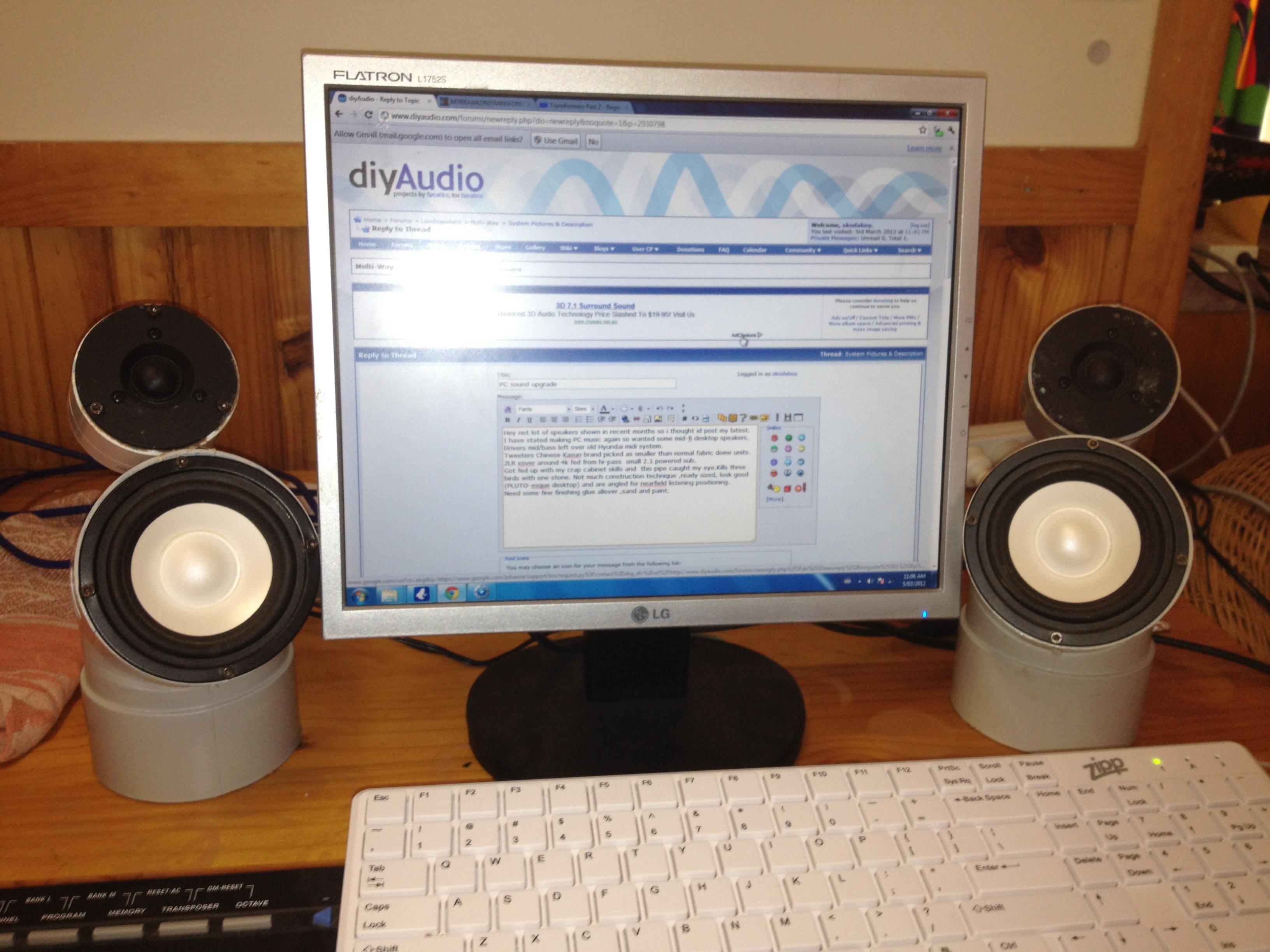

PC sound upgrade
Hey not lot of speakers shown in recent months so i thought id post my latest.
I have started making PC music again so wanted some mid-fi desktop speakers.
Drivers mid/bass left over old Hyundai midi system.
Tweeters Chinese Kasun brand picked as smaller than normal fabric dome units.
2LR xover around 4k fed from hi-pass small 2.1 powered sub.
Got fed up with my crap cabinet skills and this pipe caught my eye.Kills three birds with one stone. Not much construction technique ,ready sized, look good (PLUTO-esque desktop) and are angled for nearfield listening positioning.
Need some fine finishing (glue allover ),sand and paint.
results better than expected ,nice and clear.

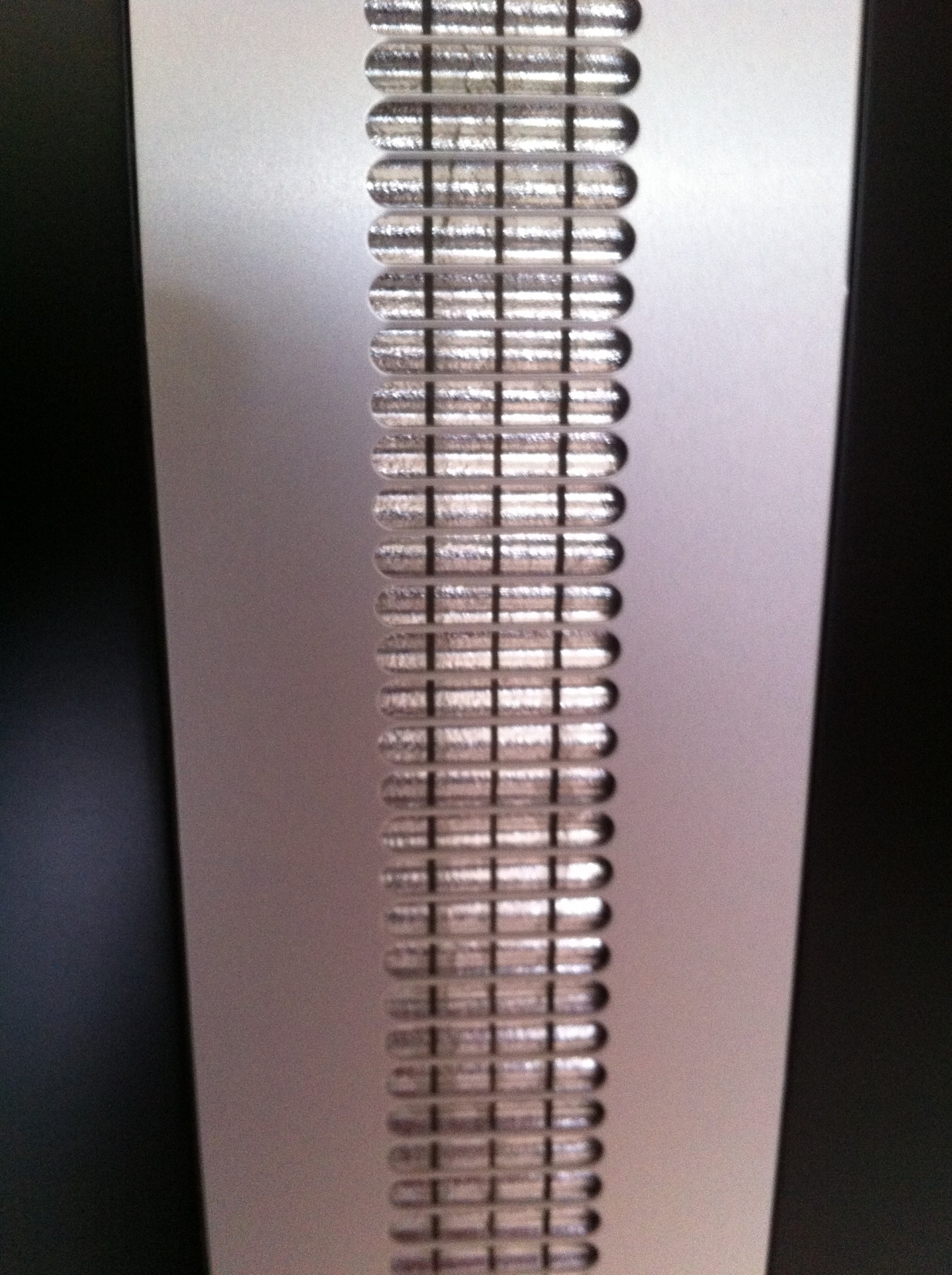

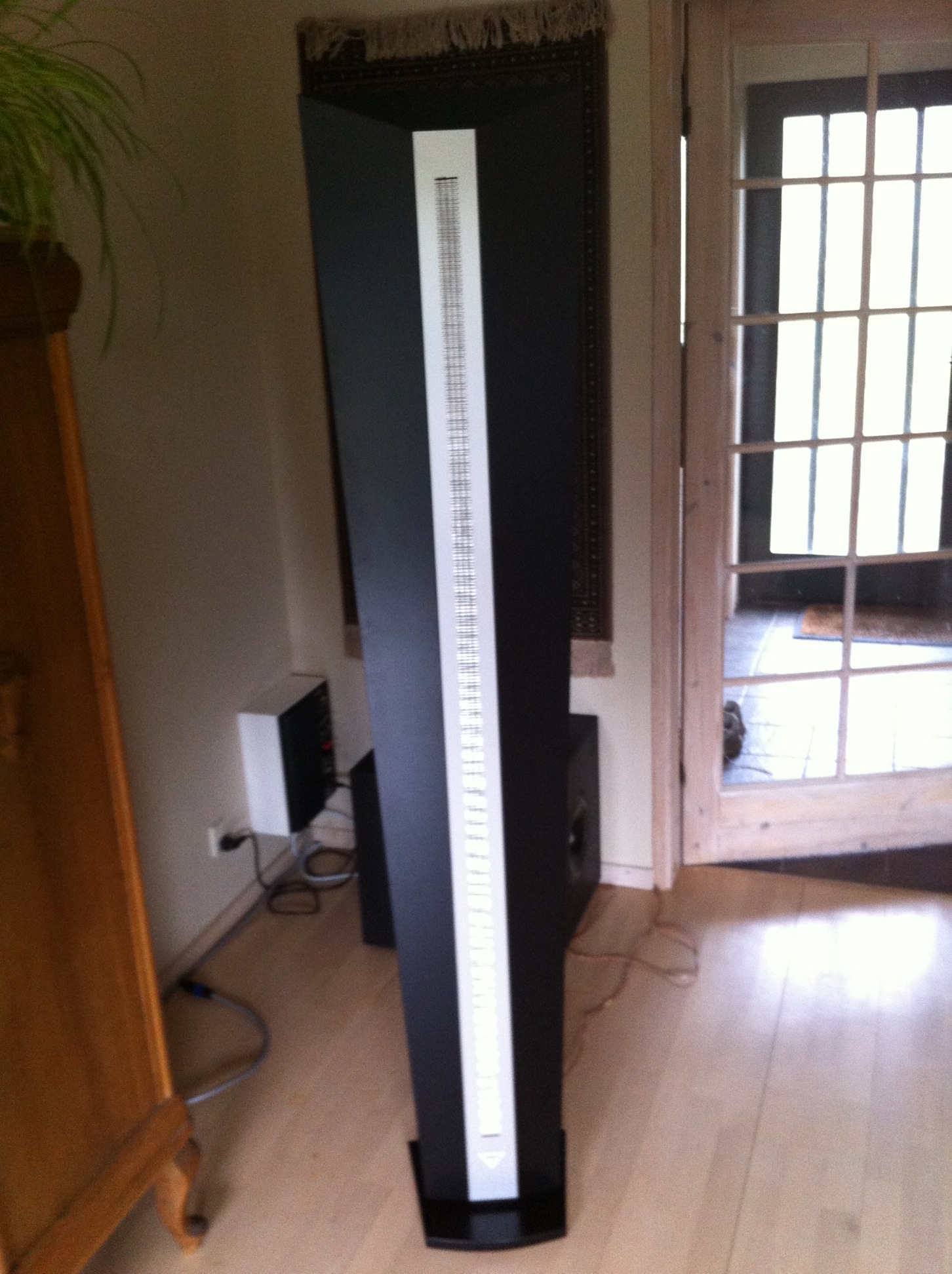

Diy nano magnetic ribbon, with modified scanspeak 8". One on each side of inclusior. Groundsound dsp preamp or minidsp.
crosover 400hz LR24db. Ribbon 400-45000hz.
