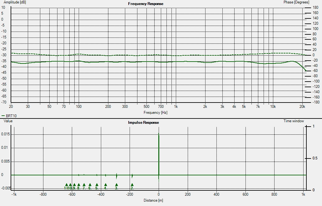

Here is a frequency and phase plot for them.

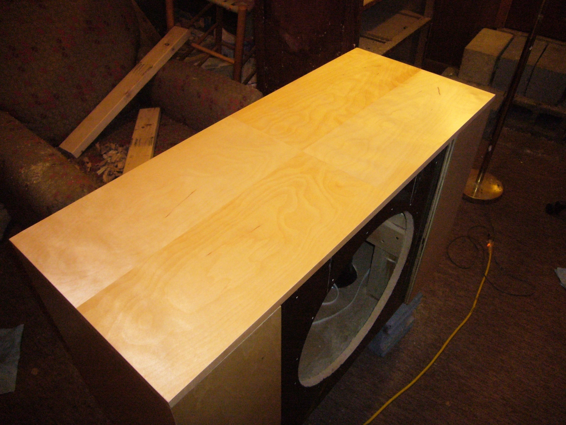

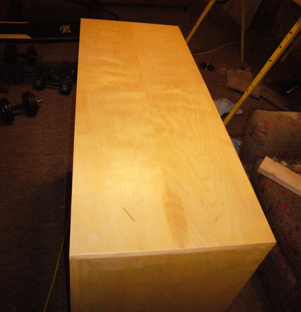

I finally got the top for the subwoofer finished! I cut the birch ply so that I had a nice veneer book match, then I cut it in half the other way and put it back together to get the 4 way match. There are flaws in other parts of the project, but overall I think it's pretty good. I use 3 coats Hope's Tung Oil Varnish, rubbed in with #0000 steel wool after sanding with 400 grit. Very soon after the oil is rubbed in, I wipe off the excess with a clean paper towel. The last step is to wax it with a good carnuba wax (I have some boat wax lying around).

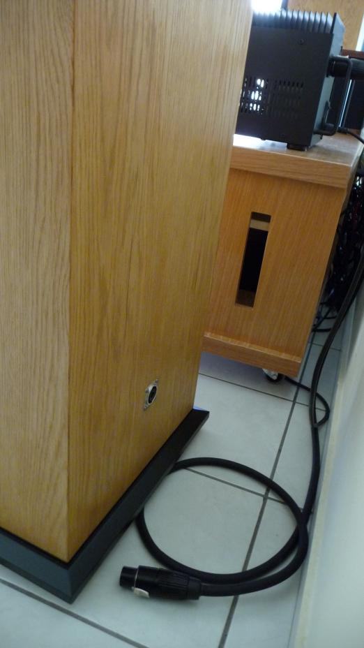

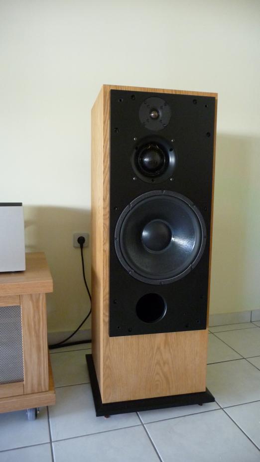

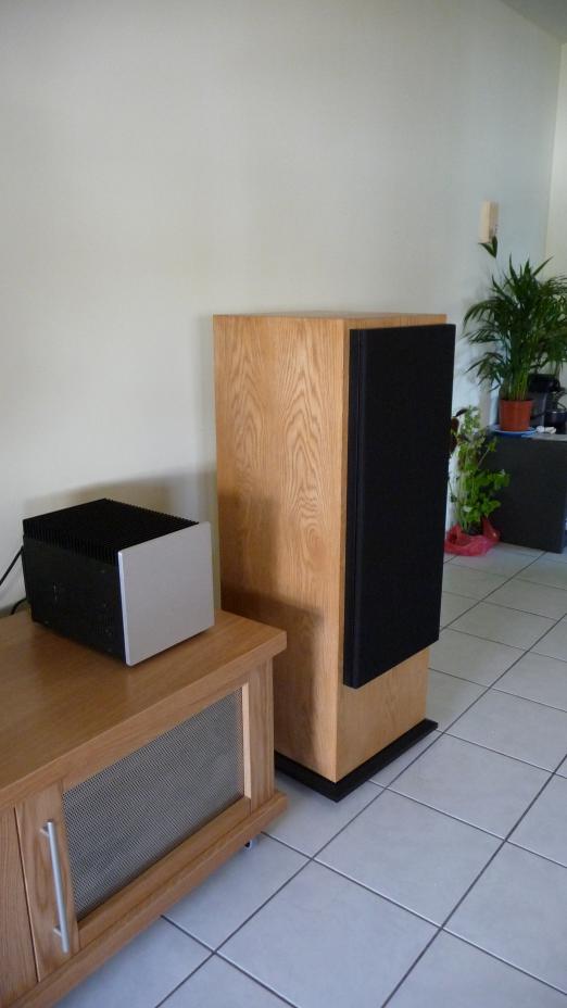

Old out and new coming ?!
Tnx all for many interesting articles. About to build something new instead of these 6 years old 3 way construction. 35 liters of great sound, increadible stable bass all the way down to the basement, lovely mid and treble but....... Could be a little bit more open on the top, and could handle loud volumes a little bit better. Need another design than this heavy oak finish. Thiel&Partners C220, C90, C25 + 8 kg of crossover materials. Any suggestions forsomething of the same sound and size - preferably cheaper?

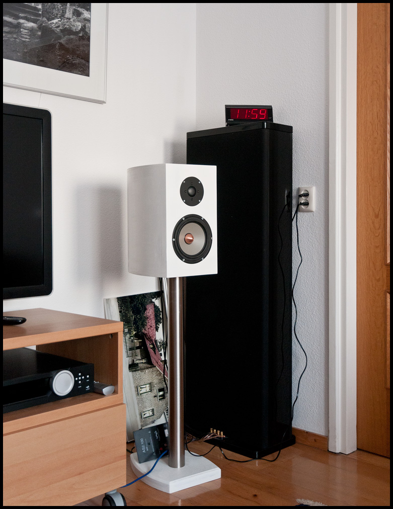

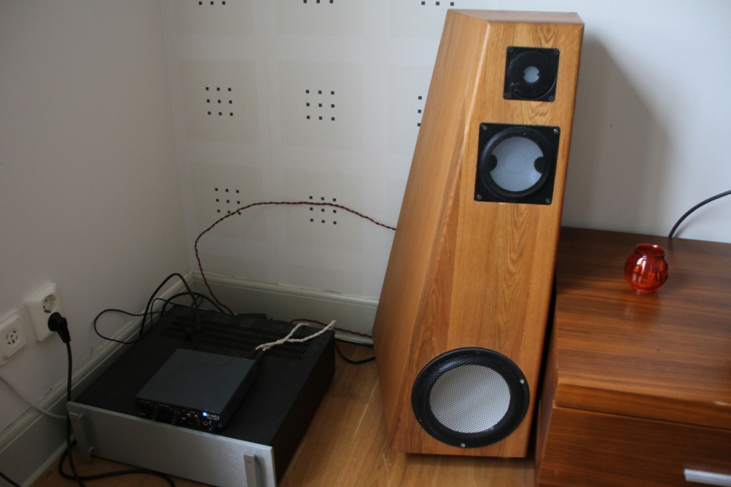

A small(er) 2 way speaker.
attachment.php
Not yet final coated (still out on what finish to use) and cabling to integrate in the stands and replace speaker screws with black ones.
Tapered box with curved side walls. Bassreflex tuned at approx 40hz, vent on on the bottom. Tuning is low with a result that the response is dropping a few dB towards f3 with some room gain in mind to compensate that.
Seas 18cm Excel midwoofer and Visaton ceramic tweeter. Xover at around 2.2Khz.
Currently an active setup with Hypex AS2.100 DSP plate amp. But some time in the future a passive crossover will be created.
I choose a big diameter port to avoid any vent noise. Big diameter resulted in a long port which led to a small resonance at 1,2 Khz. I damped that within the DSP. Maybe I replace the port with a smaller diameter/shorter one so the resonance raises up above the cross-over freq. I don't play that load that vent noise will be an issue.
More then pleased with the result, it digests all kinds of music equally well wether it is jazz, big band, classic, vocals, etc etc.
