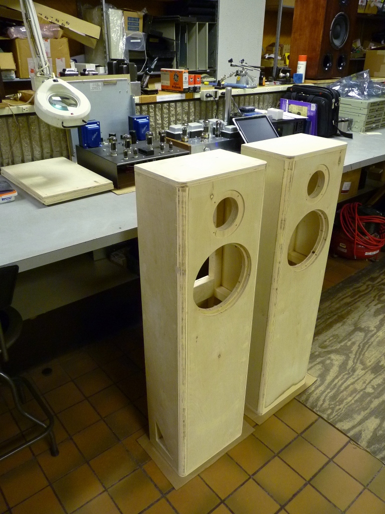

Here is a set I am currently working on. 48" tall, 10" woofer, horn tweeter. 96~97dB sensitivity 1 watt @ 1 meter. The center between the two drivers is based on the average height of typical listening seating. Note the triangle port at the bottom of the cabinet. It is in one side only. Opposite sides of course for a mirrored pair.

A 10" woofer is difficult to mate with a tweeter. What is the woofer upper range? the tweeter's lower range? What X-over frequency & slope do you plan on?
