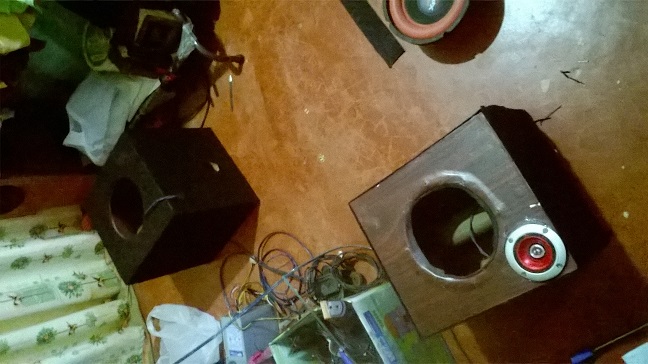

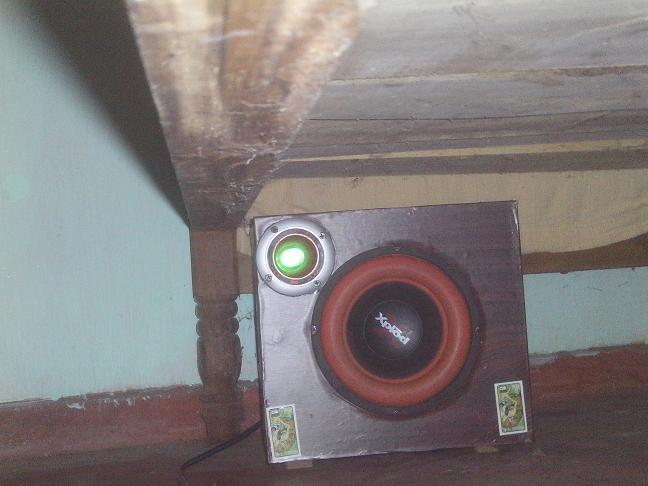

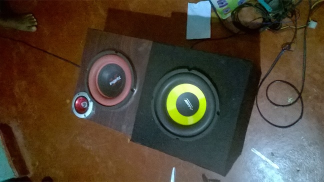

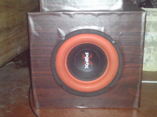

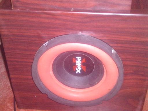

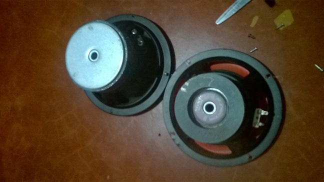

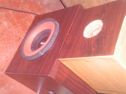

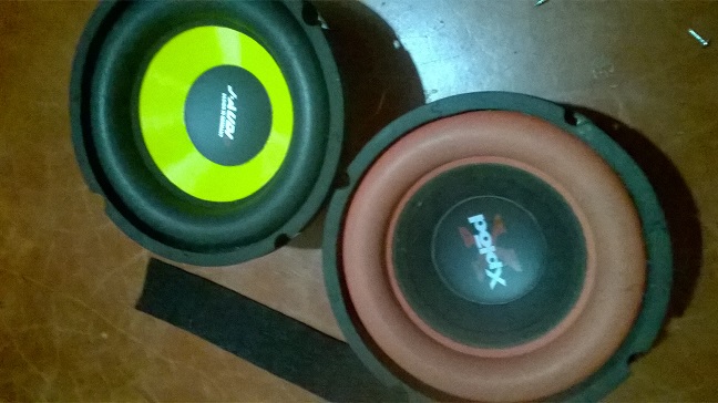

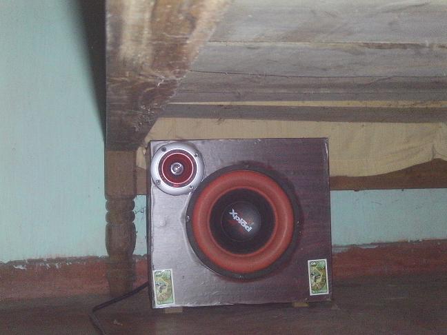

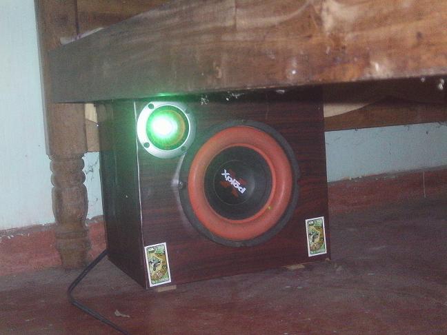

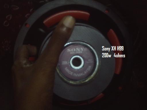

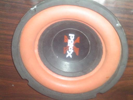

Sony woofer
Sony Xplod XH H99 8 Inch Woofer

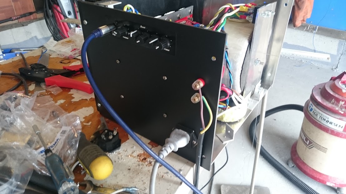

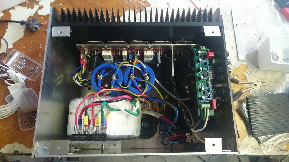

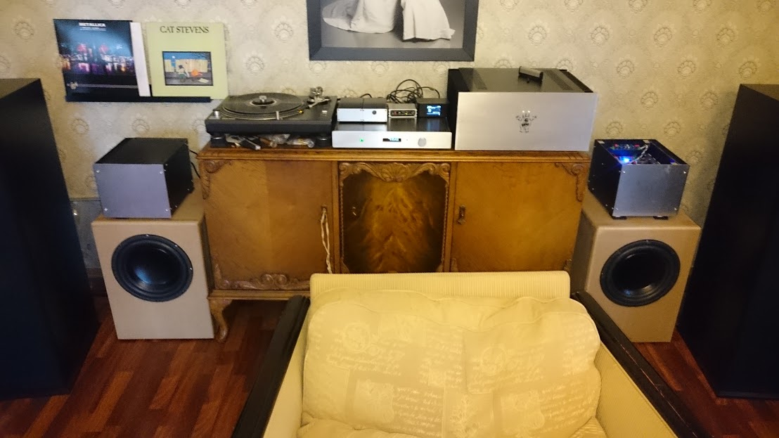

They are slewmasters:
http://www.diyaudio.com/forums/solid-state/248105-slewmaster-cfa-vs-vfa-rumble.html
I started building the amps first using some spare parts, then I realized that I didn't need any more amps, so I built the subs to put them in service.
800VA tranny and +-70V rails.

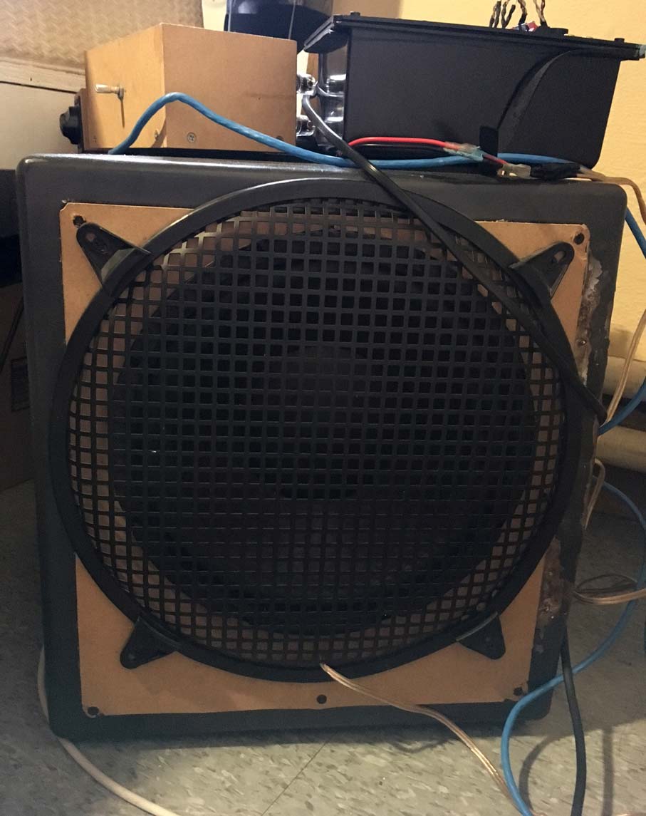

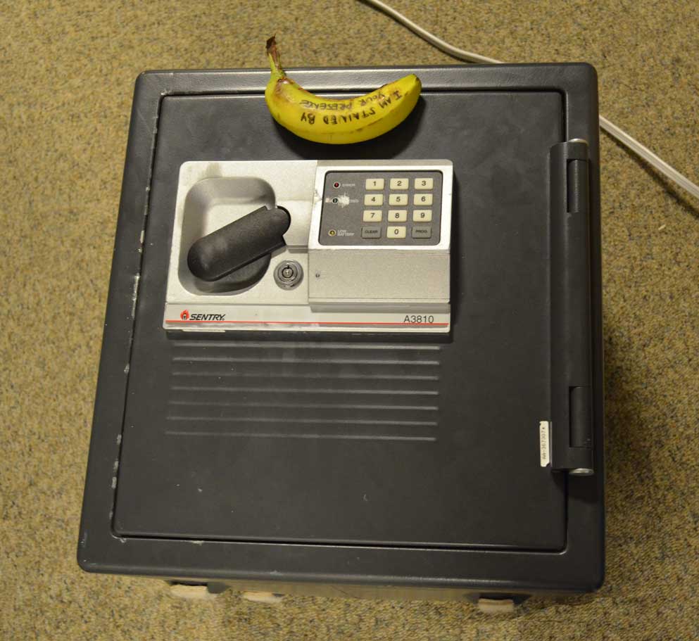

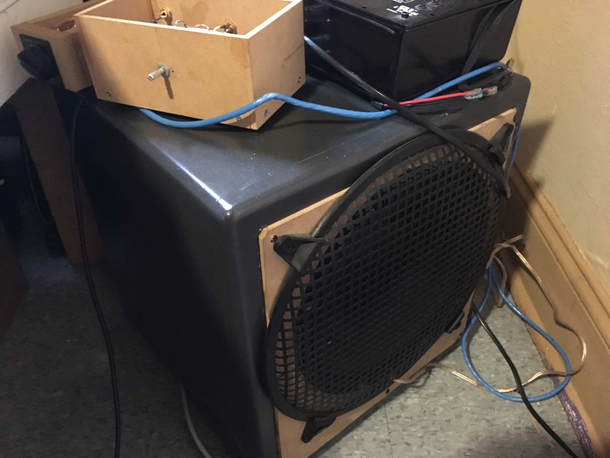

The Safewoofer
Been a while since I've posted here, but I've got another one for you all...
Dayton 12" Reference HF driver + a repurposed mini-safe. I got the safe for free and discovered it was the perfect internal volume for my driver (which I also got at a reduced price). Ripped the door off with some elbow grease and a crowbar. The Dremel tool attempt turned out to be futile. It sounds really great! The enclosure is totally dead due to the ~2" thick walls. Has anyone else seen a subwoofer made out of a safe? I searched but came up empty.
More deets here: http://rayban.vision/#!/projects/safe-sub

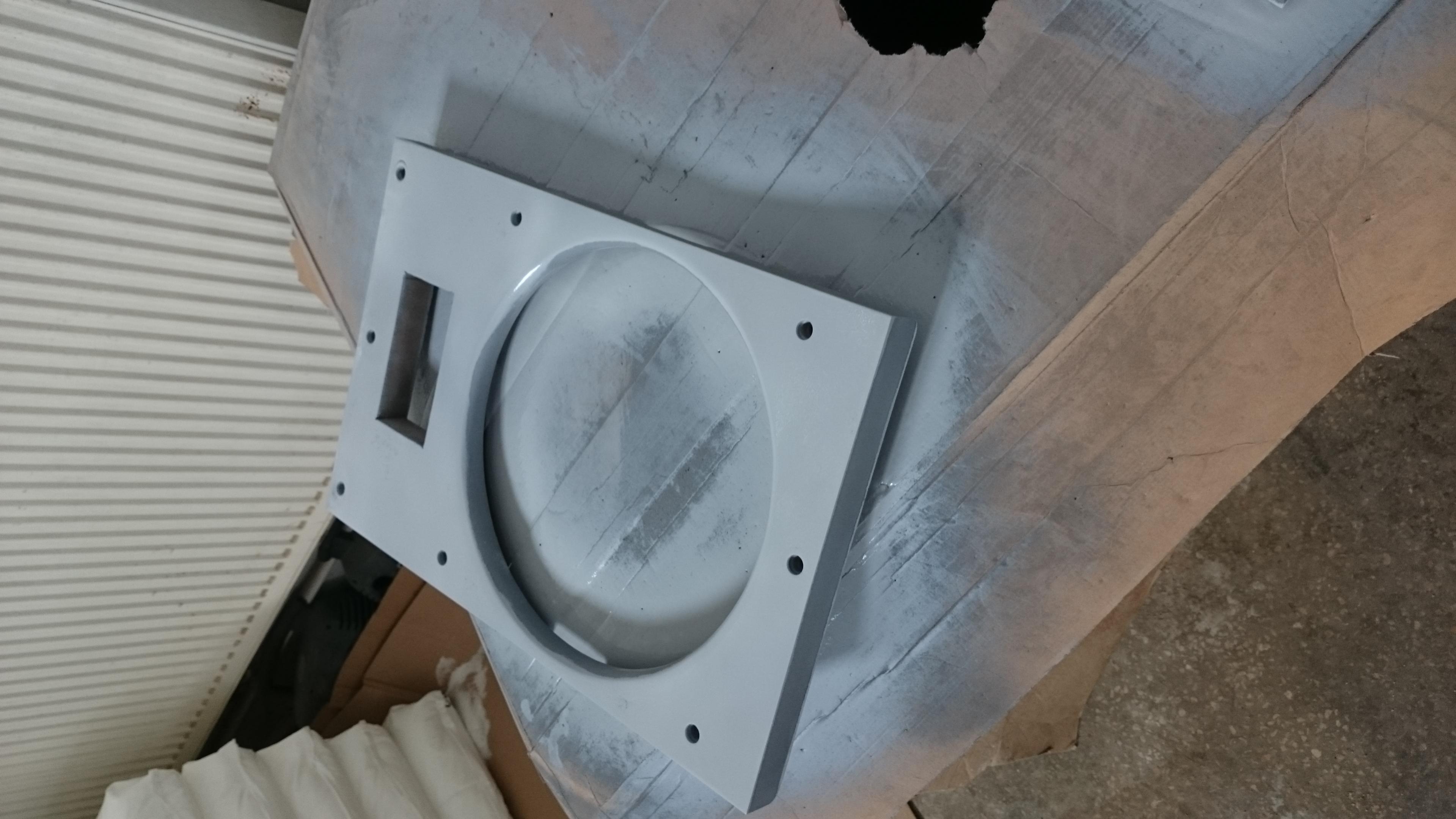

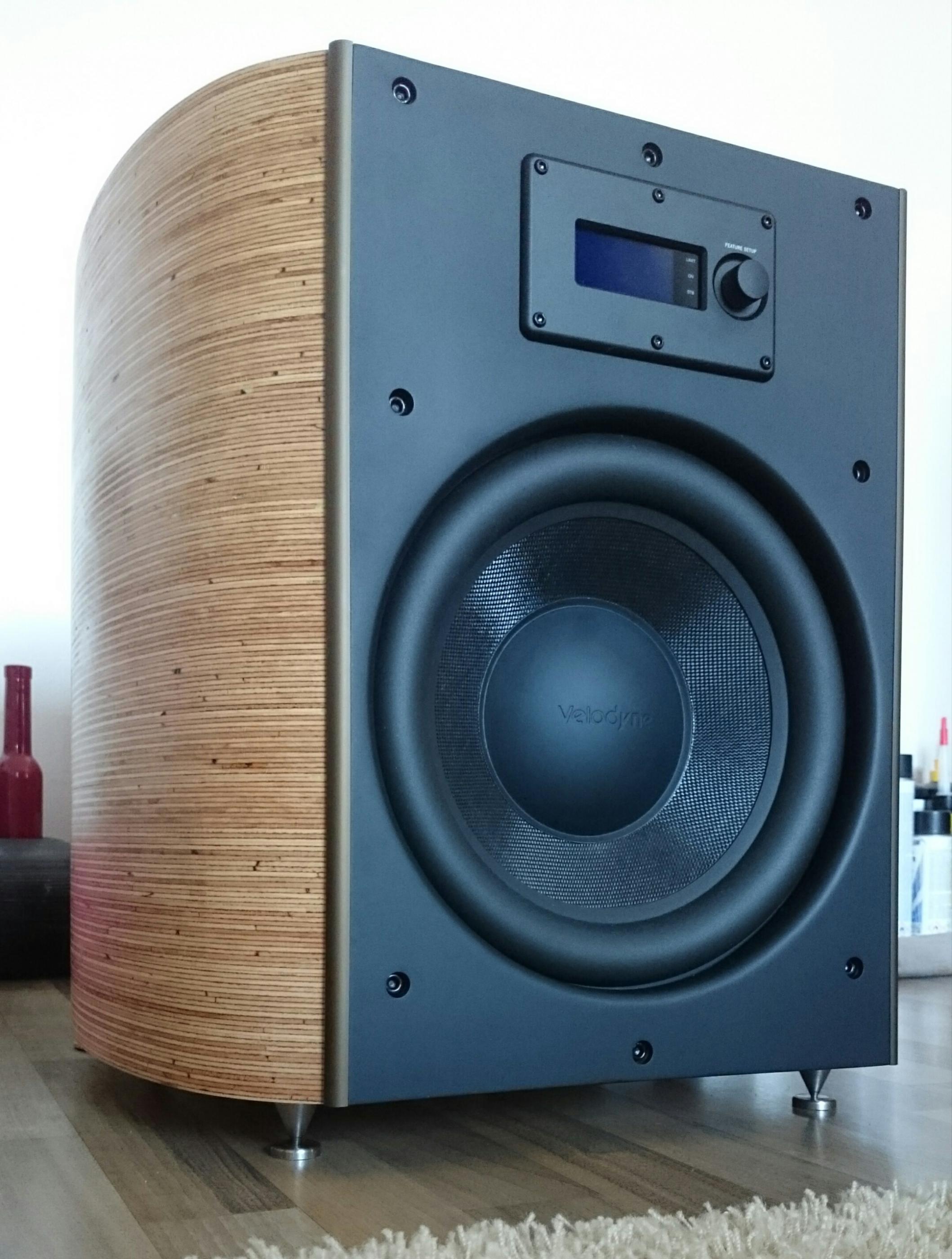

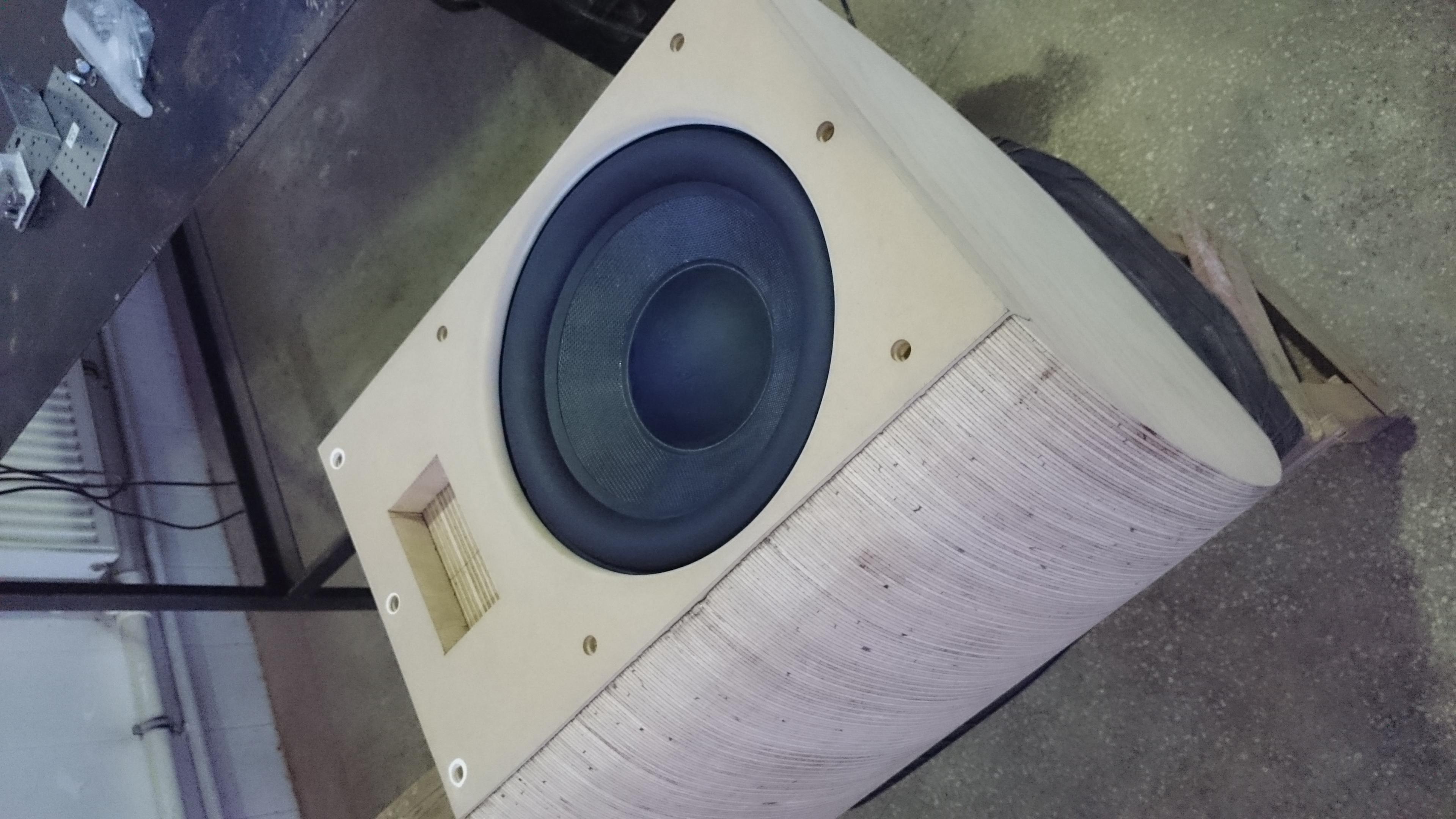

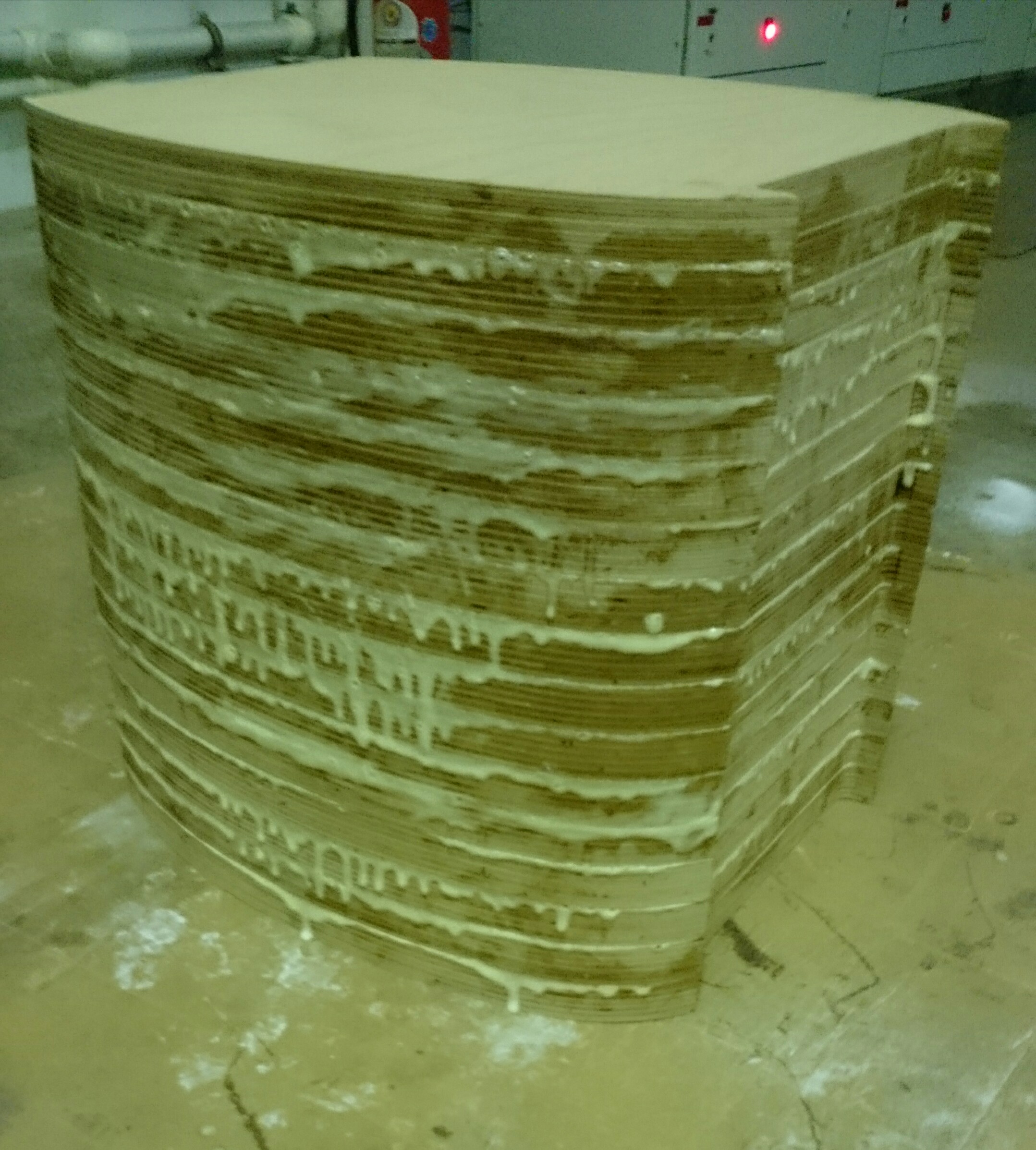

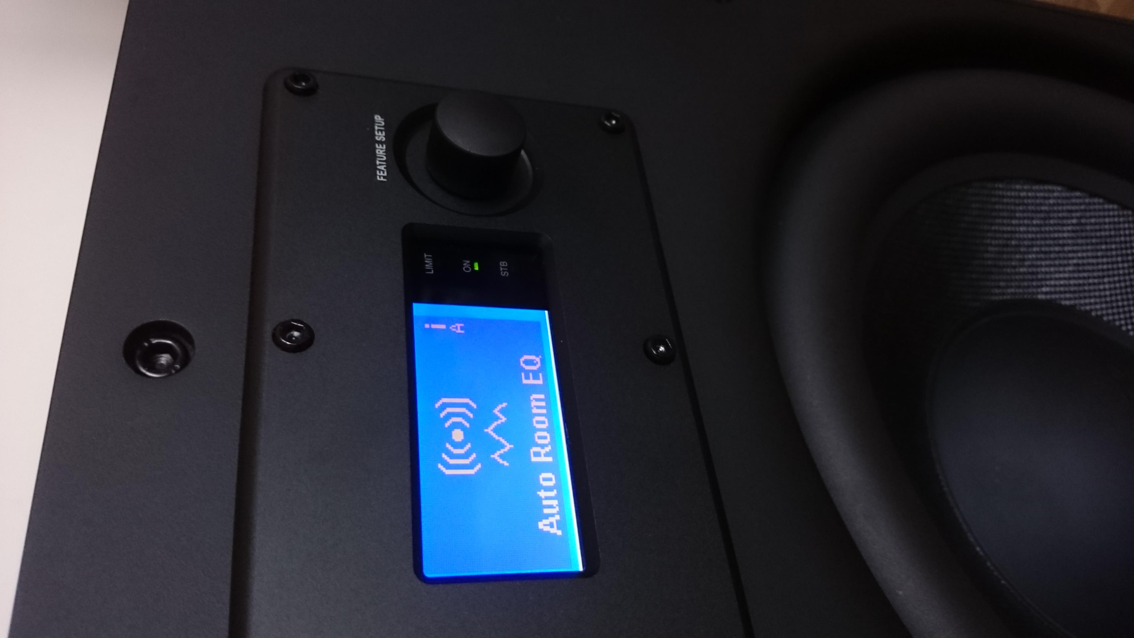

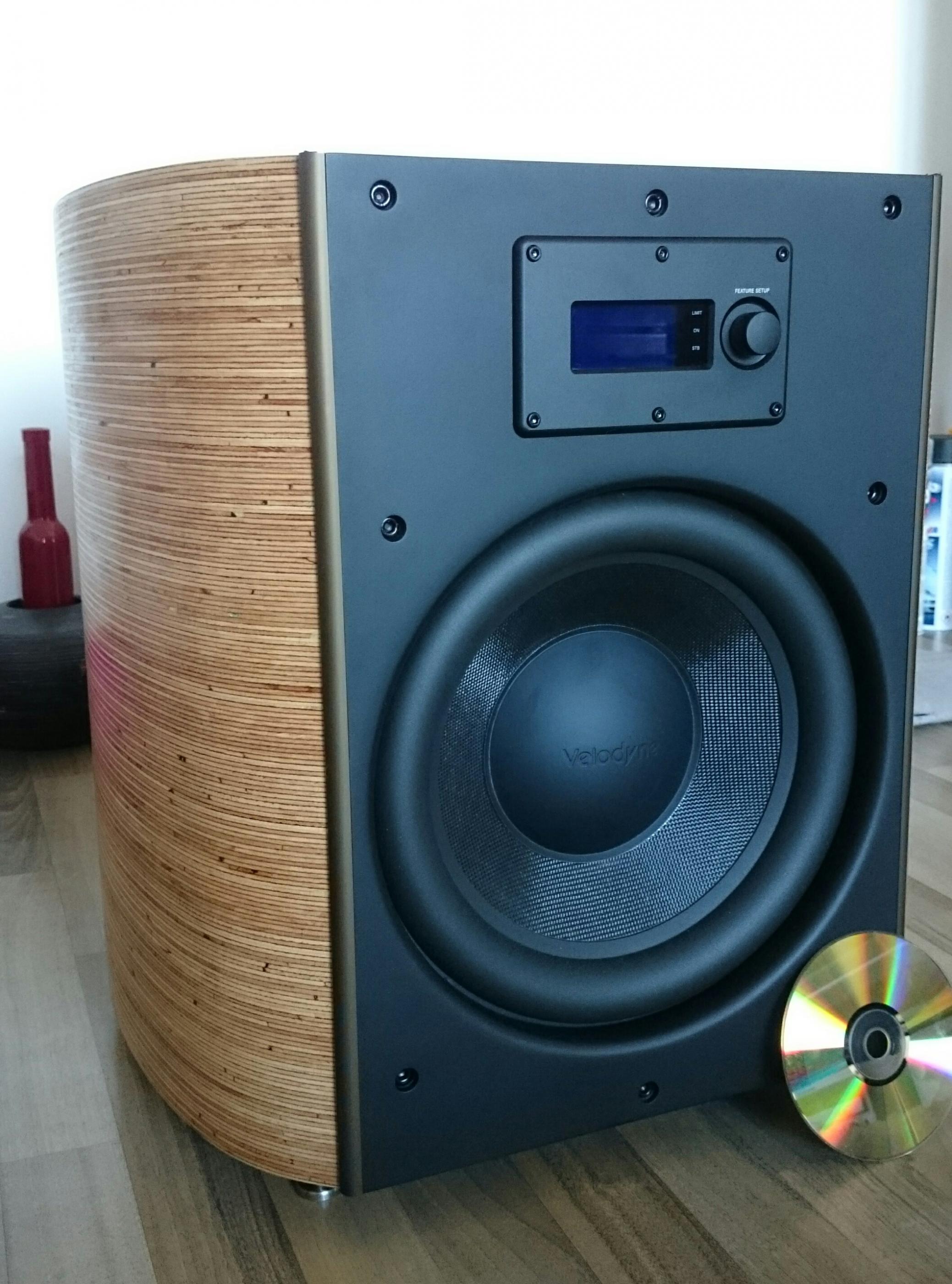

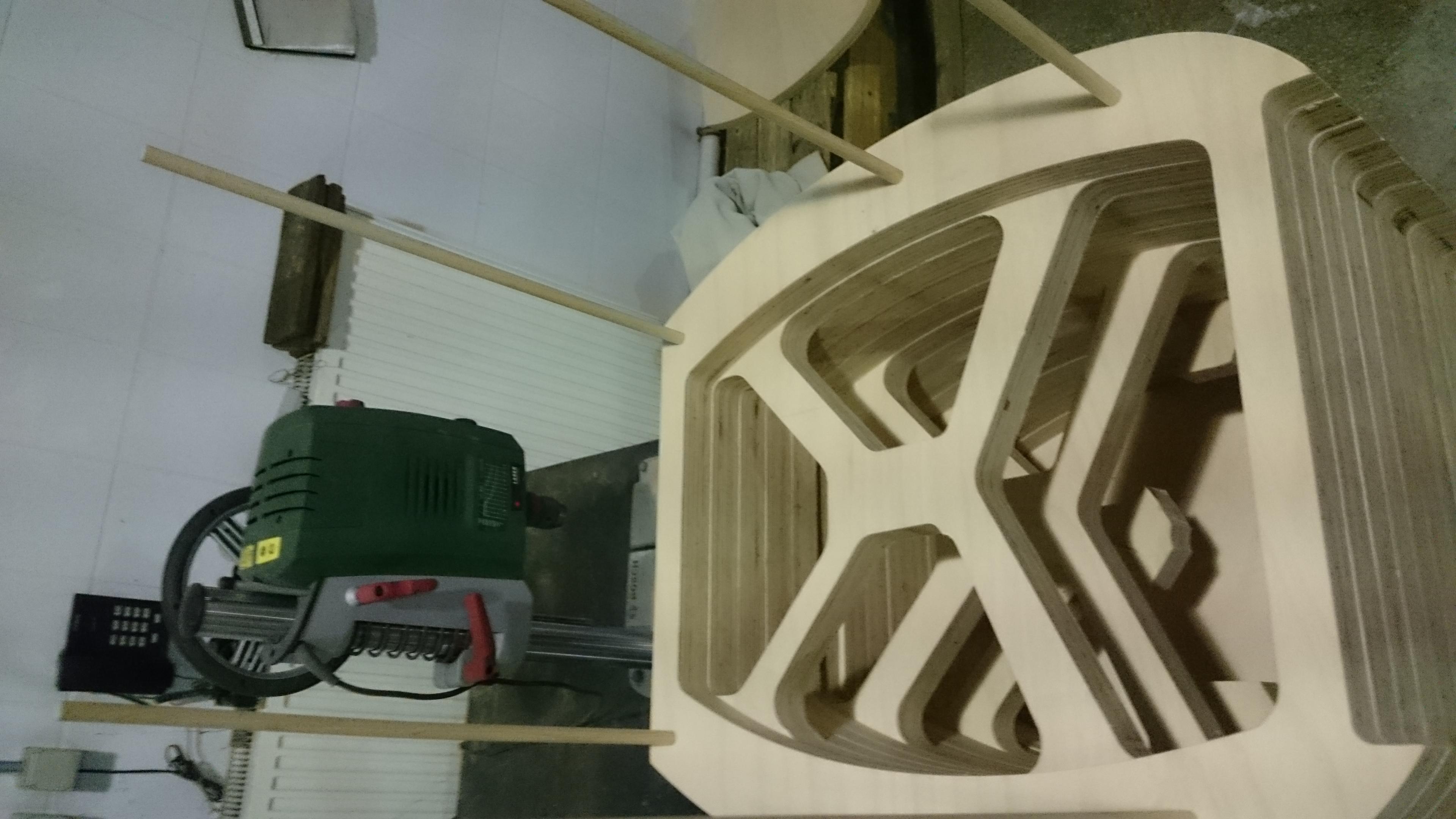

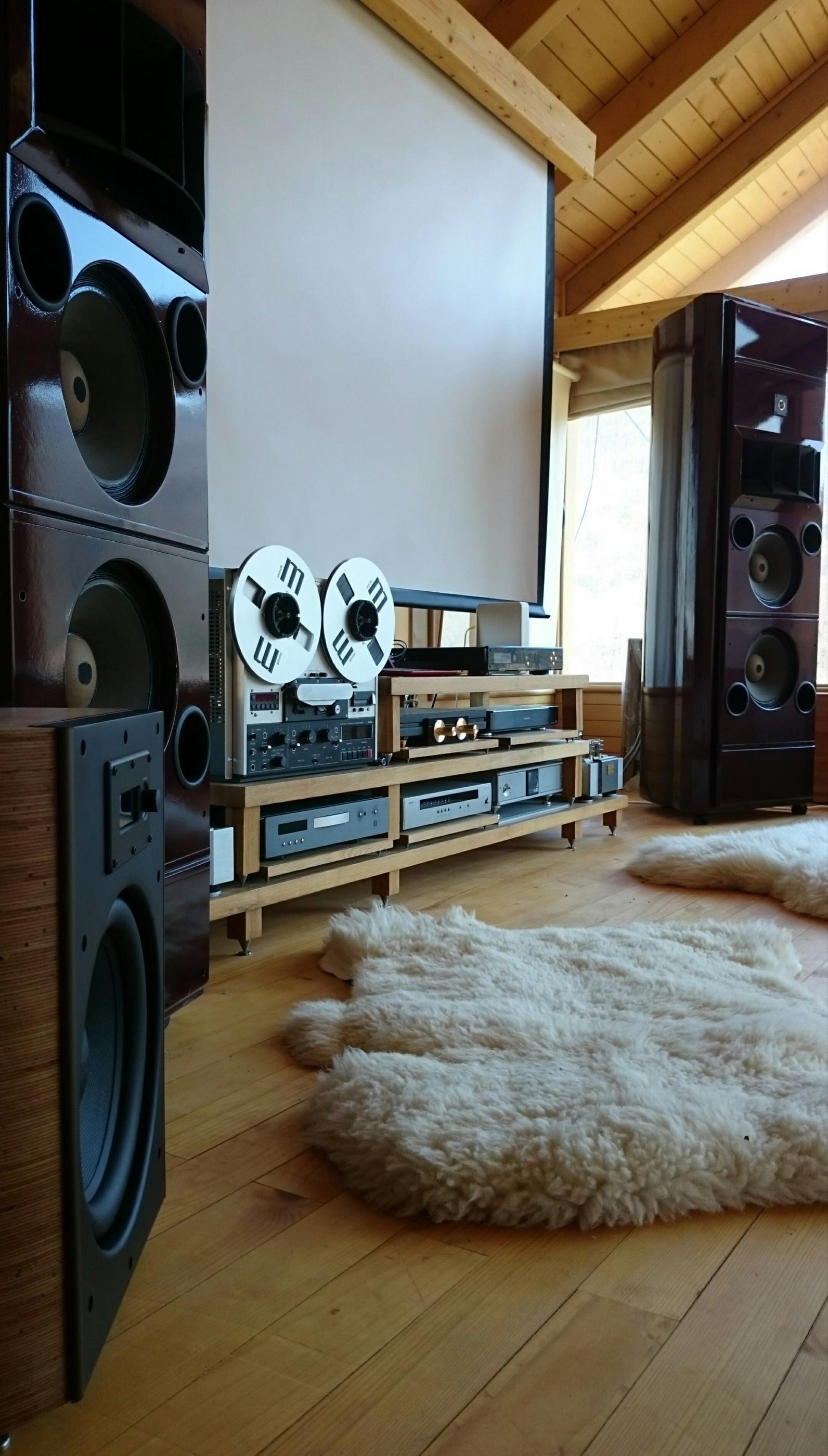

Here is 12" Velodyne subwoofer,closed cabinet,1200W plate amp with auto room correction, DSP,auto EQ,LPF,HPF,phase control,IOS application and a lot of other "things"...

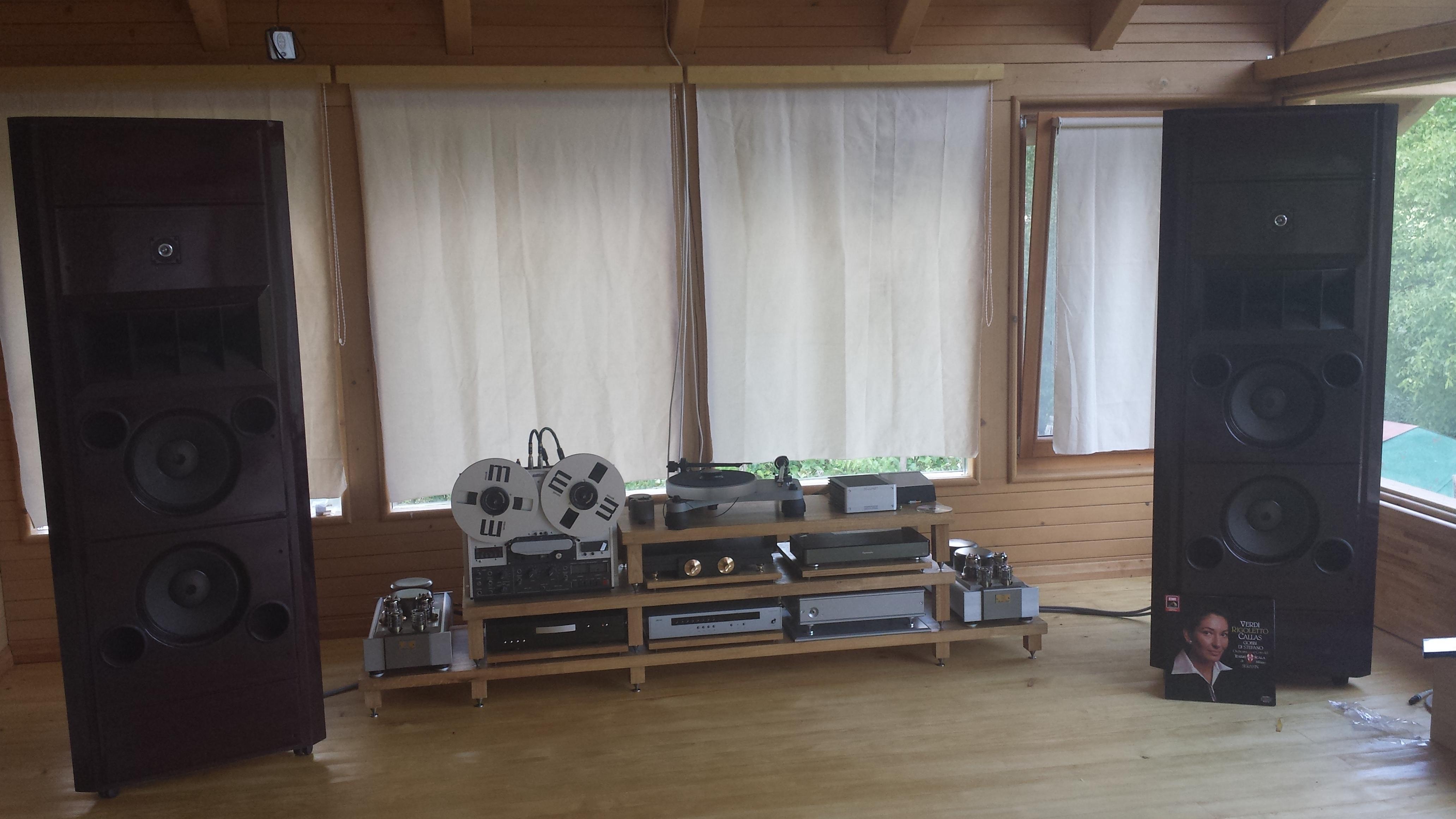

Altec Lansing components. More pics here:

Seems like a great build. What amp and auto room correction is it? How many measurement points you use? Does it take into account main speaker bass output when calibrating?
Yes it is.There are 3 main measurements points, LPF and HPF.
Here are all the details what you need:
Dayton Audio SPA1200DSP 1200W Subwoofer Amplifier with DSP
Taiwan High Power Amplifier w/Auto-EQ and PC-GUI | - FORMOSA AUDIOMATE LTD. - Taiwantrade.com
