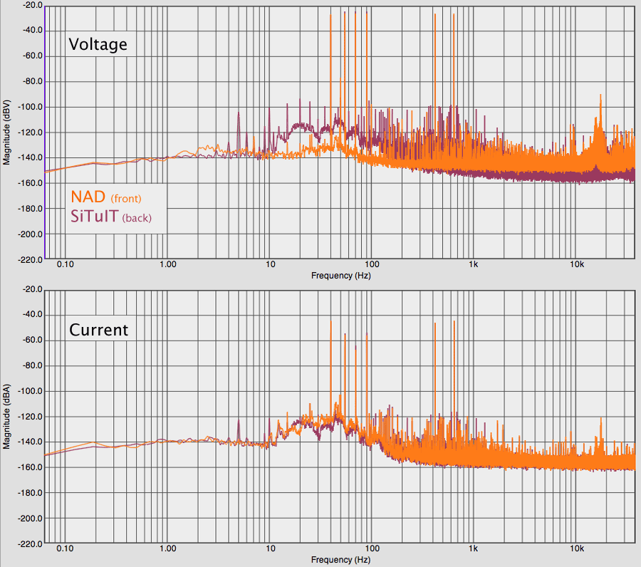

Also, all previous electrical distortion measurements were voltage measurements. Because speaker are current driven I thought I'd have a look at the current distortion. The attachement compares the results for the NAD C320 solid state amp with my single ended tube amp.
The signal was a multi tone made up of six frequencies. The NAD perform much better in the voltage measurement, but for the current measurement there is hardly any difference.
Of the six tones only the one at 645Hz has a phase angle of 0 degrees for both voltage and current, in fact it is the only frequency in the whole 20Hz-20KHz range where this is the case.
