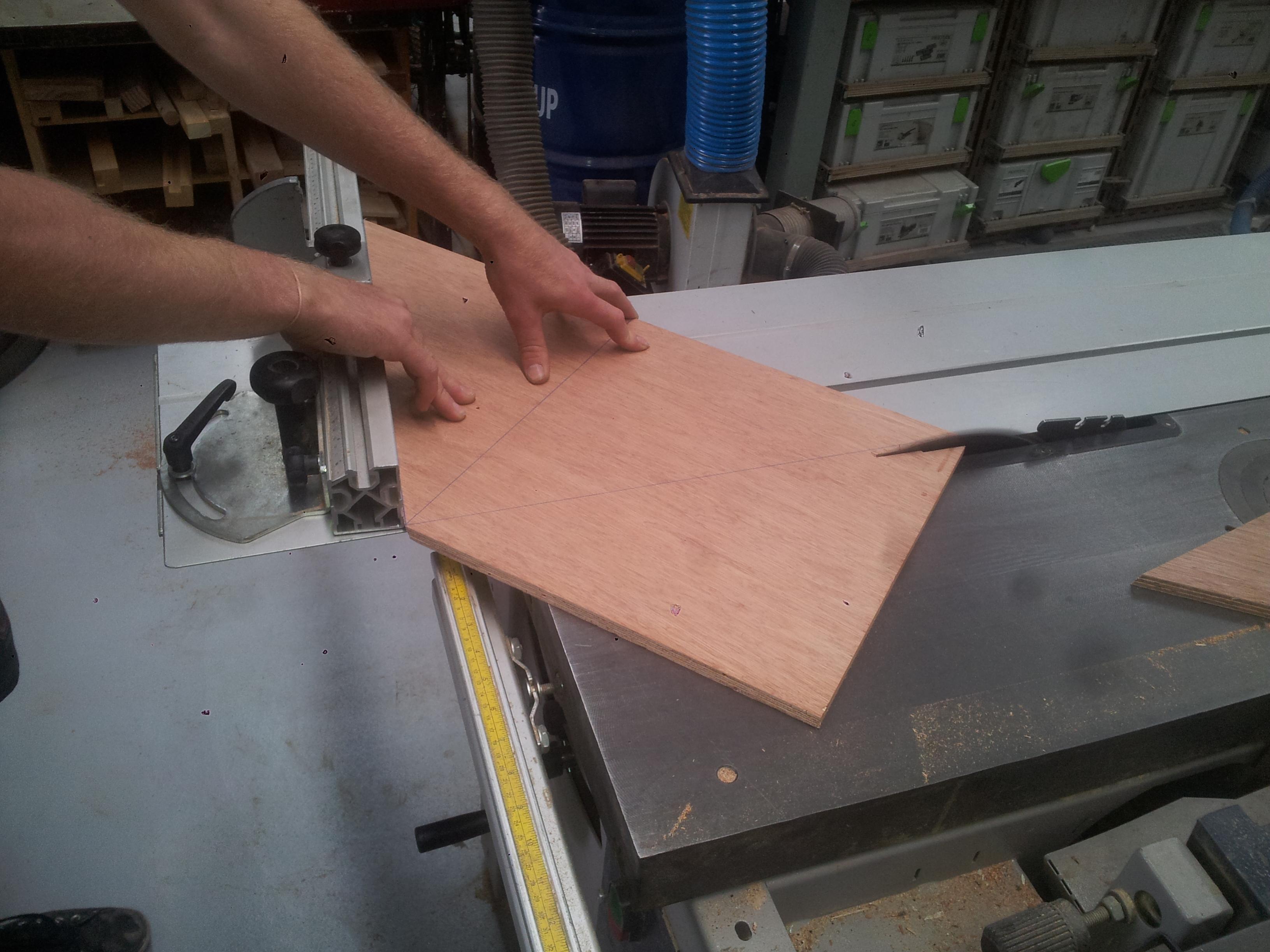

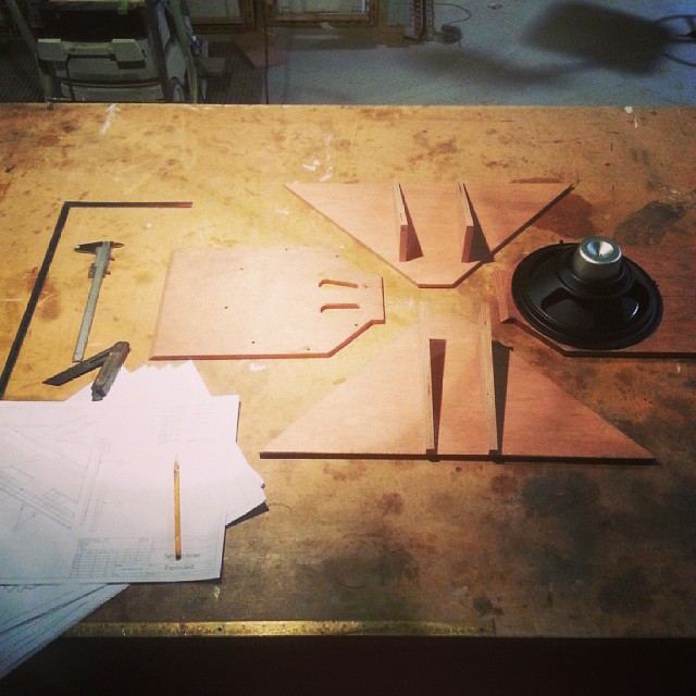

We have started cutting!
I know the plans are not complete yet as up on here, but it is enough for us to do some prototyping.
We do intend on making the plans awesome, rounding to half a mm and half a degree, and annotating the important angles and measurements to help you get the cuts done right the first time.

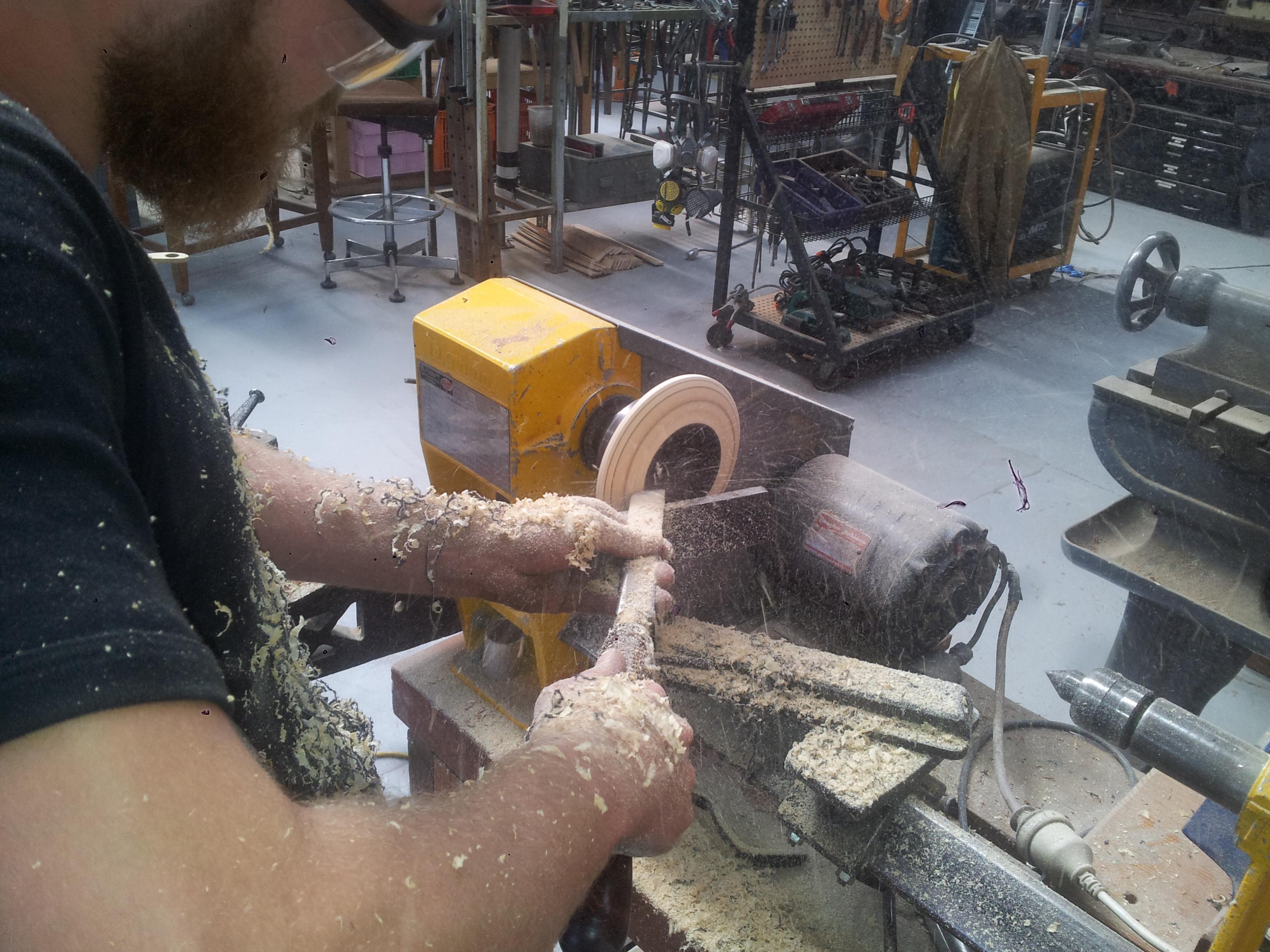

Some more progress. Working on the plugs. Rory created one in about 10 minutes to spec on the laythe.
Correcting the model as we go, and marking out the important measurements, and important notes.
