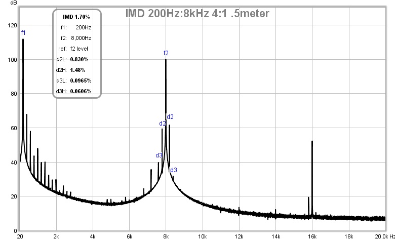

IMD is easy to measure. ARTA supports it. Just use two tones (or more) with a certain distance in frequency. There will be new difference tones visible.
Usually the more ways a speaker has the less IMD it produces. Examples are on Neumann's site. Now I wonder if the Synergy Horn as a multi-way speaker follows that or introduces new IMD caused by the shared horn.

My concern is more along the lines of an appropriate acoustical space. I used to have access to a wide open expanse of flat concrete with electricity...but I don't any more. Then I have to measure near-field to the mouth of the horn....and I have to be concerned with overloading the microphone. I'll look to see if ARTA can gate a multi-tone signal.

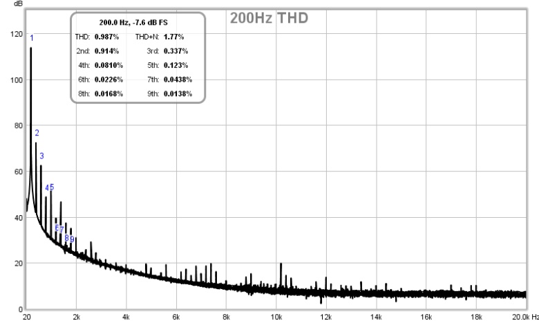

I did it as loud as I could without overloading my uMik-1, used continuous tones with REW and tested at ~.25 meters. The Synergy style design I tested was my smaller one with a PRV D290, Gento 2" buyout midranges (Bill Waslo uses these) and Vifa TC14SG49-08.
A note on how loud this was...I was wearing hearing protection and it was still quite loud. I could *feel* my clothes sympathetically vibrating with the 200Hz tone.....
I used a 200Hz/8kHz tone at a 4:1 ratio. I turned up the signal until the mic signaled overload and then backed it down 3dB.
First I tested the THD of the woofers...without the 8kHz HF tone. Next I tested the IMD of the combo.
There is some visible IMD...but let me be absolutely clear.
At this volume level in a domestic environment (what I care about) you'd be DEAF AS A POST in a very short time.
Also. I enjoy having a speaker with lower THD than many single ended amps using $14.00 woofers, $.75 midranges...and a $70 tweeter. It tickles me.
