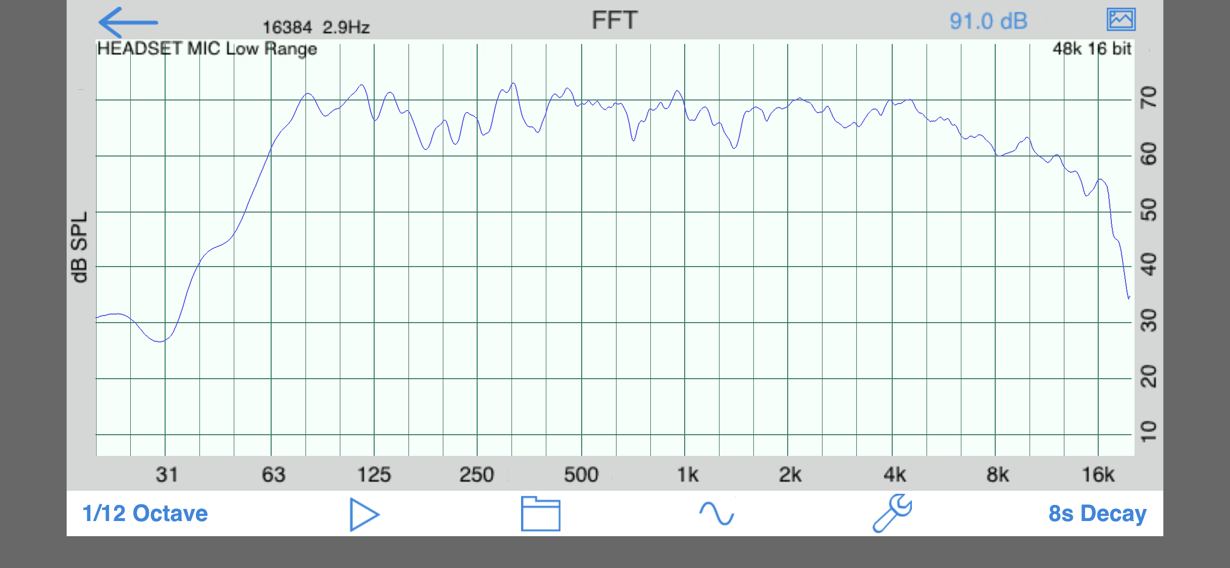

Plot looking better after changing phase on some drivers and adding a little EQ. Still measured inside though.
Top end response was improved by using the correct mic calibration file! ;-)
X-overs are at 330Hz and 1kHz now.

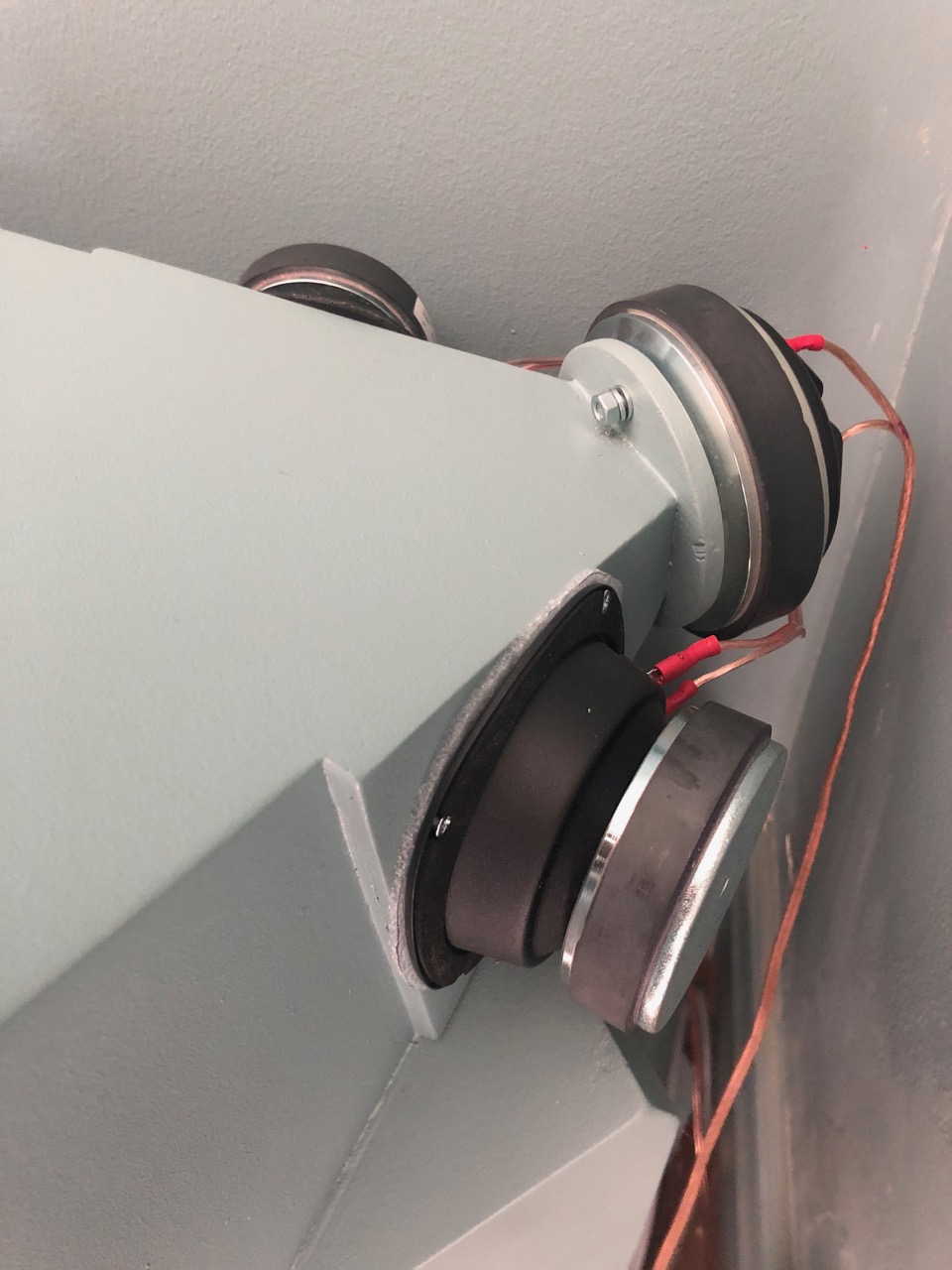

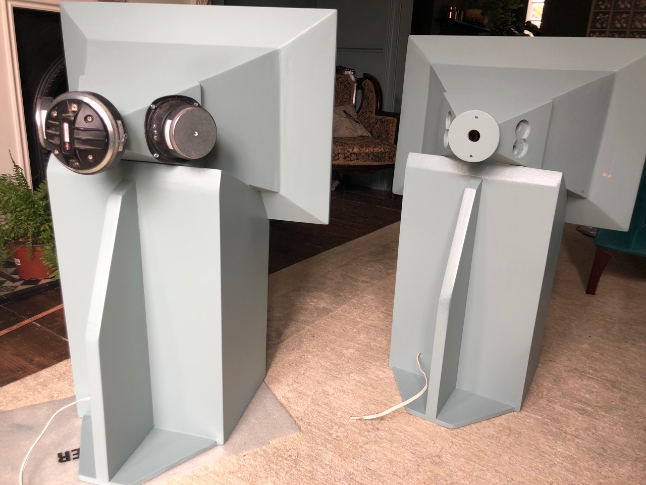

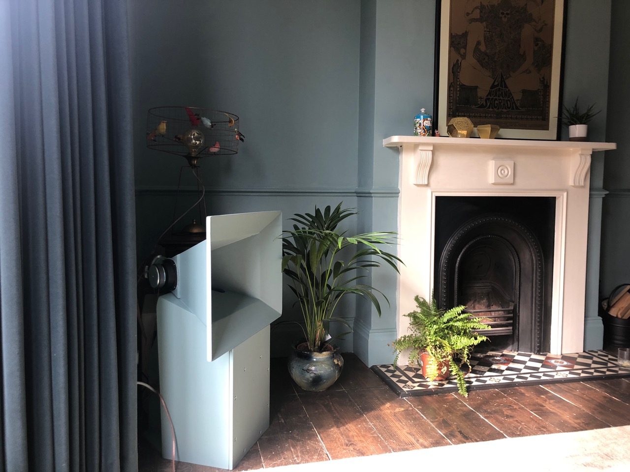

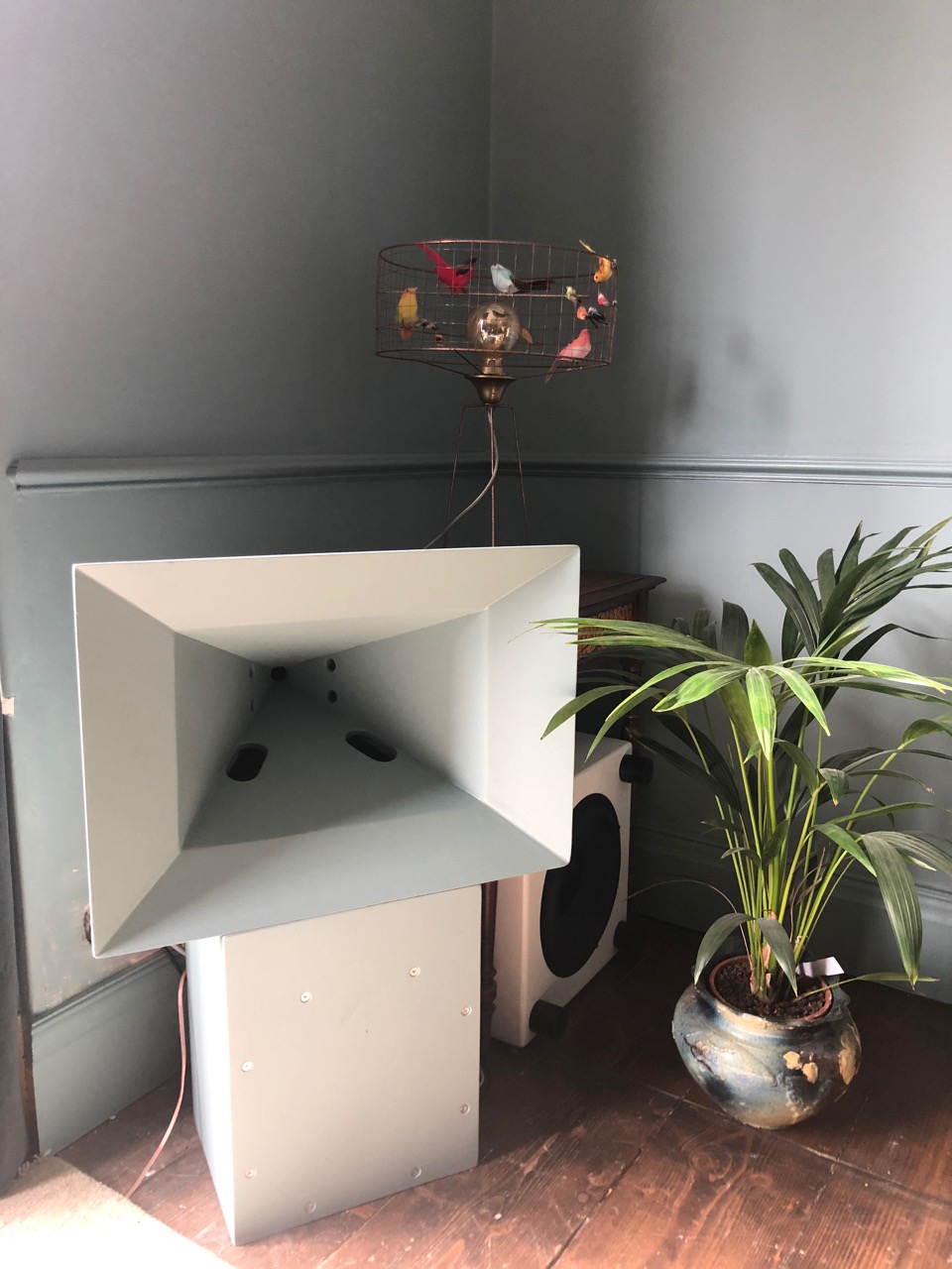

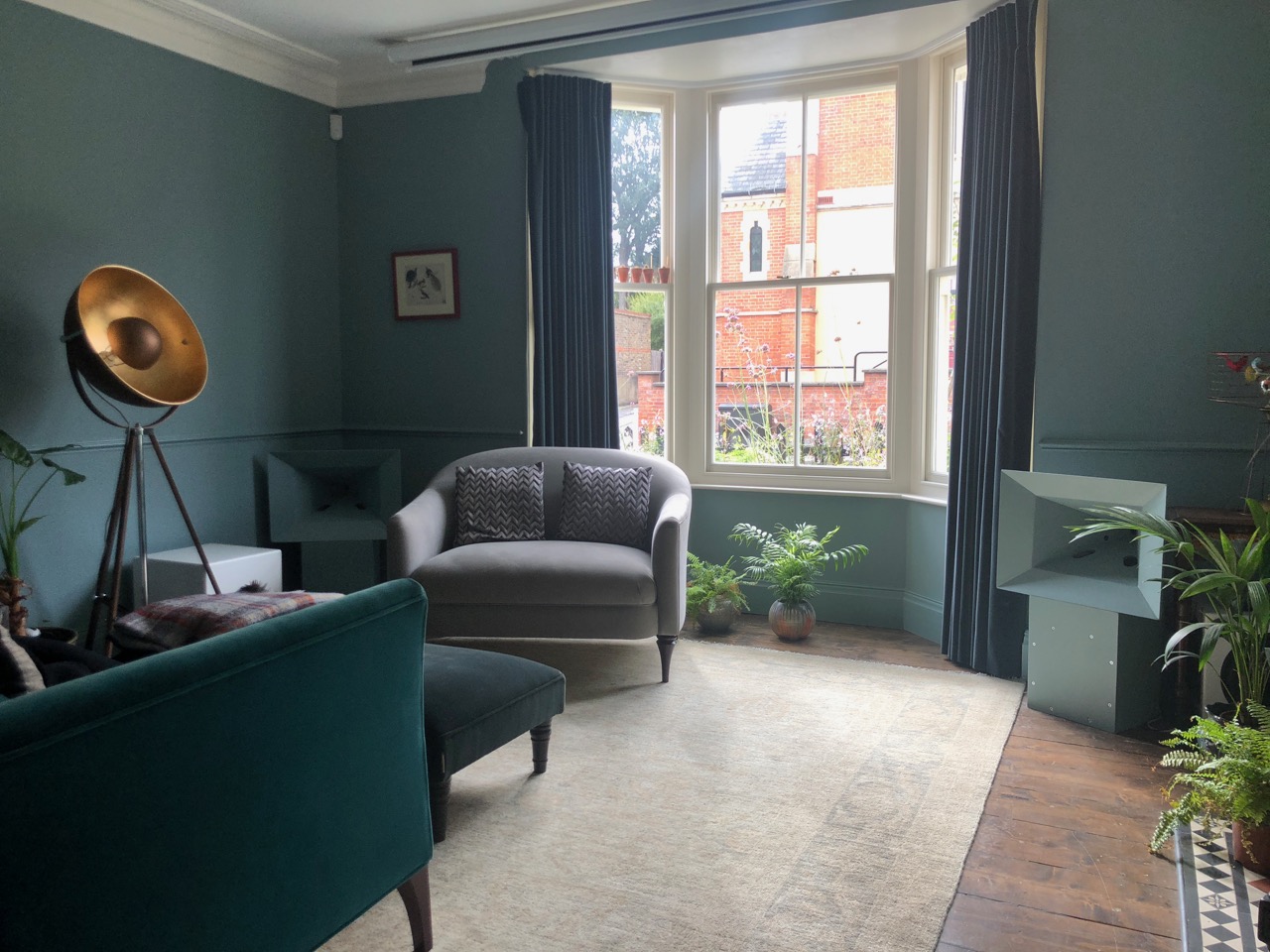

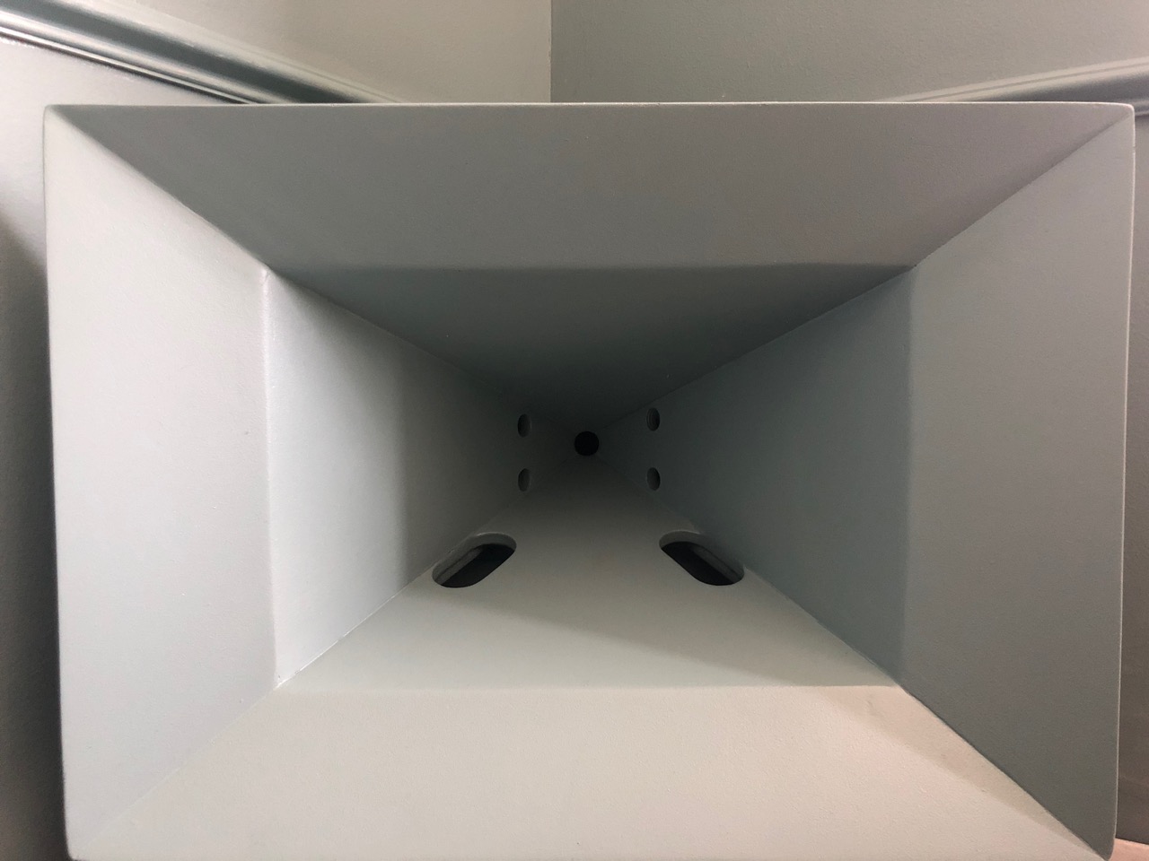

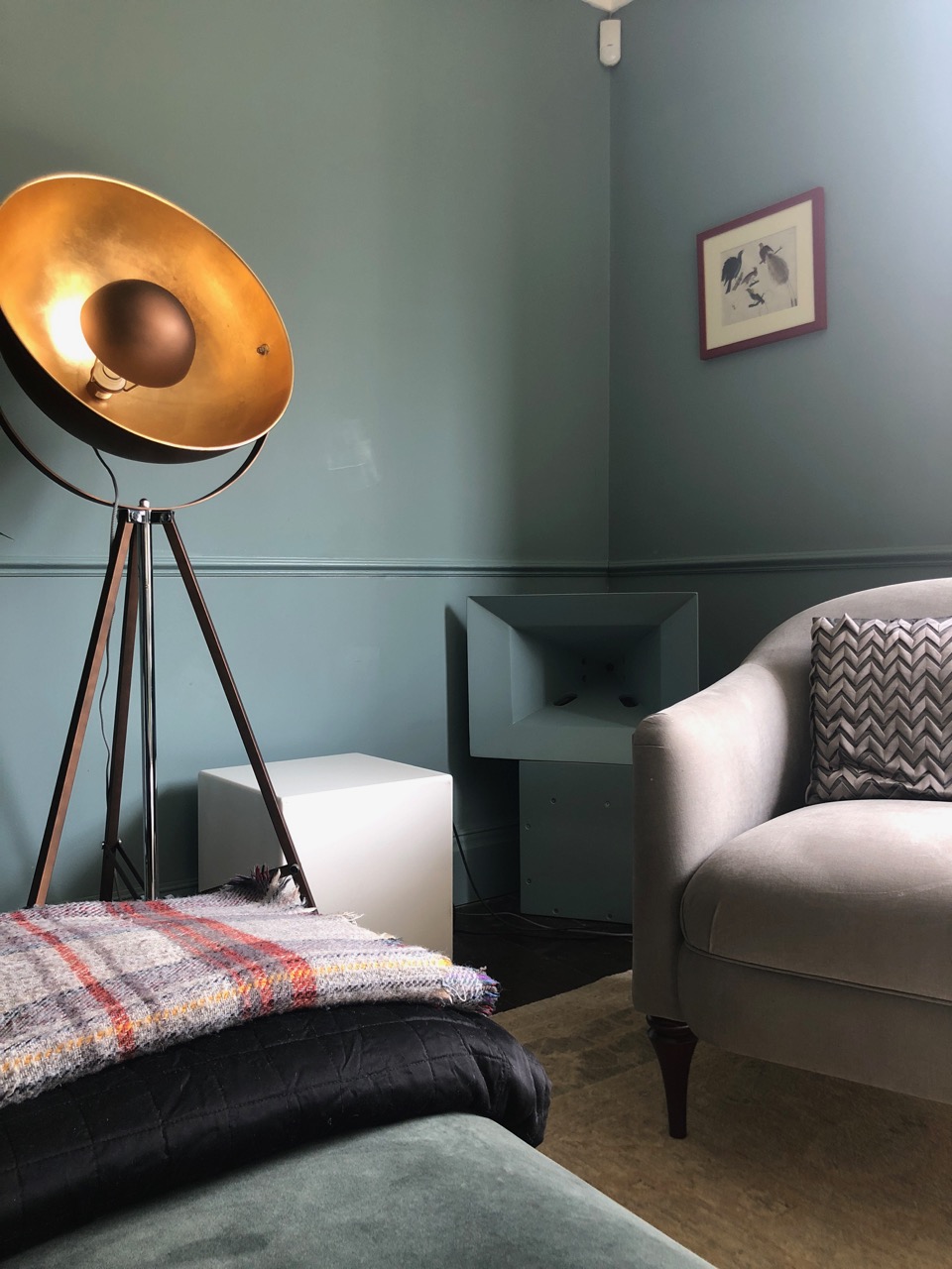

Painted and in position. Paint job is not fantastic but it will do for now. The sound is really incredible which is the main thing!

only just saw this after thinking of the same idea and doing some searching, cool to see someone had already done it. I was thinking with a coaxial compression driver the mid ranges could be omitted and it may even be possible to use a more advanced flare design than a conical as the midrange mounting surface is not longer required.
Ha! This is what I was trying to do in this thread: Increasing loading of midbass in synergy horn
Well I see the basic idea works, but as I can see from your modelling in HornResp, you start to have standing wave near the end of your bandwidth... I was trying to get away with a two-way, so make the approach work up until 1-2kHz. In this case, the midbass entry port needs to be infinitesimally thin to minimize the impedance mismatch and the ensuing standing waves. I am now thinking along the line of Renkus Heinz 1996 unity horn patent? US5526456A
So, on the bandwidth you are using, it is doable.
