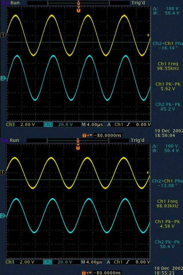

Re: Re: Re: Re: symmetric amplifier

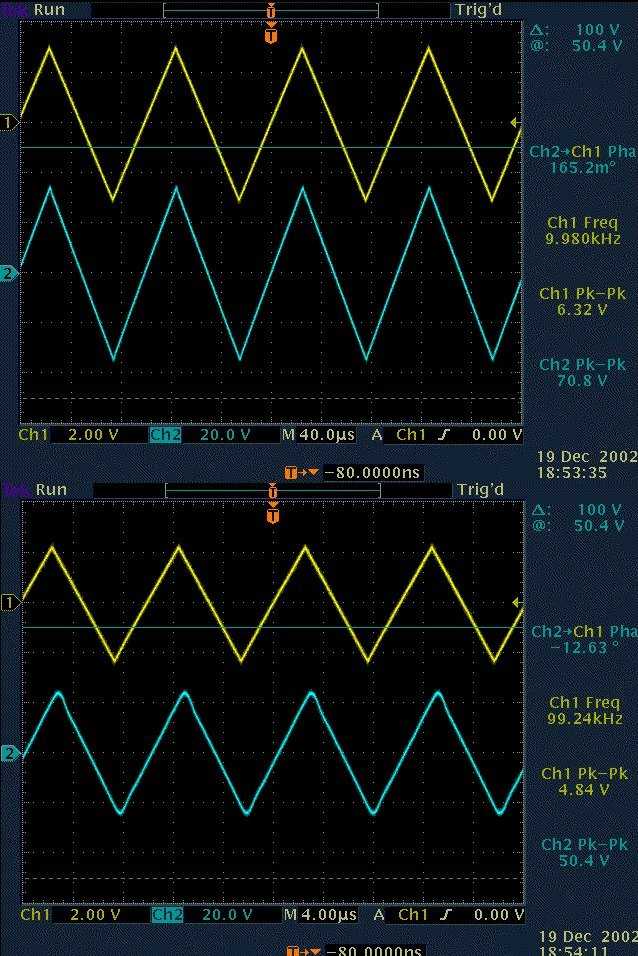

Images... ...1 of 2
Rambi said:
I'm always interested!
Cool, here are a few images. (I hope you can find that camera to snap a few to post also ) :)
The measurements are pretty self explanatory, as to frequency, phase, and gain (can be calculated from peak to peak) Blue trace is output signal into 8 ohm 100W non inductive resistor. Yellow trace is input into amplifier.
I was going to grab a few more, but I left it run at high power a little too long... ...POP! SNAP! followed by orange flame from the fets, and lots of magic smoke. So, until I rebuild (In about an hour) you'll have to settle for the 100Khz and single 10Khz traces...
Also, the amp was running at +- 50 Volt rails, +- 70 volts seems to improve linearity at high frequencies.
-Dan
(EDIT Typos!)
