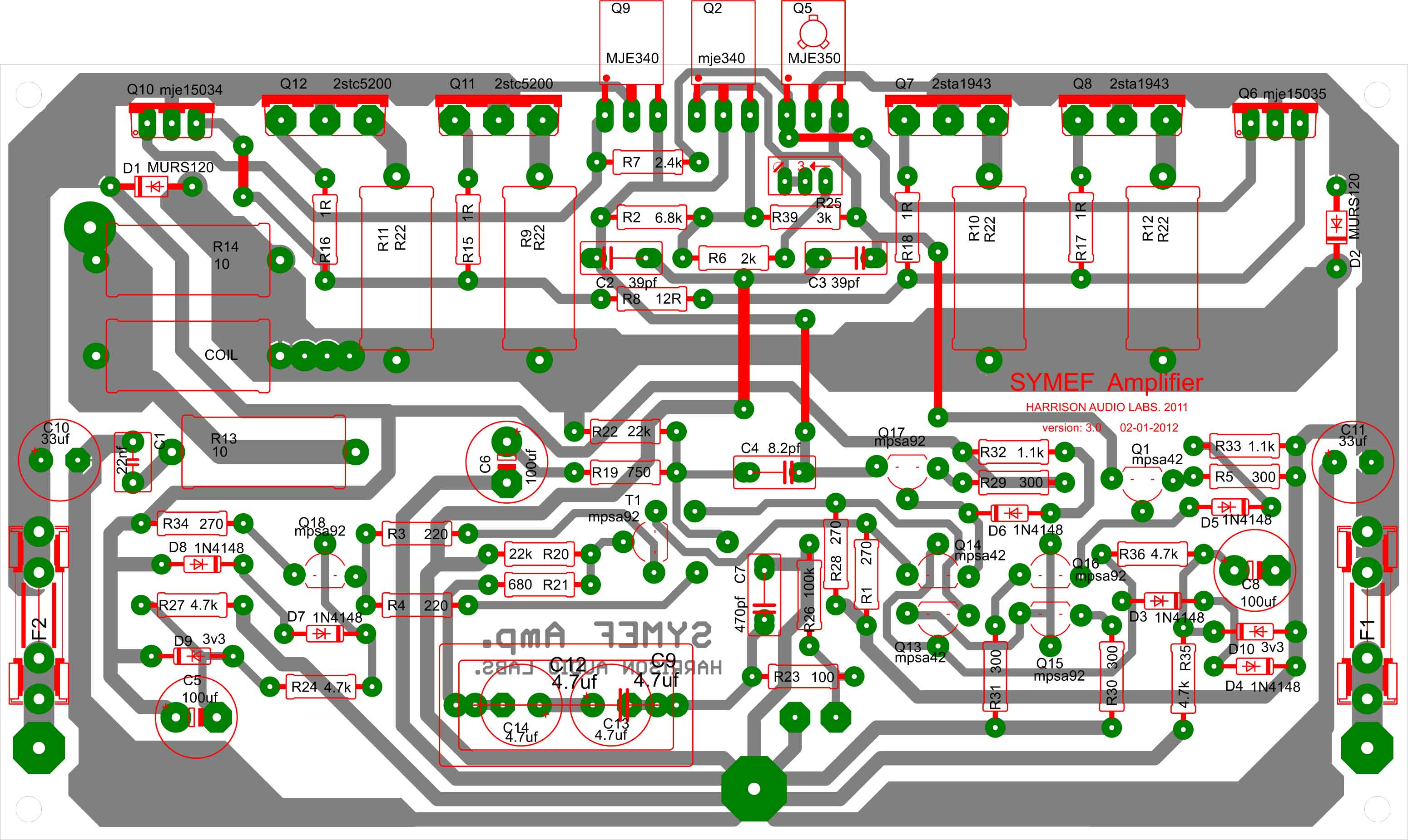

pcb for SYMEF using mpsa92
here is the pcb for SYMEF.dc offset lowest is 3.9mv. and used as output transistor is 2sc5359 and 2sa1987.
turn trimmer clockwise to set idle current at minimum.and do not operate the amplifier using single pair output transistor.
r27 and r35 should be 1 watt using a supply of 50volts.enjoy
idle current is set to 46mv across two emitter resistor

reasons....
why I said this its because my first attemp it blew the power transistor and one resistor because I forgot to set the trimmer at minimum and use only one pair of transistor.And bought that at a very low price and for sure it is fake.As you can see in his thread I'm still waiting for the delivery of transistor from a reputable supplier.
And my second attemp as you can see in the picture I have used a sanken transistor again it is only one pair and that time I have measured the idle current it was more than 600mv.and was able to adjust the idle current to about 46mv.(Now I know that sanken transistor is very rugged.
)And able to listen at this amp.
In Harisson schematic it was designed to operate at 40v but my supply is 52 volts dc.Surely that high supply it needs two pairs of power transistors.Two pairs of power transistors even you committed the same mistake I made, I'm sure It will have a chance of 100% of survivability.

sorry...
I have noticed that in picture one of the differential transistor is missing.its because it was designed to mount at the bottom of pcb which it should not be.And the pin configuration is wrong.this happens when I mirrored copy the other transistor.
In this post I have corrected the layout.
joel
p.s.
The pcb layout I have used is designed for bc556 but used bc557 which increased the dc offset.(bc556 is not available at my supplier)I end up using mpsa92 as my differential transistor but thermal coupling is impossible because they are facing in opposite.
I have change the layout of the differential transistor designed for mpsa92 so tying it is now possible.

yes you are right...
but during that time im using bc557 in my last thread Harrison said that his glad I debugged that high dc offset.using mpsa92 check theres a reading 4.4mv and check the facing of differential transistor.
I have included the picture of 36mv but thats previous just to show the measurement of the amplifier.
about the vr before I installed it I have set it in middle I think 500ohms.thats why Im confident.you know I do really like the way harisson design this. It takes how many turns to lower the idle current which is very good when amp.is configured in complementary feedback.but it is emitter follOwer and very easy to attain 46mv.

Drow,
you are impossible.
the DX Threads show pics of a simple way to Thermally couple a pair of LTP To92.
You blew up your output stage because you did not use a bulb tester, not because you made a mistake in understanding what way to turn a VR.

If I had assembled the amp.and my only mistake is that the pot is set at maximum and the bulb is connected the amp.will this bulb tells me that the amp has a problem?
regards,
joel
Yes, you can save your amp.
Through my experiance, I connect incandescent bulb (60W) in series to both +/- rail input. When first power up the bulb never lights up or glows slighty. BUT when the glow starts increasing, I quickly turn of the power. During this period, the bulb is resisting high power supply and amperage to the amp.
I will disconnect and check for faults.
