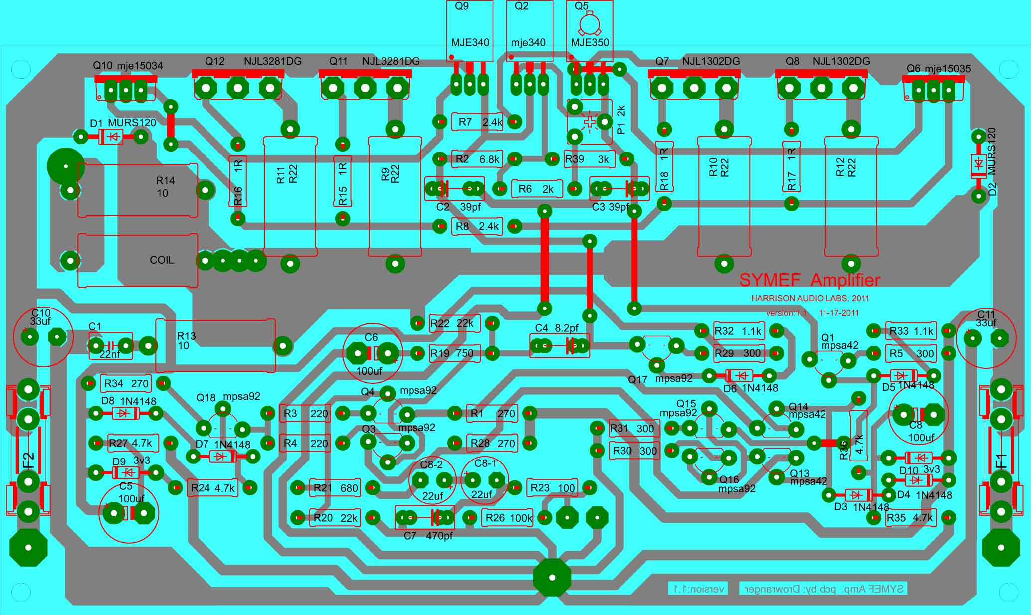

your coupling capacitor seems very large 100uf.i have search on internet seems all plastic casing and polyester type very bulky 43mm x 24mm.silver mica if there is will be very expensive.can i use two tantalum capacitor in series like sloans technique.I'm preparing the board and listing for what parts i will use.

You could even scale C8 from 100uf to 10uf. C6 from 2200uf to 100uf . The Slone technique is also fine by me. Nice progress :)

c8 and c6 change value

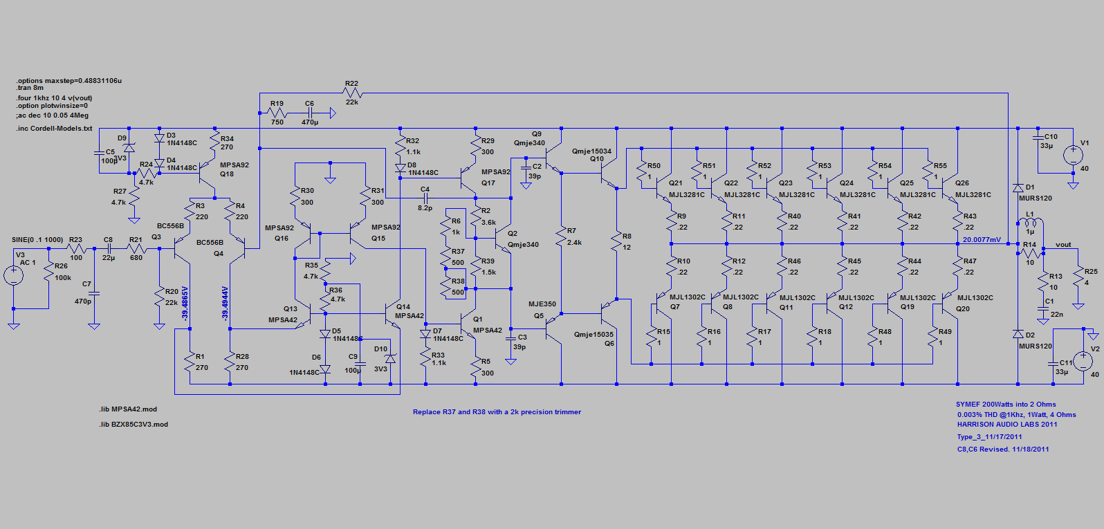

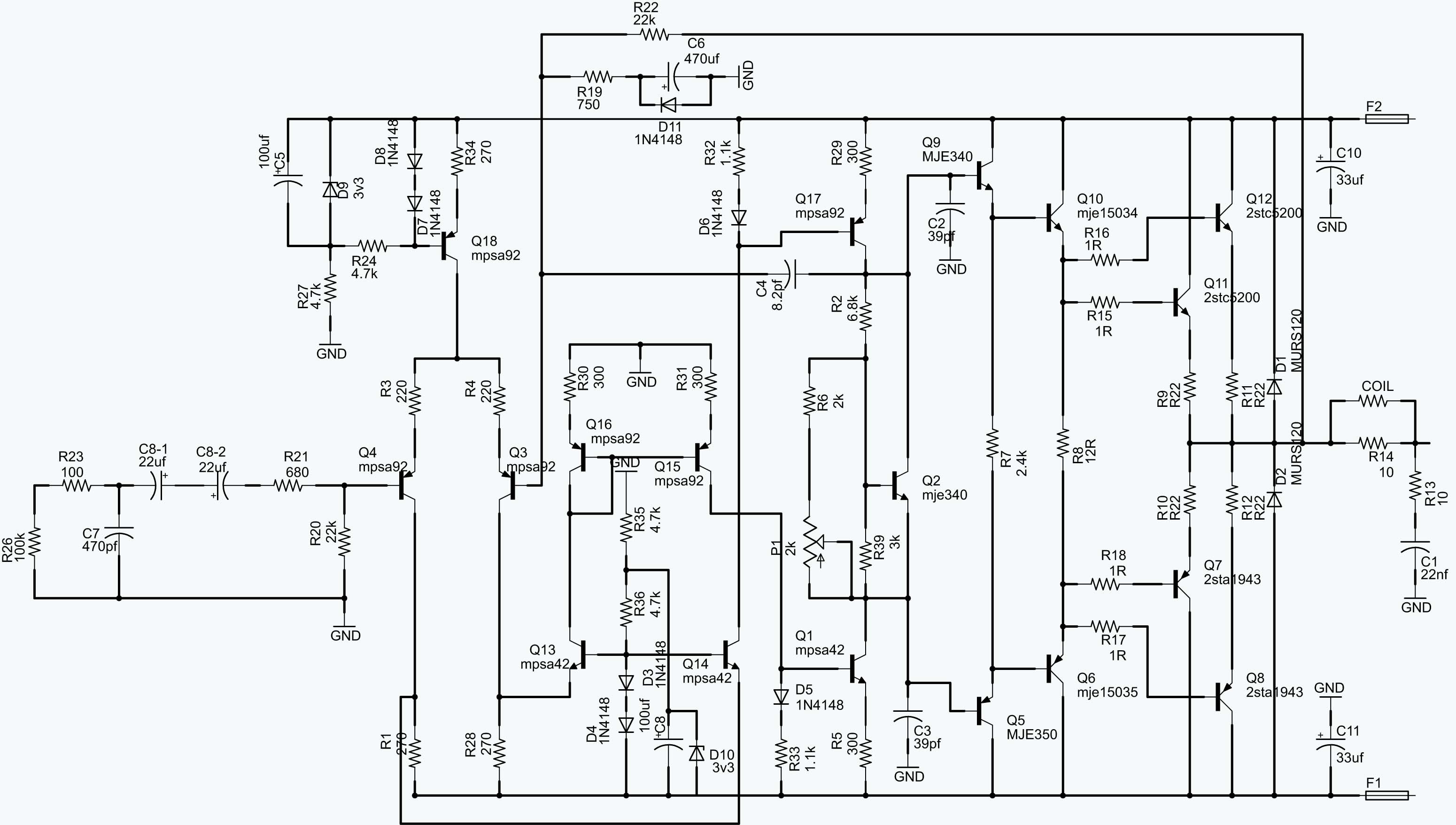

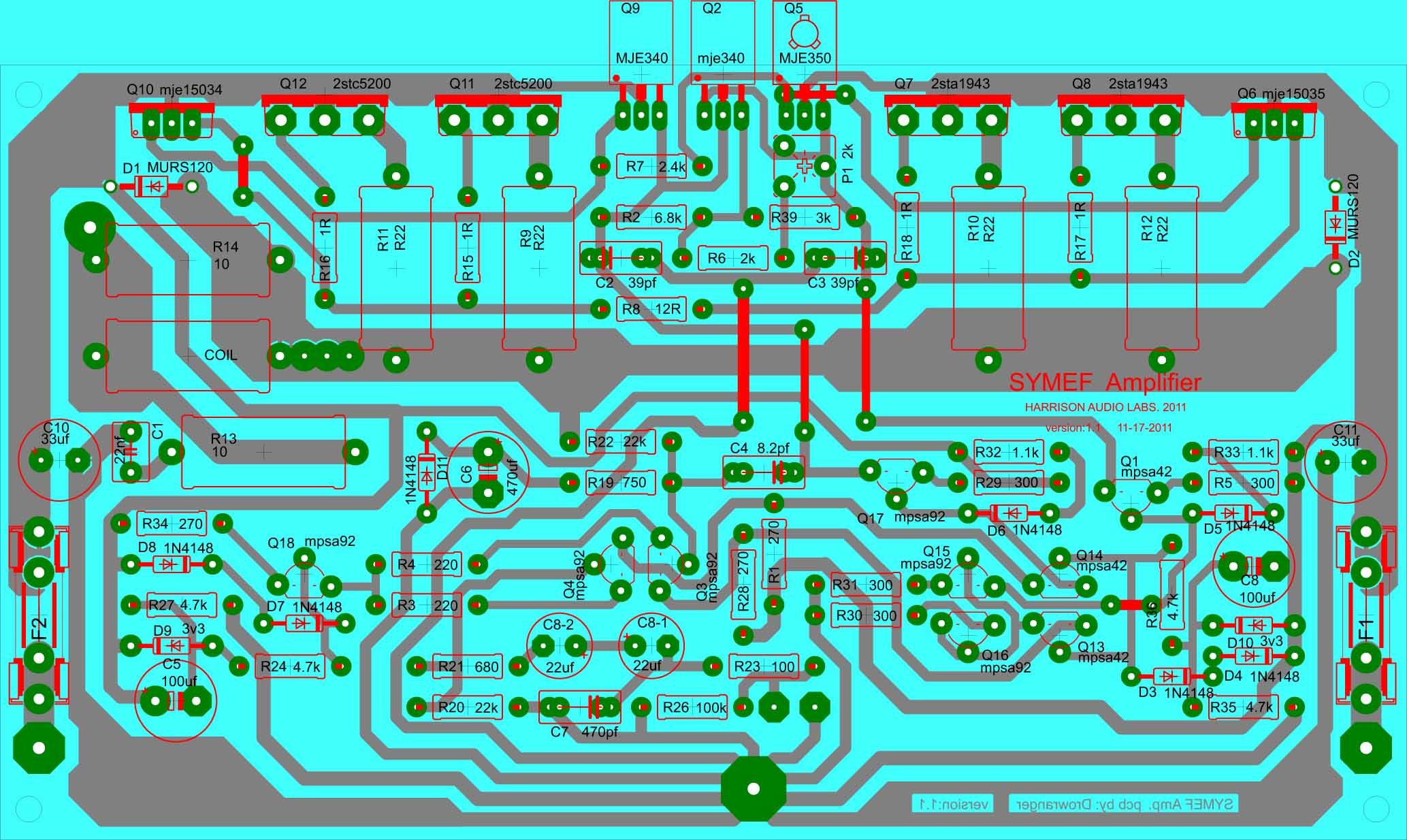

also the coil and output transistor location.onaudio pls check my work for possible mistakes specially my schematic.I got confused on your capacitor has no polarity should be electrolytic cap.
cheers,
joel
Hi Joel,
I took a quick peek ;) . R8 should be 12 Ohms. Relocate R13 and C1 to speaker side. C6 could be replaced with two 220 uF or you can use a protection diode. Or go non polar with film types :).

change r7 2.4k to 12r
Hi Joel,

i have check sloan schematic you mean a 1n4146 in parallel with c6.and the zobel after the coil.ill get in touch with you saturday we have no work on friday and no internet in my room.thanks for checking ill change it tonight when i get back in my room.going home.:)

Hi Joel,
R8 on your schematic not R7. Nice speakers. Use ceramic for high frequency feedback. I see you have used a polarized symbol for all capacitors ?

check again
Hi Joel,
Just to point out ;) the output devices your using have tracking diodes, will you take advantage of them ?
kind regards
the transistor you used not available and change it to 2stc5200 and 2sta1943 is this two ok?sorry for using the wrong output transistor.I already change c8,c6,r8 and zobel network.plus I include a diode in parallel with c6.is this correct?

p.s. if no correction will be made I will try to buy pcb this week and will use toner transfer method.my printer is laser and produce solid black good for transferring.

4.7uf
Drow,
replace back to back C8 with a single plastic film 4u7F.
You lose one octave of sub audio low bass frequency response in exchange for the higher quality film over electrolytic caps.
I have check the supplier the smallest casing is 26mm x 13mm it takes up the space of the whole input filter circuit.capacitor is metallised polypropylene is there any other way for this?
p.s. can i use metallised polyester or uncoated MKTpolyester capacitor and rating is 63volts?
