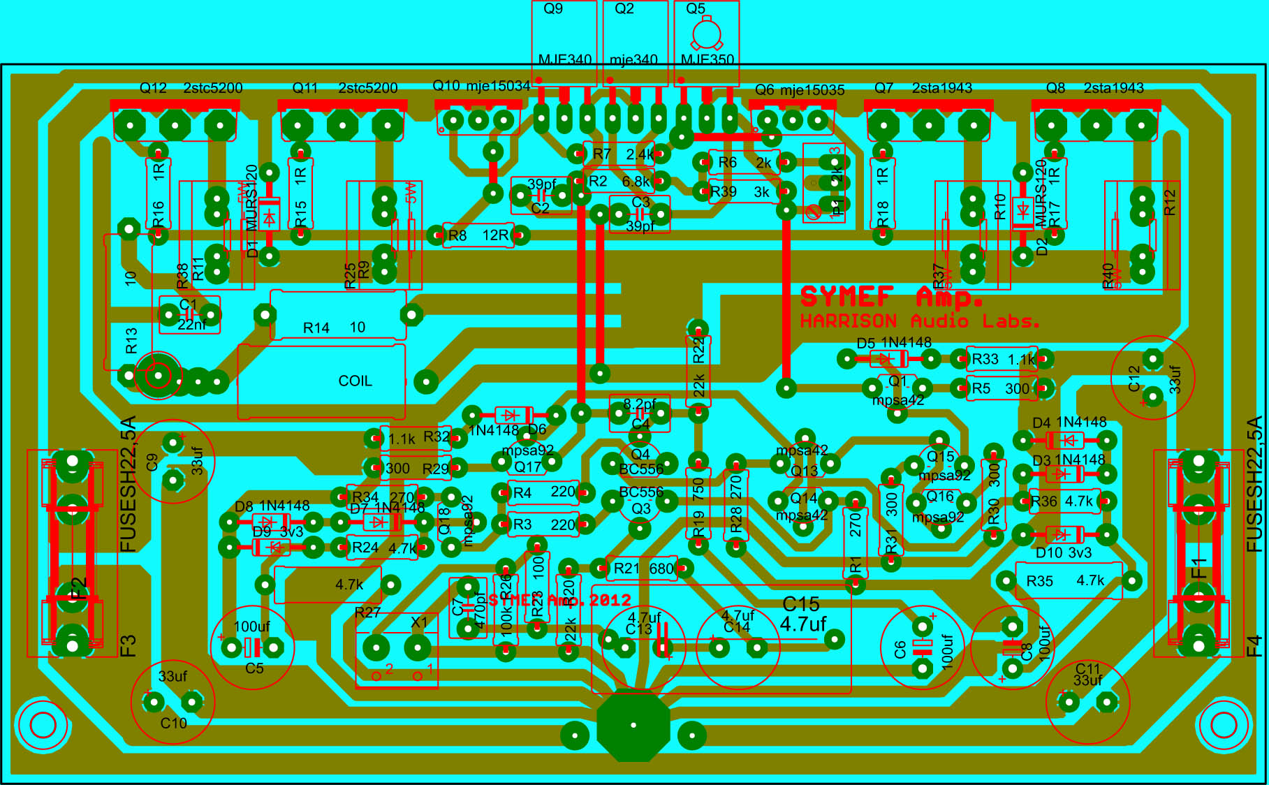

as you can see vas are much closer to supply rail and and pre driver, plus separate ground returns and additonal capacitor at vas for much better psrr.
but then again this amp.has a good psrr even without this modification it will still sound very very good in my case.
we have included groundings on all side and in the middle so the amp. will not act as an antenna.
supply lines infront so you can twist the wiring and a star gnd directly connected to chassis via copper tube spacer.
all this credit goes to Harrison for his amazing amp.Happy to be part with this

Purpose of 2 additional electrolytics as decoupling is used for vas stage and the input stage.to provide better psrr and as you can see they have separate ground returns.if you still want to put it used ceramics much cheaper and effective.

Ceramics ind audio, isn't that an heresy?put it used ceramics much cheaper and effective.
The idea behind this is that high frequencies take the film cap path - better quality than any electrolytic -, and the bass doesn't mind the electrolytic. Some people always bypass electrolytics others say it can give rise to nasty ressonances.
For instance, in the power supply do you use to put a film cap after the reservoir electrolytics? I used to do it but now I'm not sure anymore.
