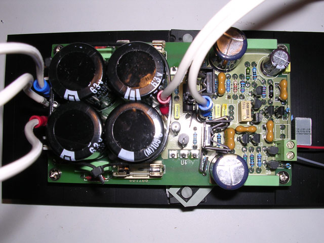

Hi all,
Fist board is playing !
45V/rails (2X 30V transfo 240V at home).
I used a little cd player with headphone output and it was a problem with trebble .. saturation ???
After i tried with a préamp and it was better but still a little saturation whith cds recorded at high level..
Now its running a few ours and its better...but...
I use a 10pf at C14, maybe the raison ?
There is some hum, too. javascript:smilie('')
My original symasym (first DIY project) was dead silent.
Bias: set at 25mv across r27 and r28. Is this correct ?
Newbie question: how can i mesure the Offset, i only have a DDM.
Here is a pic, maybe you can find a mistake ?
Thanks for this nice project ?
Perhaps i can build the second board with 5pf and compare ?
